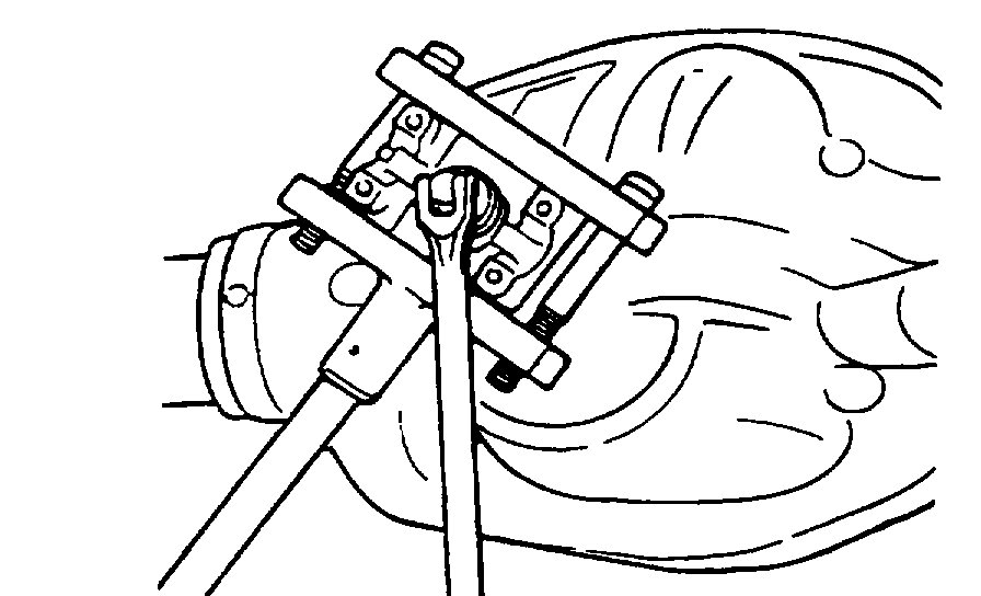

I replaced the rear outer pinion bearing and seal because the seal had gone bad a started leaking fluid. I replaced the bearing and seal filled the differential with fluid drove it for a quarter mile and the differential started making a loud humming noise every time I let go of the throttle. I parked the truck went underneath and saw it was leaking again.

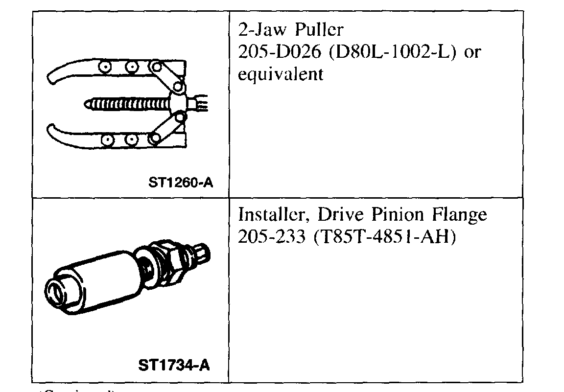

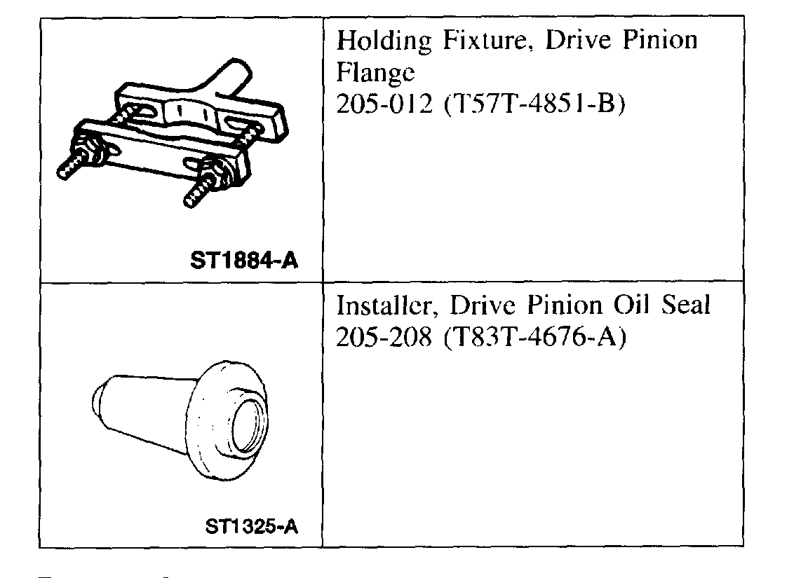

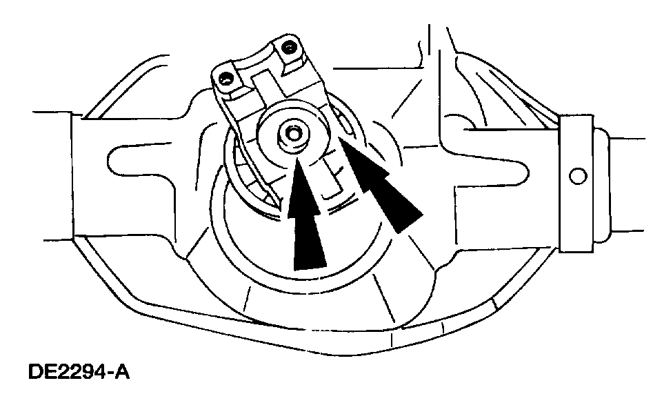

When you reinstalled the pinion flange, how was torque determined? You had to know the preload prior to taking it apart. Then, when torquing the pinion flange nut, it gets tightened until you reach that preload that was determine prior to removal. Take a look at these directions. They explain how it's done.
Note: This is for a Ford 10.5" Differential. There is an optional Dana 80, so let me know if you have it.
2003 Ford Truck F 250 4WD Super Duty V8-6.0L DSL Turbo
Drive Pinion Flange and Drive Pinion
Vehicle Transmission and Drivetrain Differential Assembly Pinion Flange Service and Repair Procedures Ford 10.50 Inch Rear Axle Drive Pinion Flange and Drive Pinion

Special Tool(s)

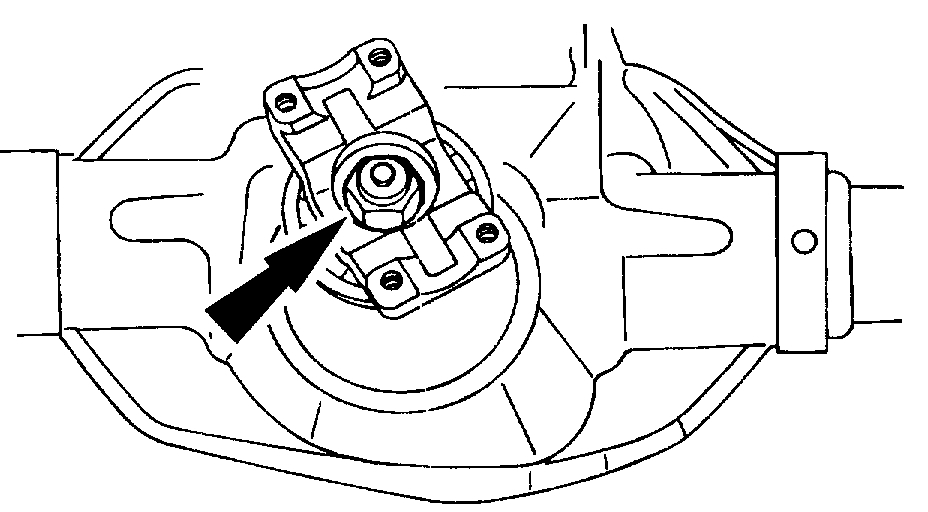

2. Remove the driveshaft.

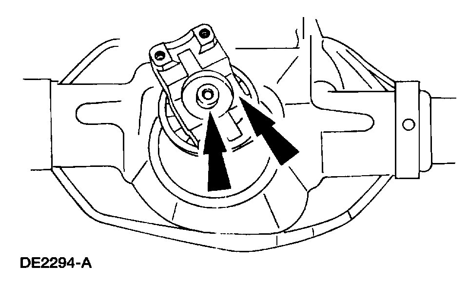

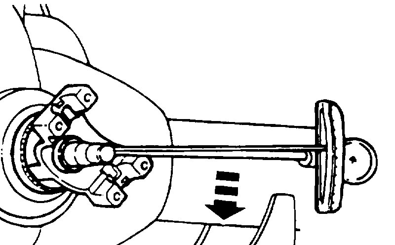

3. Install a Nm (inch-pound) torque wrench on the pinion nut, and record the rotational torque required to maintain rotation of the pinion through several revolutions.
pic 4

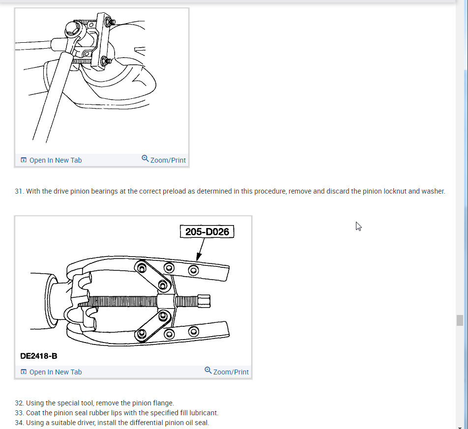

4. CAUTION: After removal of the pinion nut, discard it. A new nut must be used for installation.
Use the Flange Holder to hold the pinion flange while removing the pinion nut.
pic 5

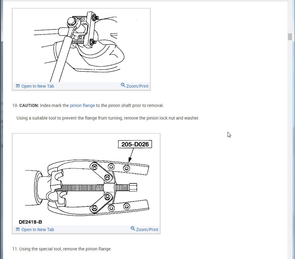

5. Mark the pinion flange in relation to the drive pinion stem to ensure proper alignment during installation.
pic 6

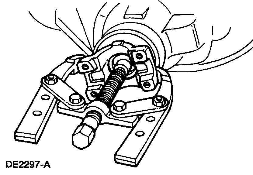

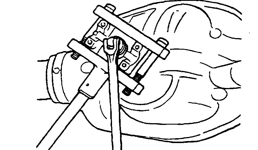

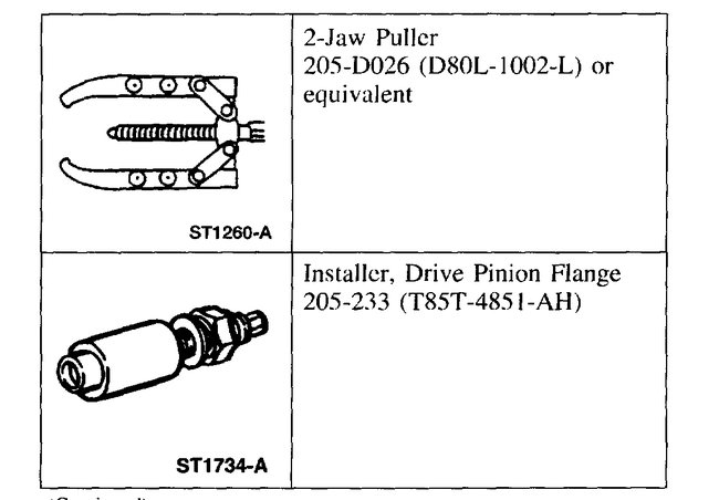

6. Use the 2-Jaw Puller to remove the pinion flange.
pic 7

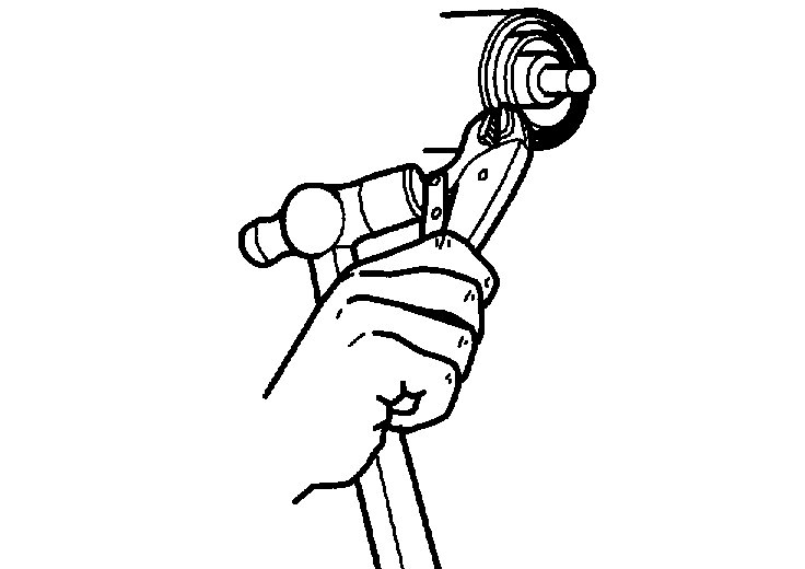

7. Force up on the metal flange of the rear axle drive pinion seal. Install gripping pliers to the seal flange and strike with a hammer until the rear axle drive pinion seal is removed.

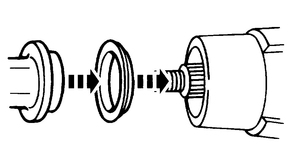

1. Lubricate the new pinion seal.
^ Use Premium Long-Life Grease XG-1-C or equivalent meeting Ford specification ESA-M1C75-B.
pic 8
2. CAUTION: If the rear axle drive pinion seal becomes misaligned during installation, remove the rear axle drive pinion seal and replace it with a new seal.
Use the Pinion Seal Replacer to install the rear axle drive pinion seal.

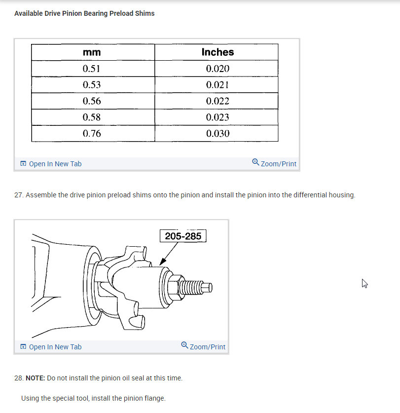

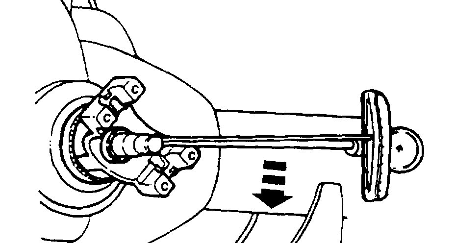

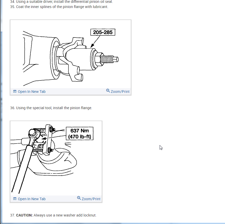

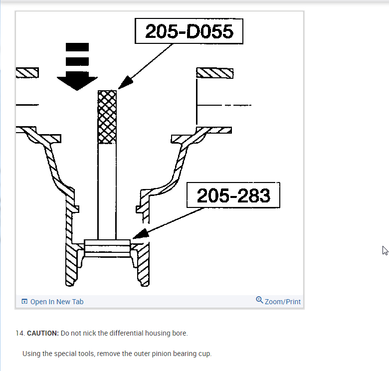

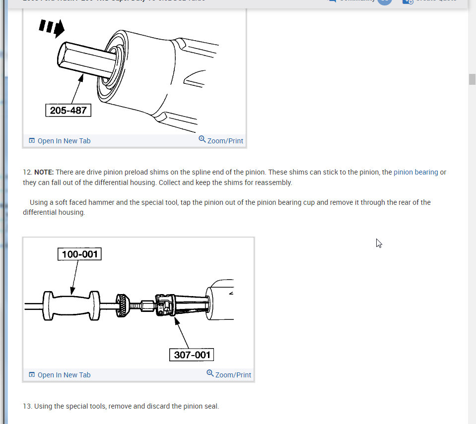

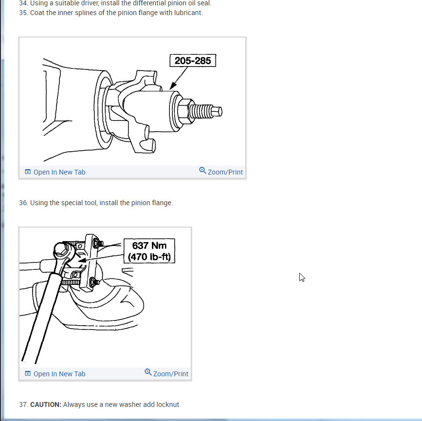

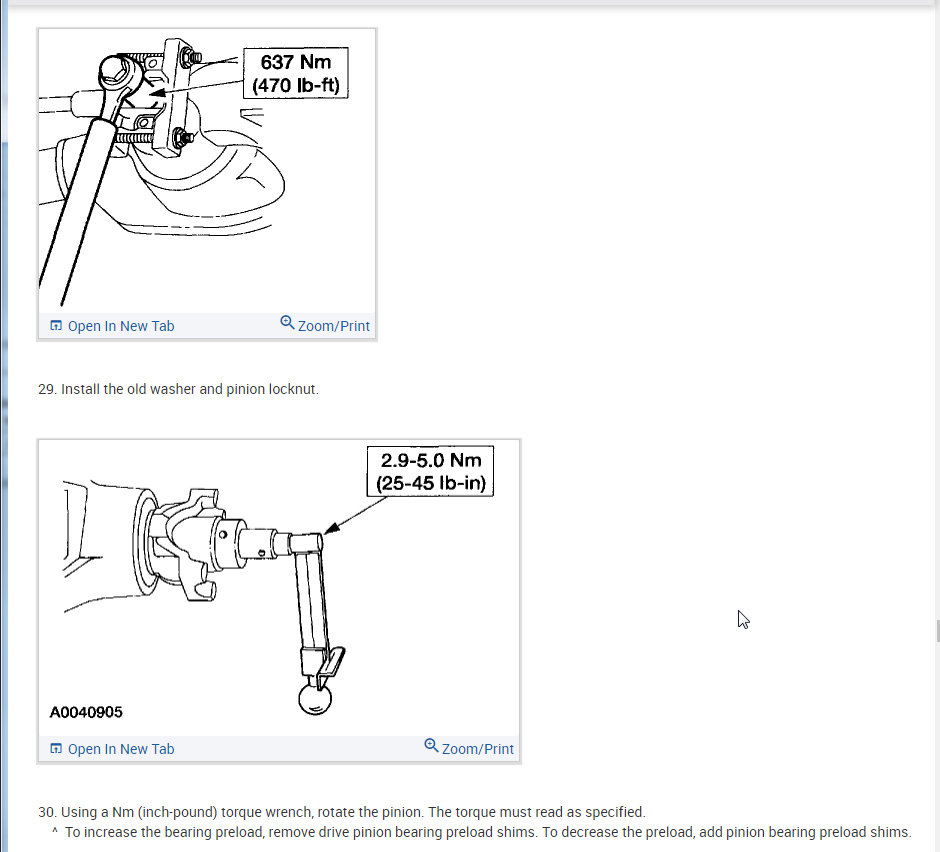

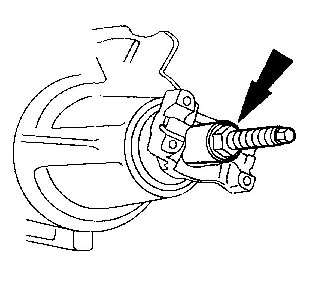

So when you let off the throttle and it is making noise that is most always the pinion making noise on the ring gear.
So when you installed the pinion nut did you reinstall the proper shim and torque the nut properly? You need to torque it to 470 lbs ft (assuming you have the Dana 80 which is the most common). Then you need to measure turning torque to make sure the preload is correct.
I attached the process below to perform this. Let me know what questions you have.
