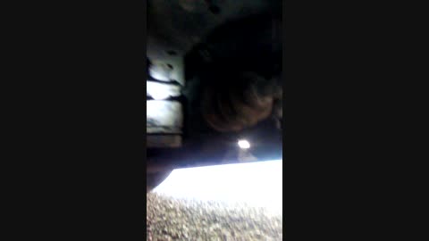

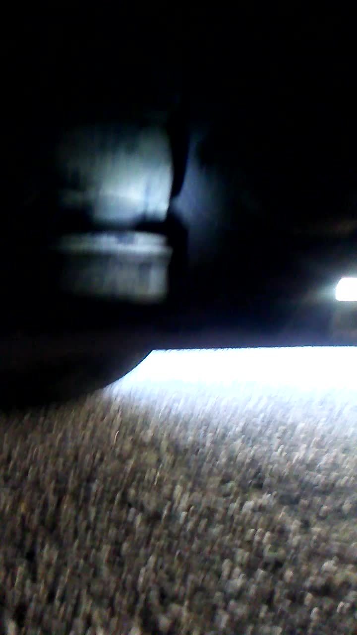

SHANNON SANCHEZ
Here is my video.

DANNY L
  • 5,648 POSTS
Hello again.
Sorry I just replied before seeing your video! It looks like you have a damaged/missing rear differential bushing. That is a bushing used to mount the differential to the frame/attaching point. You can clearly see the "clunk" when shifting the transmission into gear. I will look up a diagram for the related components and get back to you. So glad you could send the video, makes it a lot easier!
Danny-

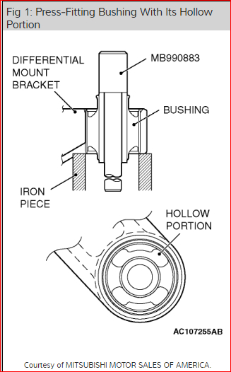

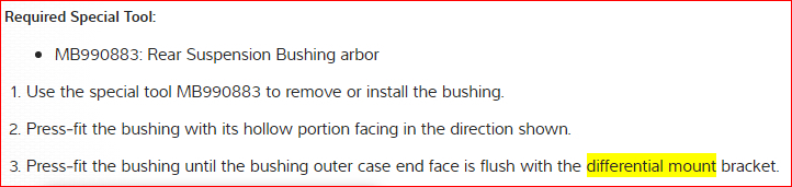

DANNY L
  • 5,648 POSTS
Hello again.
Here is a picture of the differential mount bushing your vehicle is requiring. Apparently it uses a special installation tool to press the new bushing into the differential mounting point. Any local shop would be able to do this repair. I would recommend having this repair done as soon as possible to prevent any further damage especially to the drive axles. Hope this helps and feel free to contact if any other questions come up.
