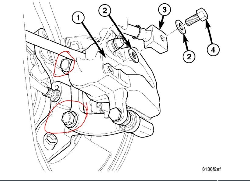

Driver side rear differential out put. Sounds like metal on metal rusty squeaking usually notice when slowly Turing left under 20 mph.
Will try to include a video it's jacked up and just turning the tire back and forth.
Does not sound like it's coming from the inside of differential. But just on the out side.

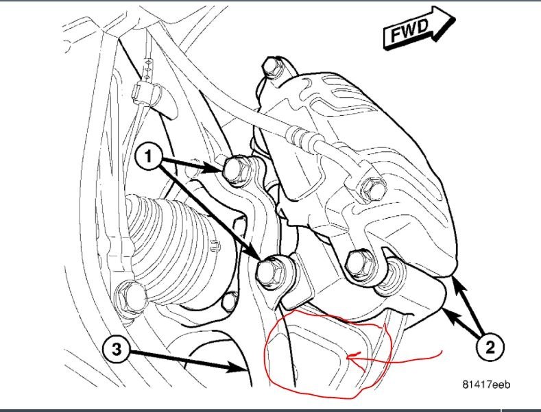

Hey thank you so much. I did find that my emergency brake shoe has broken and the thin pad came unattached from the shoe. I was able to break apart the pad and remove it from inside the rotor. What is your best solution on removing the caliper bracket bolts? They are so rusted. If I try to use heat do I heat the bolt or the part that the bolt is screwed in to?
Oct 28, 2020 at 8:21 AM
The part the bolt is bolted at.
https://www.2carpros.com/articles/how-to-replace-rear-brake-pads-and-rotors
https://www.2carpros.com/articles/parking-brake-shoe-replacement
Just heat it up for a couple of minutes. Then use a socket and ratchet to release it.
