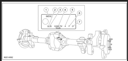

What type of differential I need to replace the differential
1997 FORD F-150
180,000 MILES • 4.6L • 6 CYL • 4WD • AUTOMATIC
JUAN SORIA

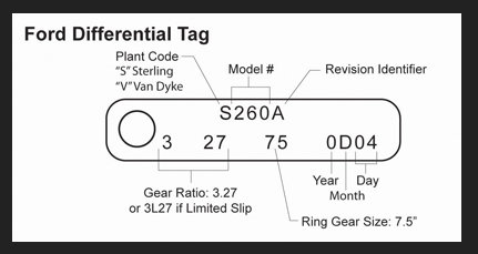

What type of differential i need to replace the differential of my truck? Also, where can i check what differential are compatible with my truck?
Oct 16, 2020 at 7:05 PM

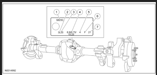

This is dependent on what gears you have in this truck. There are a number of different options so we need to start with looking at the tags (hopefully they are still there). I attached the diagrams of what they look like. Let us know what they are or just get a picture of them and we can go from there. Thanks
