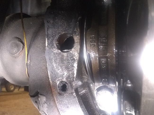

I replaced ring and pinion,set it up with no gauges,pinion and gear teeth ride pattern in almost dead center. is it okay to torque everything to specs and test drive? Am disabled on fixed income,so can't afford to pay a shop to do the work and is my only vehicle.
Dec 29, 2019 at 11:03 AM
  • 110,244 POSTS
As long as preload is set and the ring and pinion gears are within spec for clearance, you should be okay.
I'm not sure which differential you have, 8.6" 9.5" or 10.5". Let me know which you have and if it is posi-traction.
Dec 29, 2019 at 2:12 PM
LOCOFEAR
  • 6 POSTS
I have 8.6, limited slip.
Dec 29, 2019 at 8:53 PM
LOCOFEAR
  • 6 POSTS
This is image of shims that somehow backed out around housing brackets,pinion tooth chipped. No bolts were loose. But I found out the installation kit was wrong. Not sure if that could cause anything,but when I put shims back in place,ring gear mesh pattern was almost dead center.
Dec 29, 2019 at 9:00 PM
LOCOFEAR
  • 6 POSTS
4.56 gears if that will help also. Thank you
Dec 29, 2019 at 9:01 PM
  • 110,244 POSTS
Let me know if this helps. If you need anything additional, let me know. Also, the attached pictures correlate with the directions.

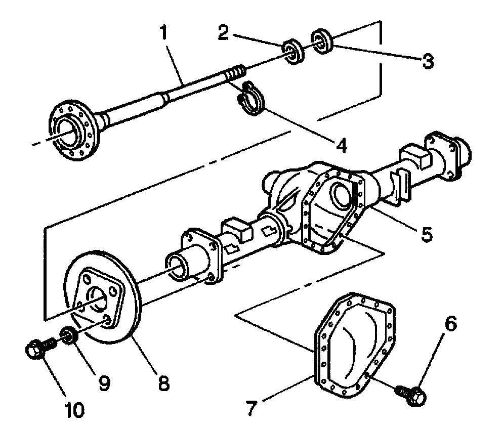

8.6, 9.5 INCH AXLE

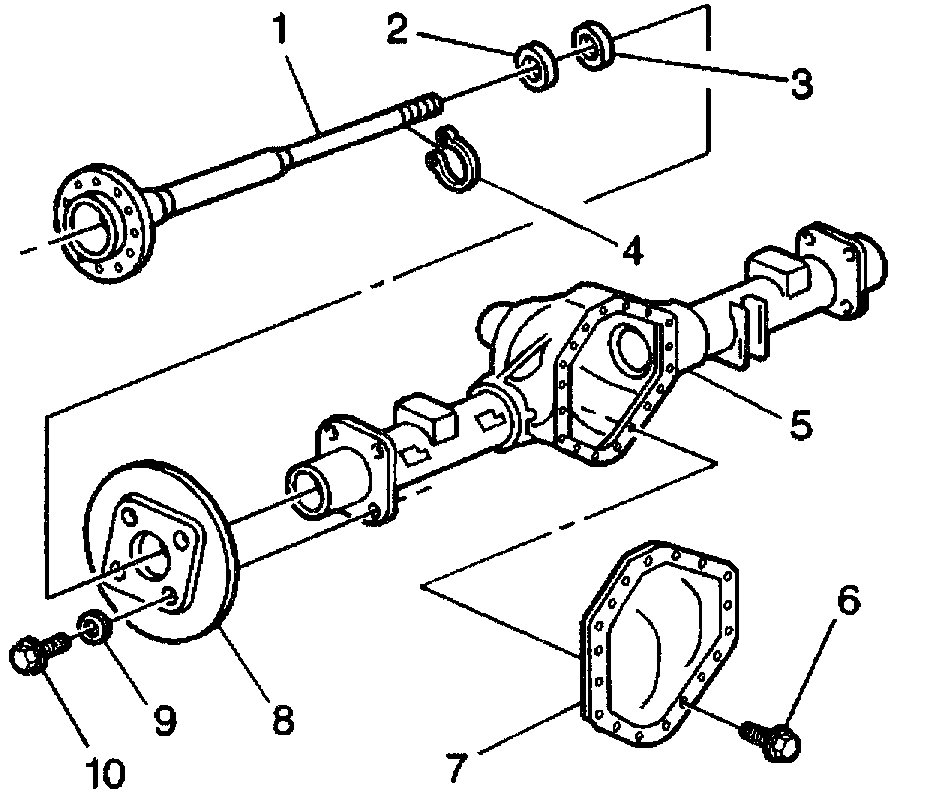

Rear Axle Shaft Replacement
Removal Procedure
pic 1
1. Raise the vehicle. Refer to Vehicle Lifting.
2. Remove the tire and wheel assembly.
3. Remove the brake caliper.
4. Remove the rear cover and the gasket.
5. Remove the pinion shaft locking bolt.

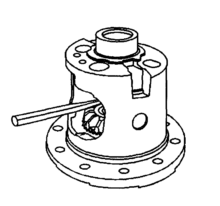

pic 2

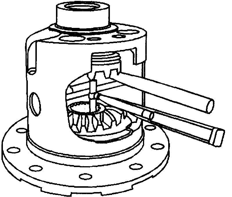

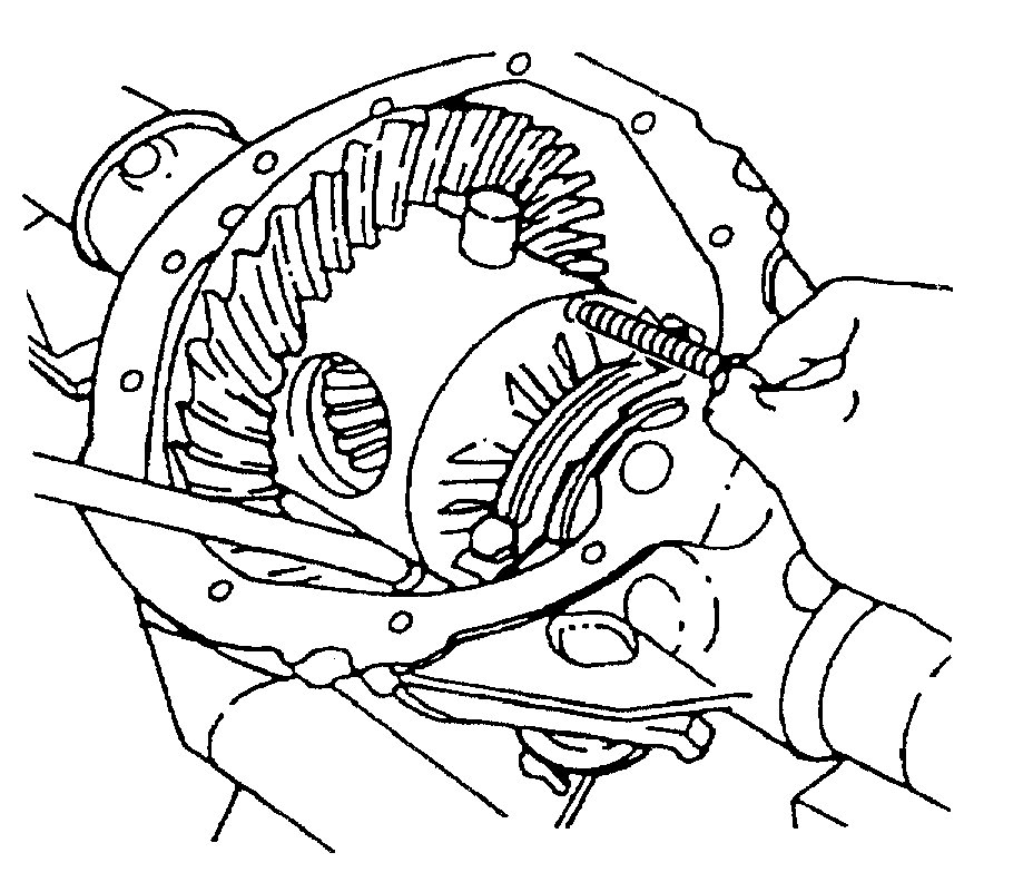

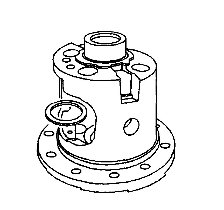

6. On axles without a locking differential, remove the pinion shaft

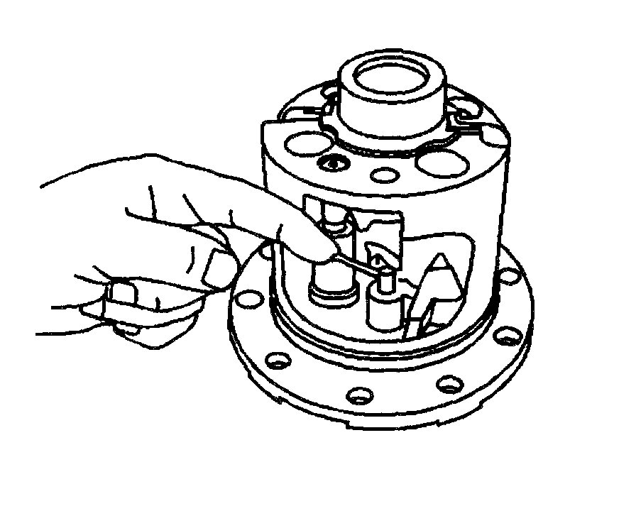

pic 3

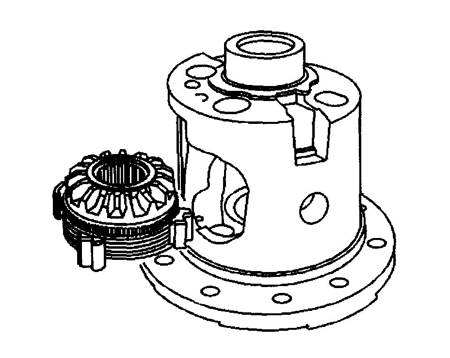

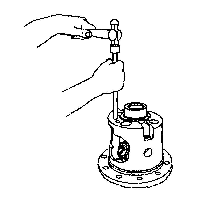

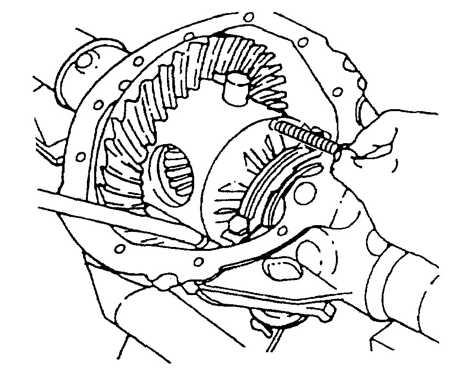

7. On axles with a locking differential, remove the shaft part way. Rotate the case until the pinion shaft touches the housing.

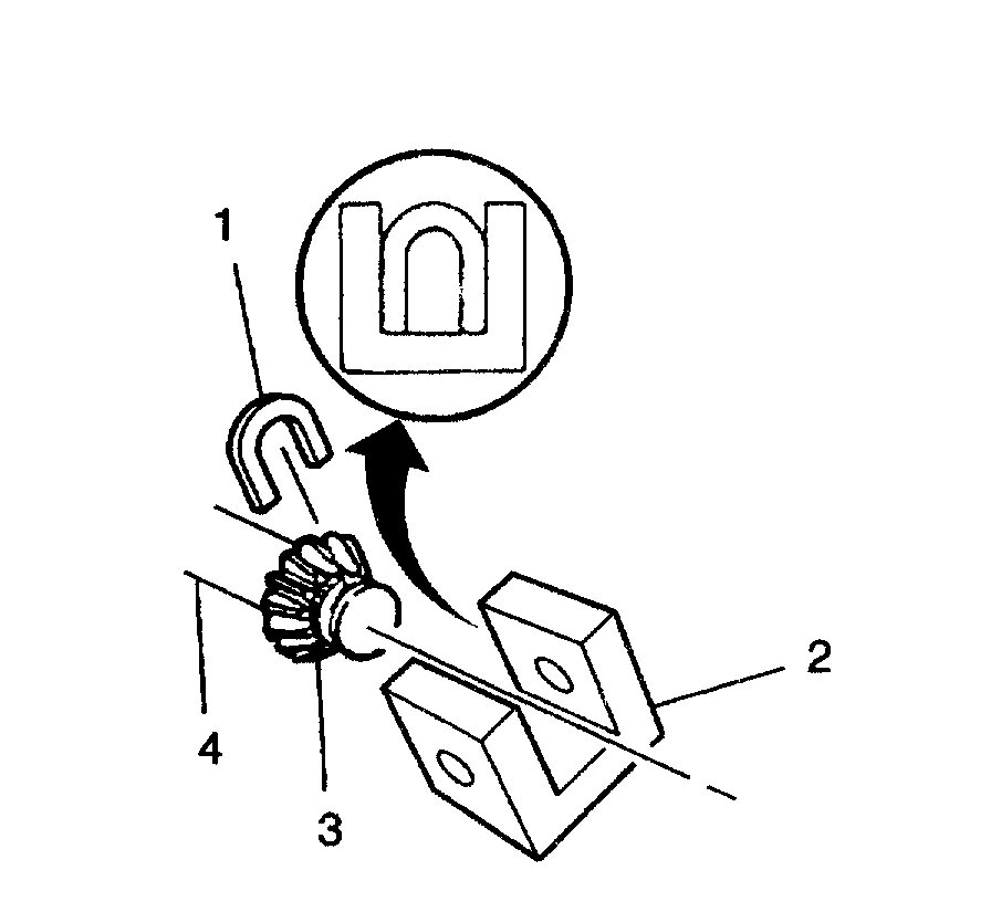

pic 4

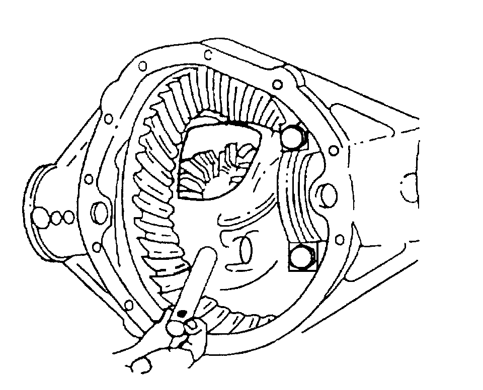

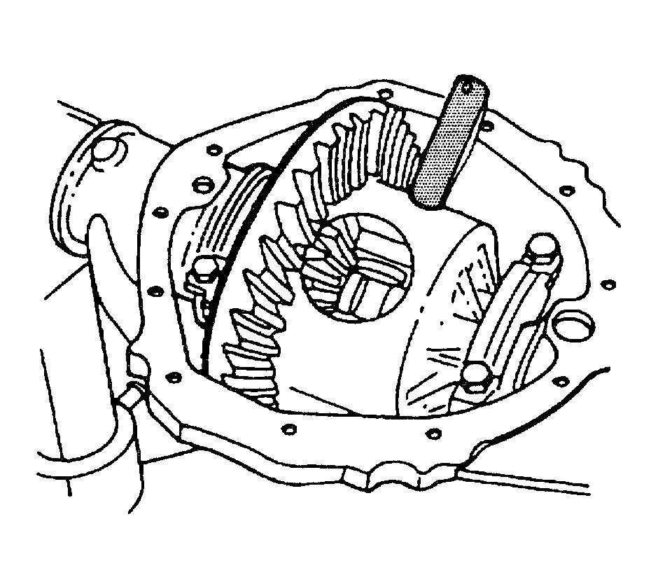

8. On axles with a locking differential, use a screwdriver, or a similar tool, in order to enter the differential case and rotate the lock (1) until the lock aligns with the thrust block (2).

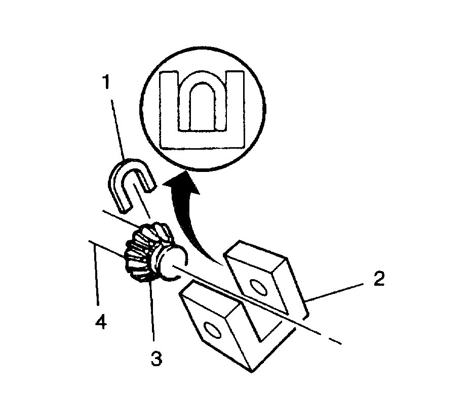

pic 5

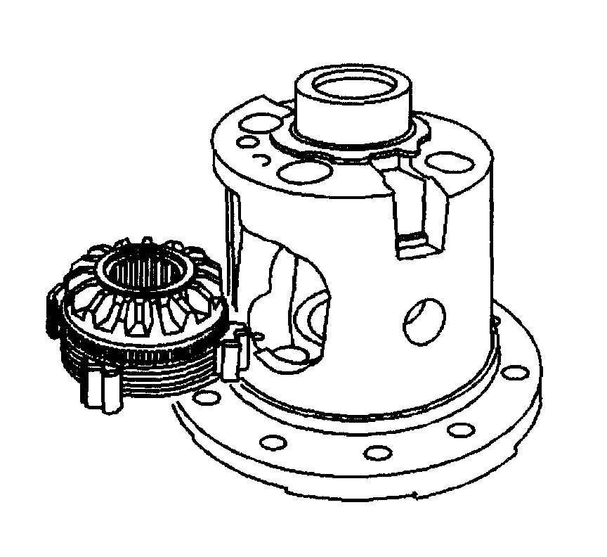

9. Push the flange of the axle shaft (1) toward the differential.
10. Remove the C-lock (4) from the button end of the axle shaft (1).
Important: When removing the axle shaft, do not rotate the shaft. Rotating the shaft will misalign the gears. Misaligning the gears will make the assembly difficult.
11. Remove the axle shaft (1) from the housing (5).
Installation Procedure

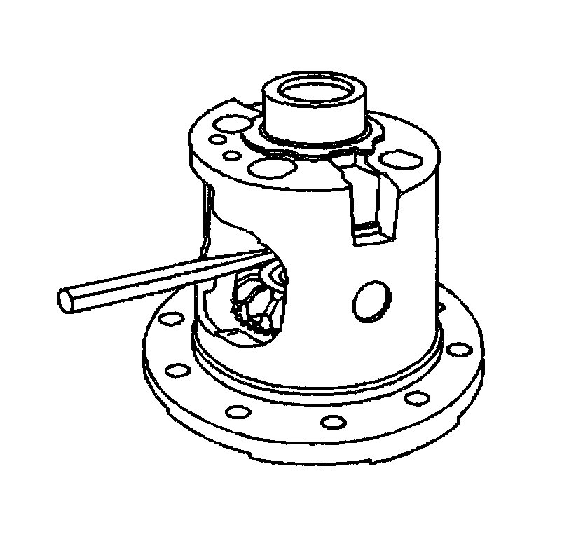

pic 6

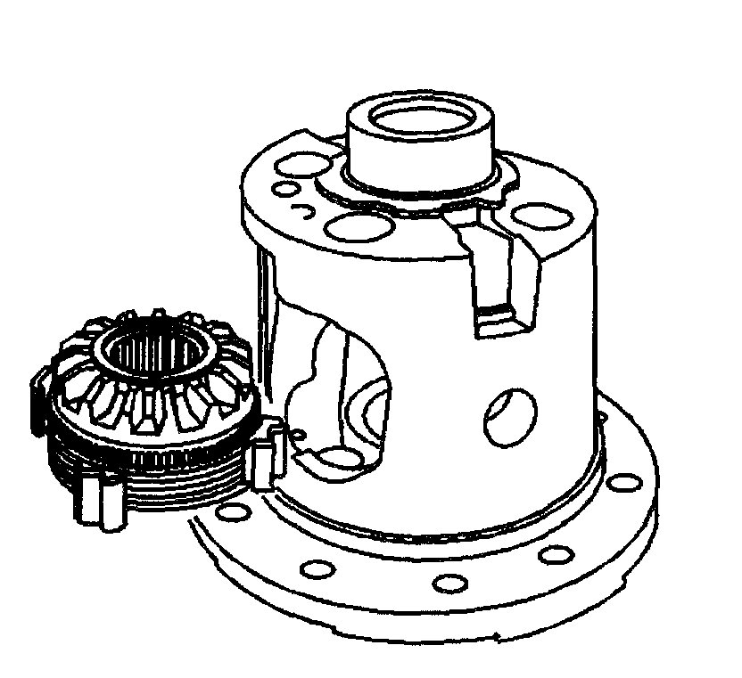

Important: Carefully insert the axle shaft in order to not damage the seal.
1. Install the axle shaft (1) into the rear axle housing (5).
2. Slide the axle shaft (1) into place allowing the splines to engage the differential side gear.
3. On axles without a locking differential, place the lock (4) on the button end of the axle shaft (1).
4. On axles with a locking differential, keep the pinion shaft partially withdrawn.
pic 7
5. On axles with a locking differential, place the C-lock (1) on the axle shaft (3) so that the ends are flush with the thrust block (2).
6. Pull the shaft flange outward in order to seat the lock in the differential gear.
pic 8
7. Align the hole in the pinion shaft with the bolt hole in the differential case.
Notice: Refer to Fastener Notice in Service Precautions.
8. Install the new pinion shaft locking bolt.
^ Tighten the pinion shaft locking bolt to 34 Nm (25 lb ft).
9. Install the rear cover and the gasket.
10. Install the brake caliper.
11. Install the tire and wheel assembly.
12. Fill the rear axle. Use the proper fluid.
13. Lower the vehicle.

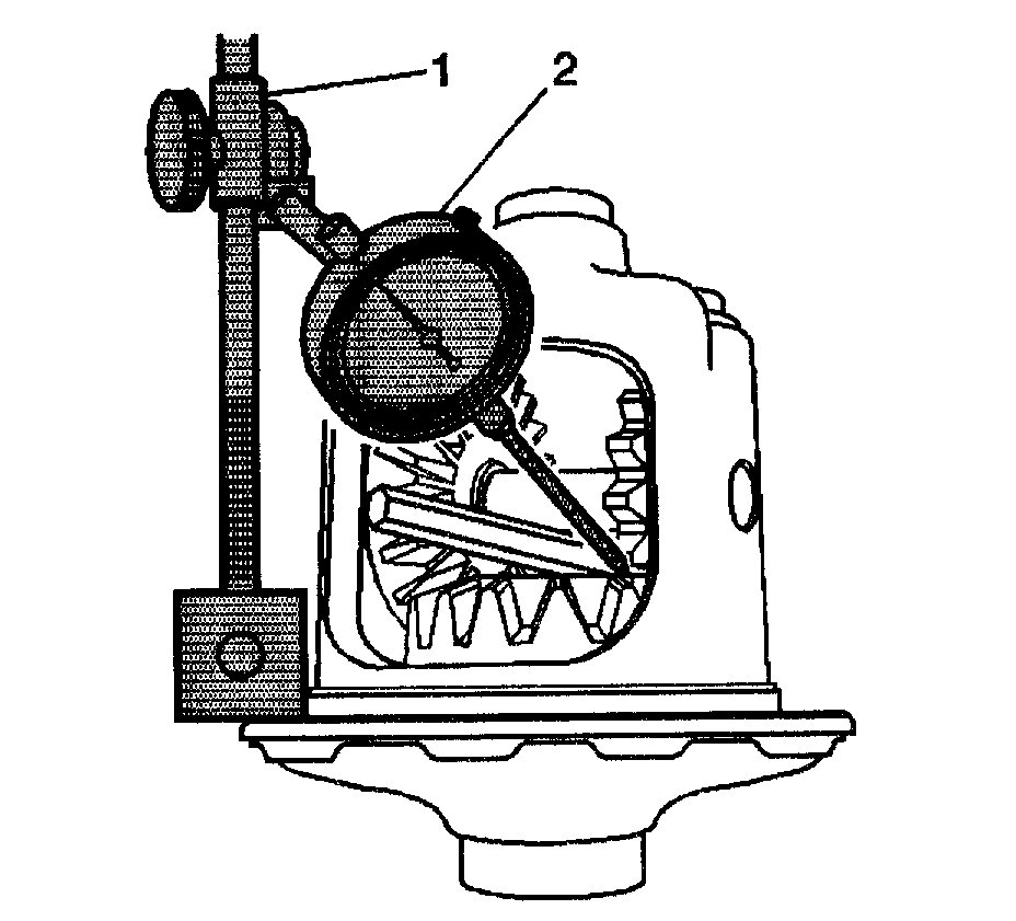

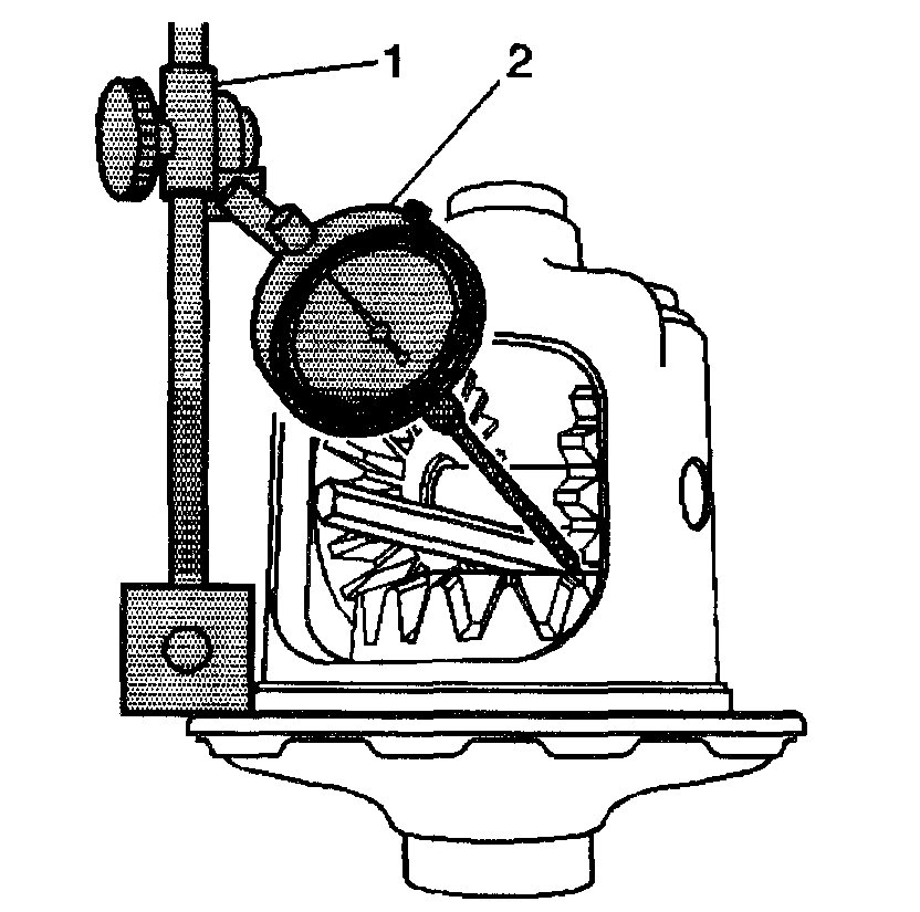

8. Measure the backlash of the pinion gear and the side gear by doing the following:
8.1. Install the J 7872 (1) to the ring gear flange.
8.2. Loosely clamp the J 8001-3 (2) onto the stem on the J 7872 (1).
8.3. Place the contact pad of the J 8001-3 on one of the teeth of the pinion gear closest to the pinion shaft lock bolt. Turn the dial of the J 8001-3 until the needle and the dial face indicate zero.
8.4. Tighten the lock nut of the J 8001-3 finger tight.
8.5. Pull the pinion gear firmly into the differential case seat.
8.6. Rotate the pinion gear back and forth.
8.7. Measure the backlash.
^ The backlash for the pinion gears should be 0.000 - 0.076 mm (0.000 - 0.003 inch).

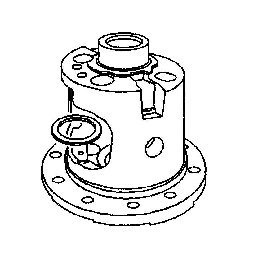

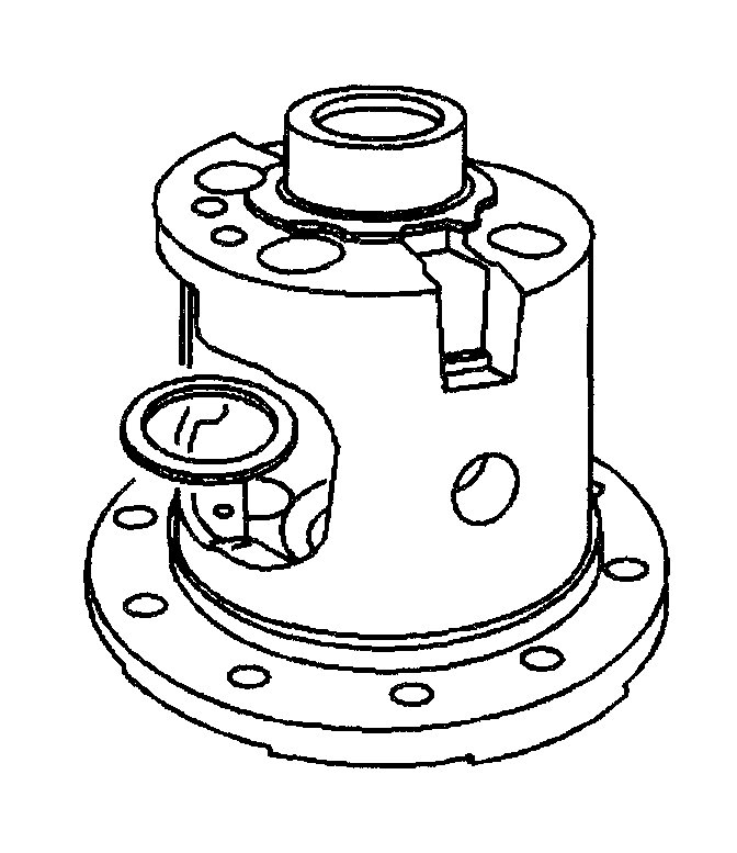

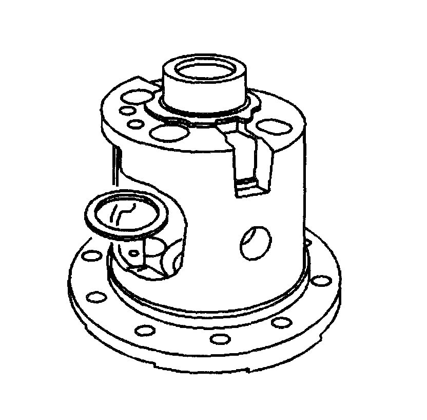

rear differential
111
Community 23 Create Quote
2002 Chevy Truck Avalanche 1500 4WD V8-5.3L VIN T
8.6, 9.5 Inch Axle
Vehicle Transmission and Drivetrain Differential Assembly Service and Repair Procedures Rear Drive Axle - Locking/Limited Slip Rear Axle Locking Differential Assemble 8.6, 9.5 Inch Axle
8.6, 9.5 INCH AXLE
Locking Differential Assemble (8.6, 9.5 Inch Axles)
pic 18
Important: The left and right side gear backlash and thrust block thickness measurement must be completed before the components of the locking differential can be assembled.
1. Install the left side gear thrust washer.
pic 19
2. Install the left side gear cam unit and clutch disc assembly.
3. Install the right side gear thrust washer.
4. Install the right side clutch pack assembly.
5. Install the right side gear.
Important: If the original pinion gears and thrust washers are being re-used, install the pinion gears and thrust washers on the same side as when removed.
6. Install the pinion gear and the pinion thrust washers.
Place the pinion gears and the pinion thrust washers 180 degrees apart.
7. Rotate the pinion gears and the pinion thrust washers 90 degrees and align the pinion gears with the pinion shaft opening in the differential case.
8. Install the thrust block.
The open side of the thrust block must face the window opening.
9. Install the pinion shaft.
10. Install the new pinion shaft lock bolt.
Tighten the pinion shaft lock bolt finger tight.
pic 20
11. Install the governor assembly.
12. Install the governor bushing using a hammer and a brass drift.
^ Press the bushing into place until there is 0.025 - 0.076 mm (0.010 - 0.030 inch) of shaft end play.
pic 21
13. Install the latching bracket assembly.
The straight end of the latching bracket spring must be over and outside the governor assembly shaft.
14. Install the latching bracket bushing using a hammer and a brass drift.
^ Press the bushing into place until there is 0.000 0.051 mm (0.000 - 0.002 inch) of shaft end play.
15. Tighten the pinion shaft lock bolt.
^ Tighten the pinion shaft lock bolt to 36 Nm (27 lb ft).
16. Install the ring gear, if necessary.
________________________________________________________
