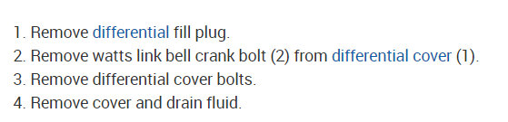

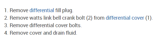

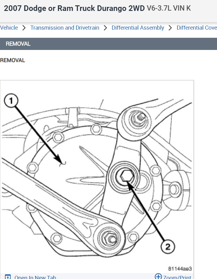

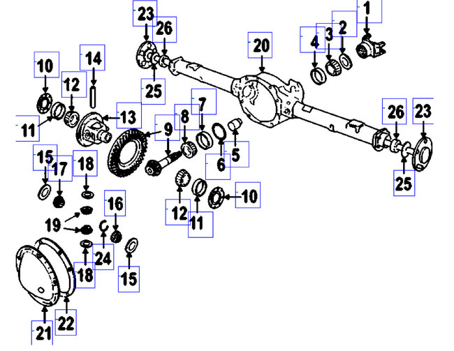

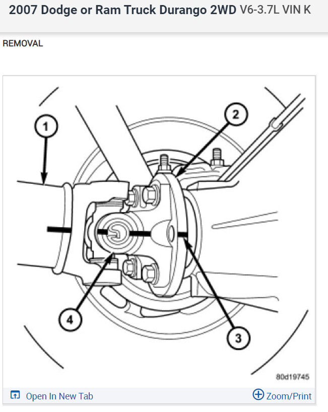

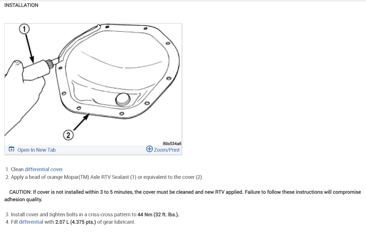

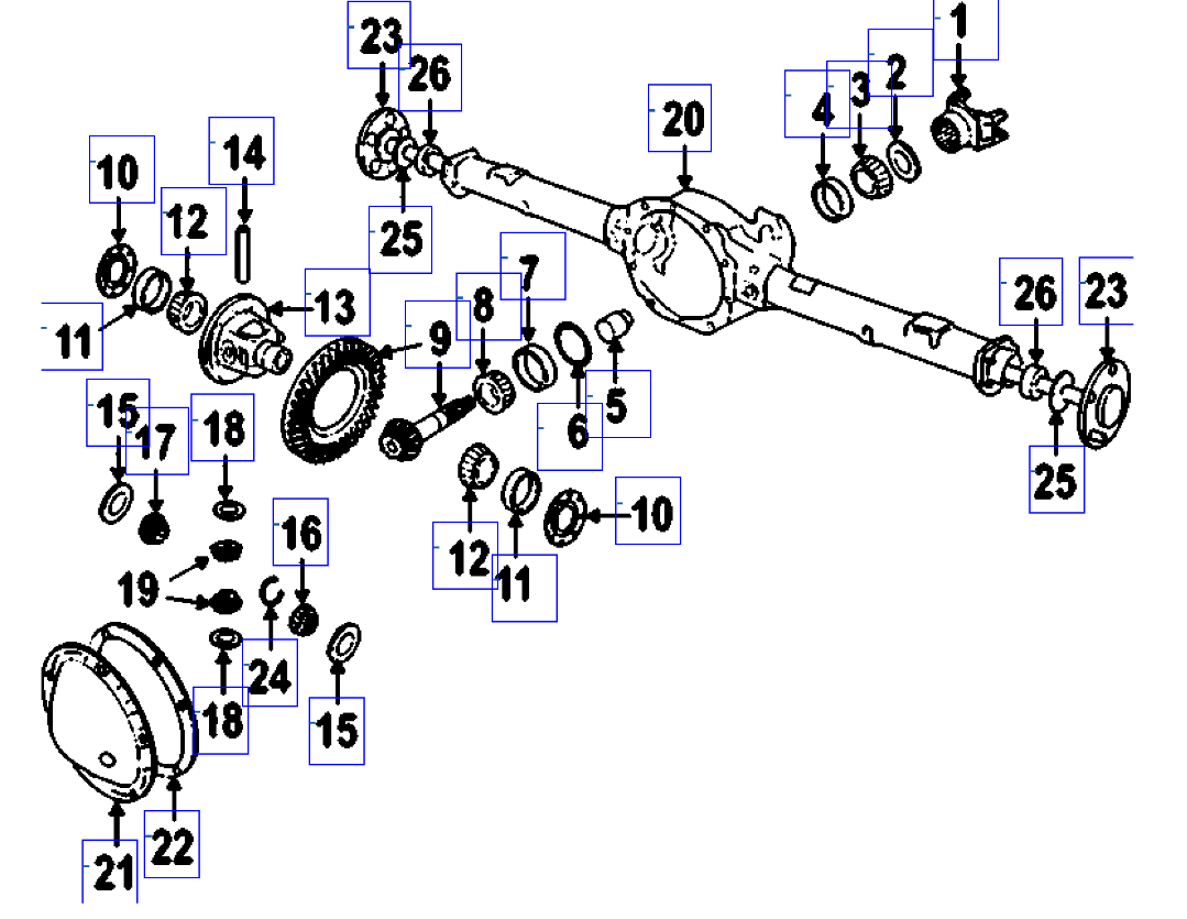

Yep, this can happen when the differential overheats due to gear oil that needs to be replaced or there is a mechanical failure causing the problem, either way I would remove the rear diff cover to inspect the gears and fluid conditioner, (check the fluid for metal flakes). Here is a generic guide to help you step by step with instructions in the diagrams below to show you how on your car:
https://www.2carpros.com/articles/differential-service
Check out the images (below). Please upload pictures or videos in your response to any problems so we can see what to help you with.

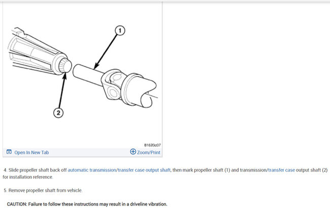

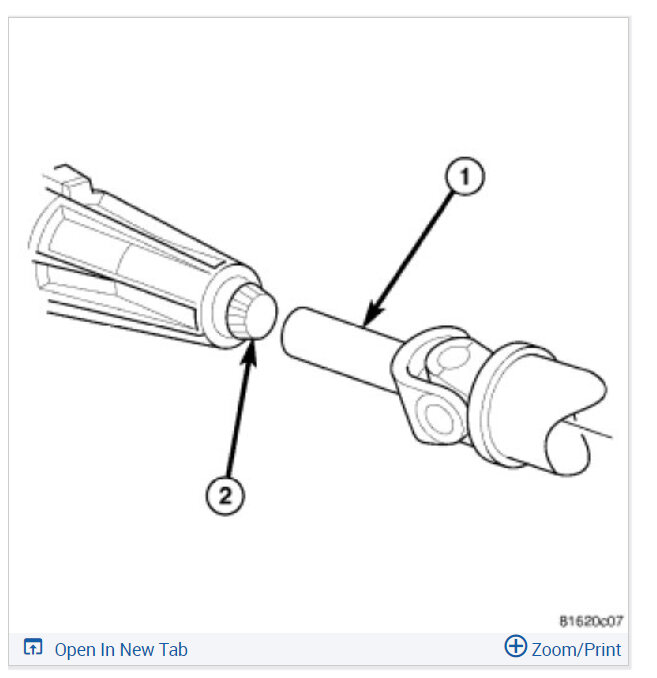

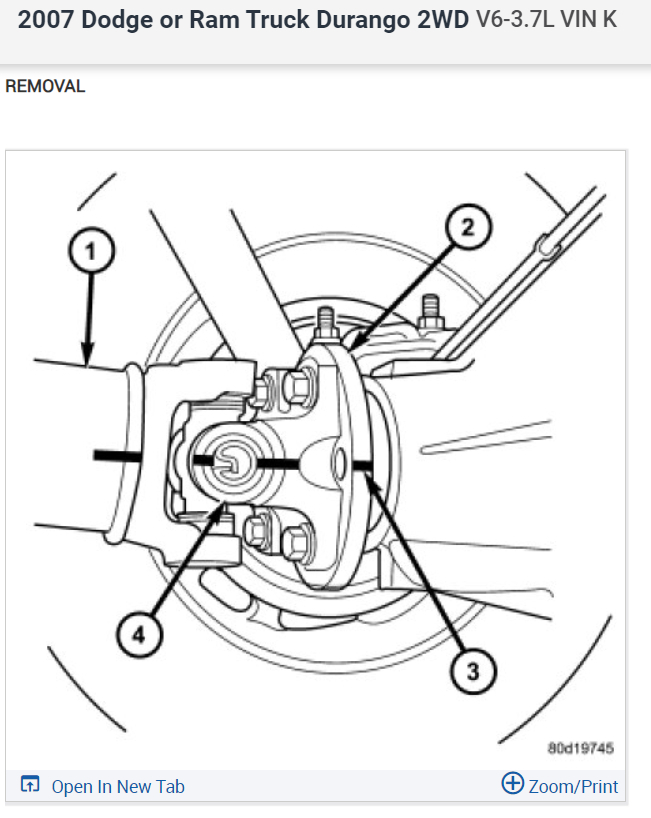

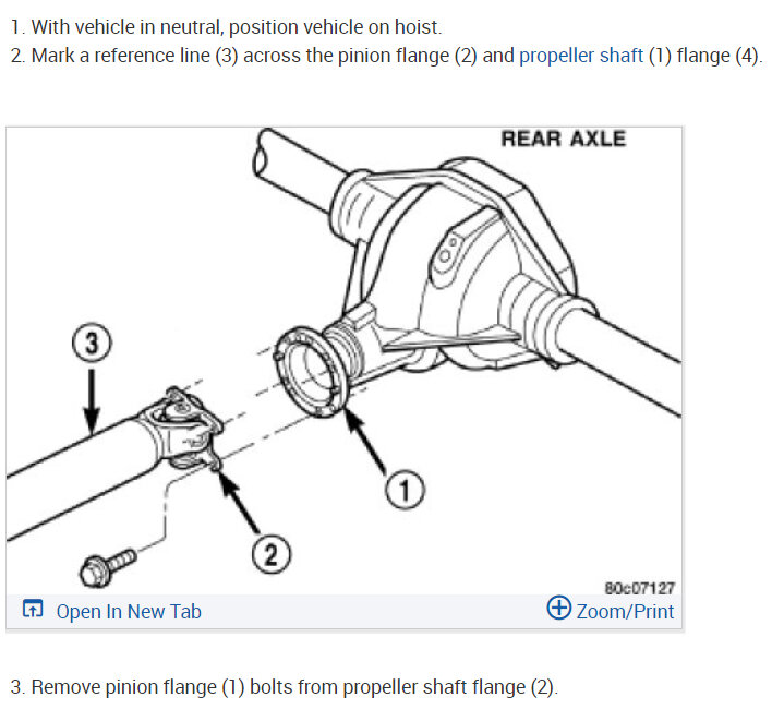

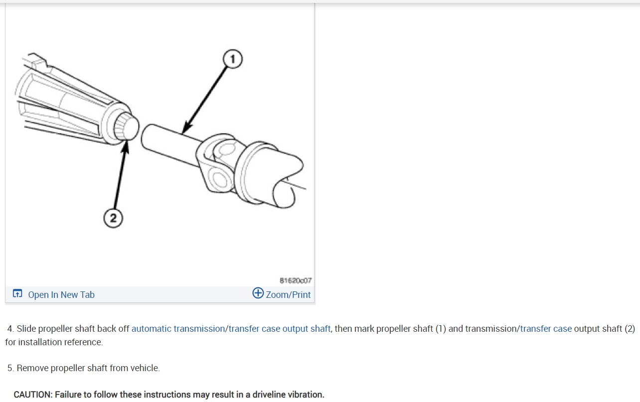

Yep, is the hum coming from the rear of the car? If so, it could be the rear end is having an issue. I would remove the rear cover to see what's going on. Also, you can remove the driveshaft to check the U joints.
Here is a generic guide to help you step by step with instructions in the diagrams below to show you how on your car.
https://www.2carpros.com/articles/how-to-remove-a-drive-shaft
This guide can help as well:
https://www.2carpros.com/articles/how-u-joints-work
