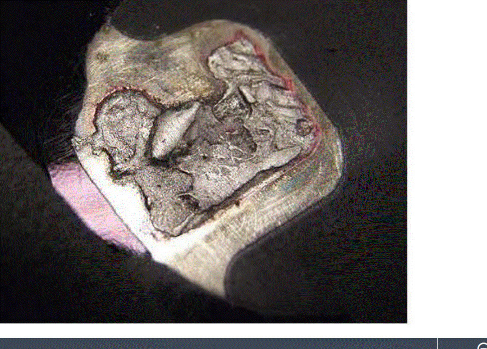

If the light isn't turning on, either there is no connection at the grid or the switch is bad. I did find a few technical service bulletins related to grid connector tab failure and how to repair it.
Do me a favor. Check where the grid plugs in and confirm the tab isn't damaged. Also, I want you to take a test light and check to see if power makes it to the grid. If you look at pic 1, it shows what happens to the grid connection.
If you find the test light does turn on, then there is a connection issue at the grid. If it doesn't turn on, move to the switch, and confirm there is power both to it and out from it. If there is power in and not out, replace the switch.

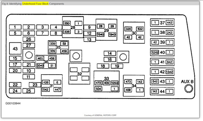

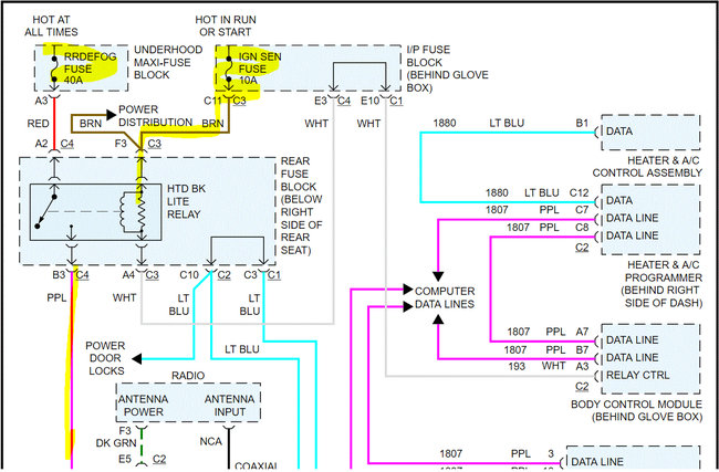

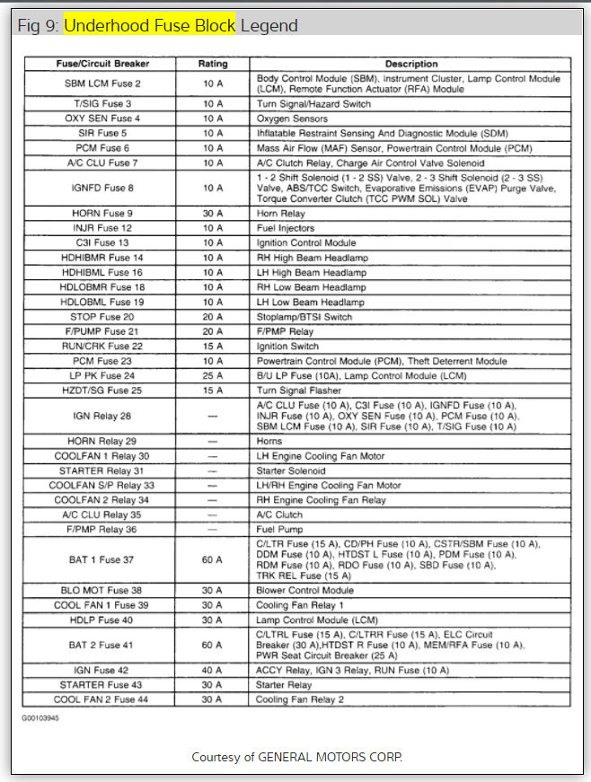

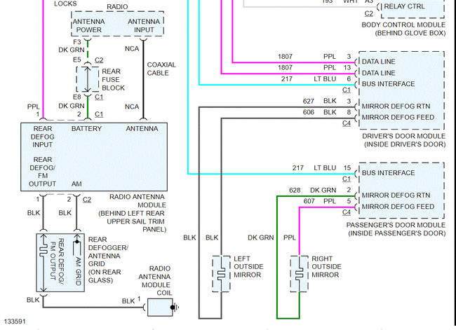

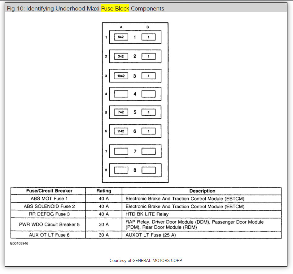

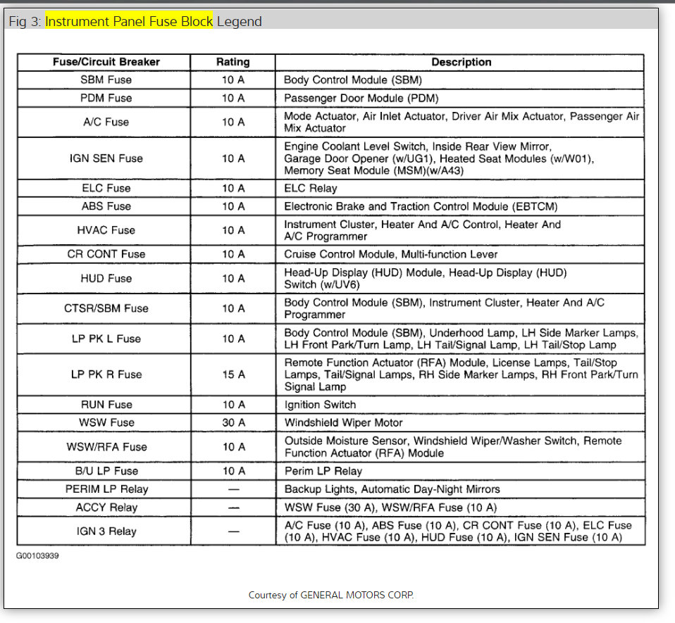

I attached two more pics showing the entire wiring schematic for the rear defroster. I had to cut the pic in half to make it readable. It shows a purple wire going to the defroster so make sure it has power. Also, I realize you checked the 40 amp fuse. Make sure power is both in and out from it and also check the 10 amp fuse highlighted in pic 2.

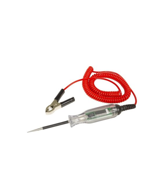

Which kind do I use? I have the pen looking one, or do I need the one that looks like a screwdriver?
Dec 20, 2020 at 9:09 PM
  • 110,241 POSTS
Honestly, either will work. Since you won't use it too often, the one on the right will be much less expensive.
The 40 amp fuse is in the under hood fuse box and the smaller one is behind the glove box in the vehicle.

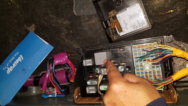

You may want to check the relay in the trunk fuse panel. Here is a link that shows how that is done:
If there is another relay with the same part number, switch them to see if it makes a difference.

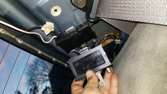

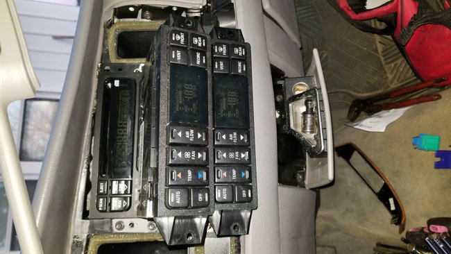

Okay, test light completed. Defrost/antenna module changed (as shown in picture, new one one the wall, old one in hand). Climate control panel in dashboard changed new one on bottom) . All fuses and relays changed (new one pointing at located underneath rear seat). I press the rear defrost button even on the new climate control panel, and still no illumination on button, and still no rear defrost. Wth am i not seeing or missing?

There is power up to (via the test light) harness that goes into the antenna/defrost module, new antenna/defrost module, then little harness on top that leads to grid tabs, then to grid. No brakes, burns. Grid lines are intact as well.

When you check power to the module, is it plugged in? We could simply have a weak connection that is failing when a load is placed on it. Also, I know you checked the 40 amp fuse. However, did you check the 10 amp one behind the glove box that I mentioned?

I'm looking through different schematics that seem to be conflicting. At the grid, are there one or two wires? I believe there should be only one, but I'm seeing two different things.
Dec 31, 2020 at 3:17 AM
RJC42005
  • 18 POSTS
At the grid there are 2 wire's connected to the grid and goes into the top of the antenna module.
Dec 31, 2020 at 3:21 AM
  • 110,241 POSTS
One has to be ground, then. Can you check for continuity to ground?

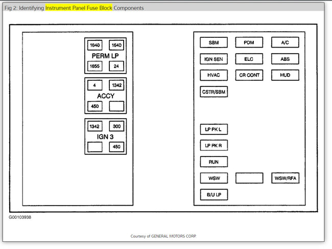

Electrical problems can be frustrating but please hang in there. Lets try replacing the perm LP relay in the behind the glove box relay panel. Here is the location. Check out the diagrams (below). Let us know what happens and please upload pictures or videos of the problem.
Jan 6, 2021 at 3:25 AM
RJC42005
  • 18 POSTS
None of the posted diagrams say which one is the one behind the glove compartment.
Jan 6, 2021 at 3:32 AM
RJC42005
  • 18 POSTS
And looking through all the diagrams, I don't see anything that says "PERM ID"???
Jan 6, 2021 at 3:34 AM
  • 55,399 POSTS
sorry, its "perm LP" in the first diagram.
