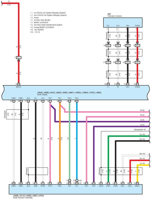

I put my second hand car for the first time in auto park. While it was going to park itself i pressed the brake as the car beside was close enough and my car would touch it. After that i parked the car myself but that time i had to park without rear camera. i do not know why the display is blank. all other function work but rear camera display is blank.

Did it come on for the auto park or not at all for anything? Looking at the wiring the camera plugs into and is powered from the display head.
I would check that the camera is plugged in and test the wiring for voltage on the red and black power feeds. If there is power then it could be a bad camera.
