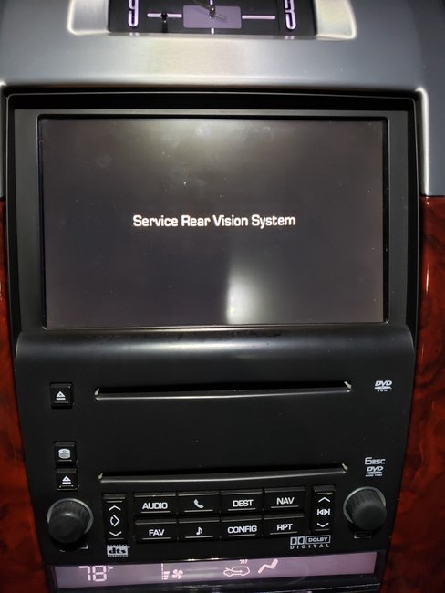

Got a message on my screen when I go to reverse service rear vision system does this me my camera is shot? Any trouble shooting or am I going to have to replace the camera?

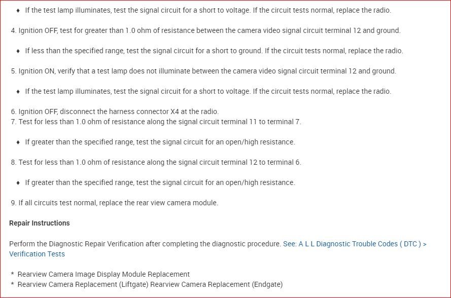

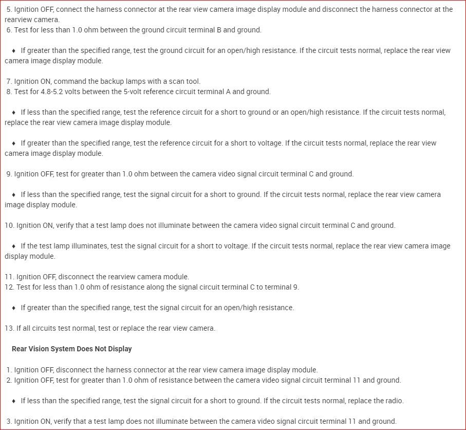

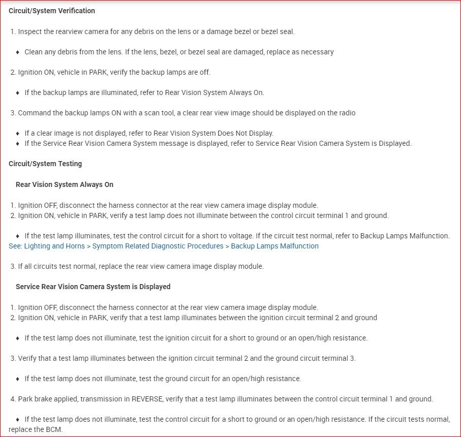

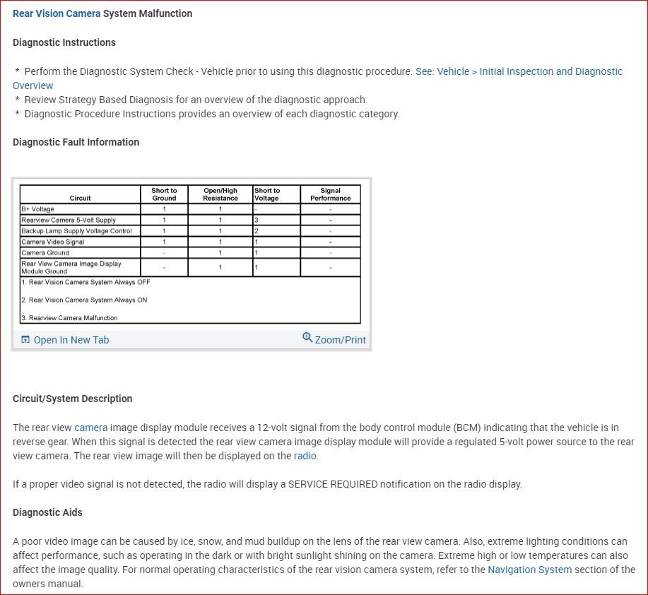

It could be the camera. However, this message means it could be anything in the system. I attached the TSB that will help figure out which component in the system is the problem. Unfortunately, it looks like it ranges from a wiring issue to the BCM.
Here is a guide that will help with this type of wire testing:
