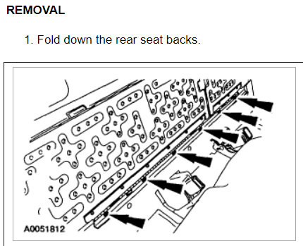

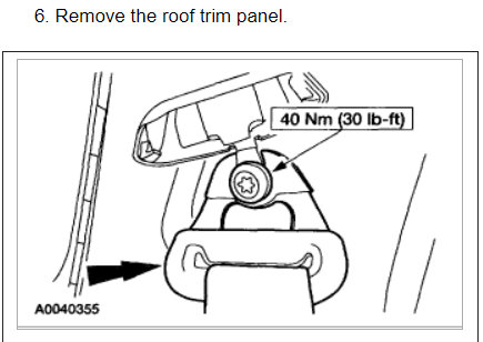

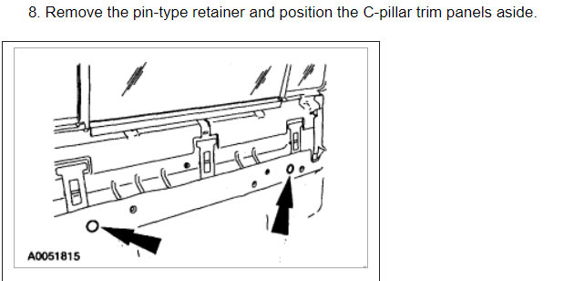

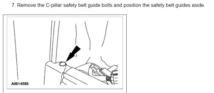

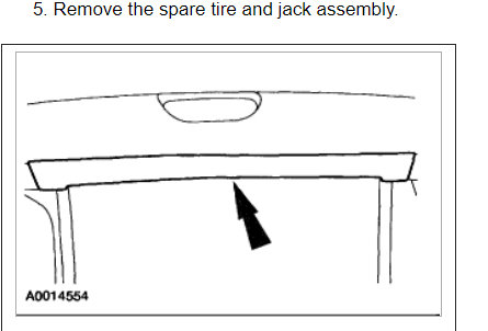

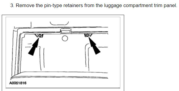

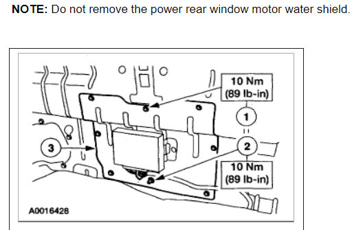

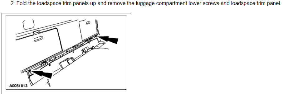

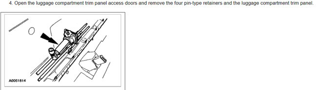

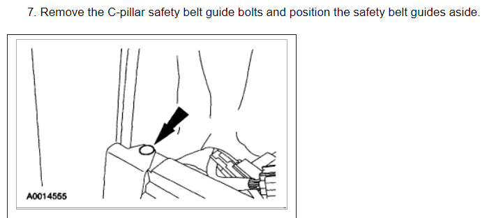

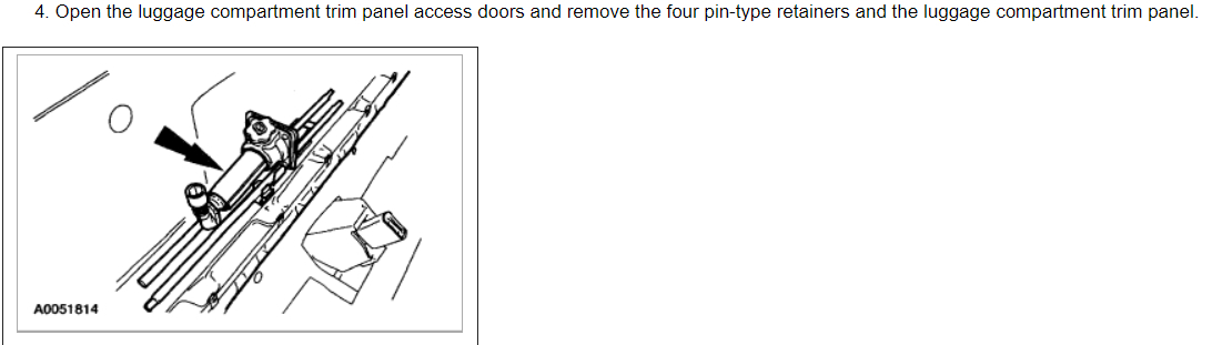

how to remove and replace.
Feb 5, 2018 at 7:04 AM
Experienced Mechanic
55,649 POSTS
I found the information you are looking for it is in ALLDATA check the diagrams (below).
Images (Click to enlarge)
Feb 8, 2018 at 1:32 AM
EDDIE57
MEMBER
2 POSTS
by the time i got this i allready figured it out my self thanks you last post was spot on
