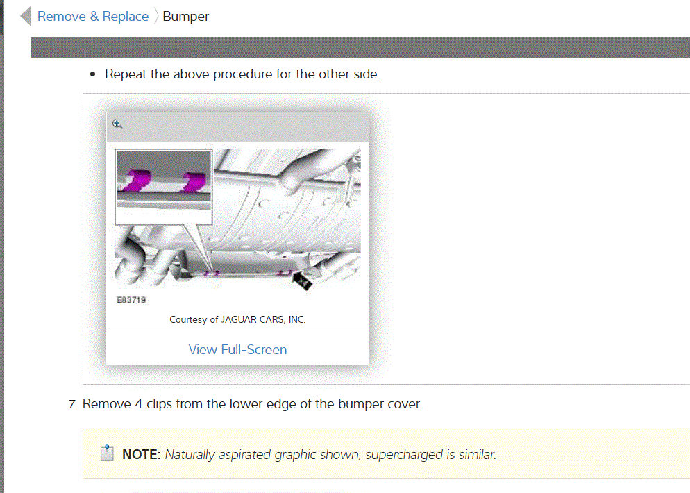

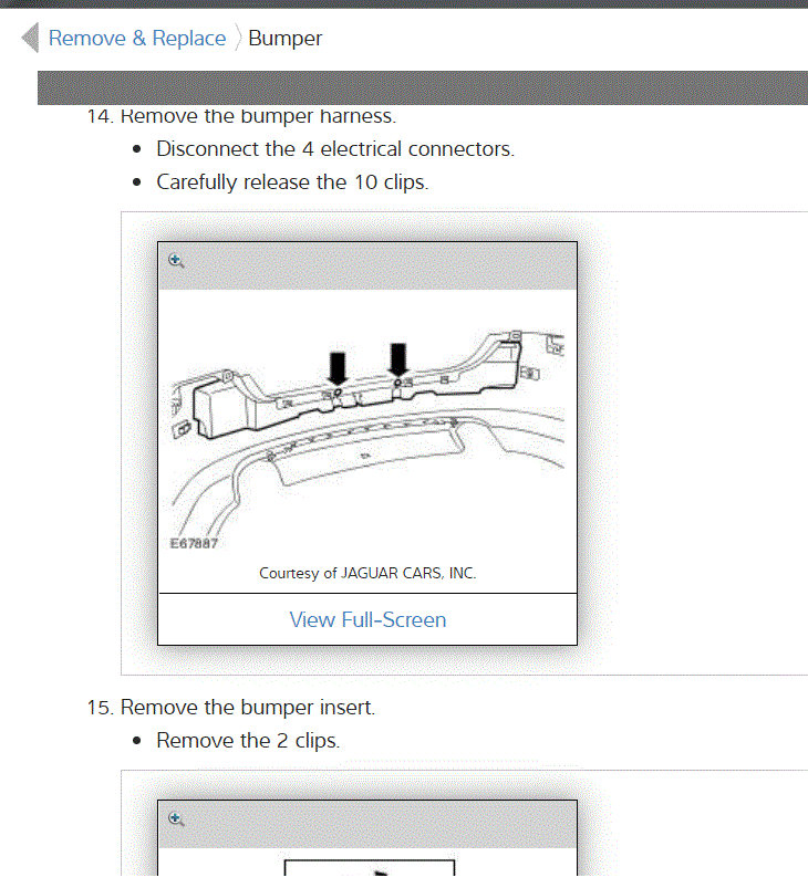

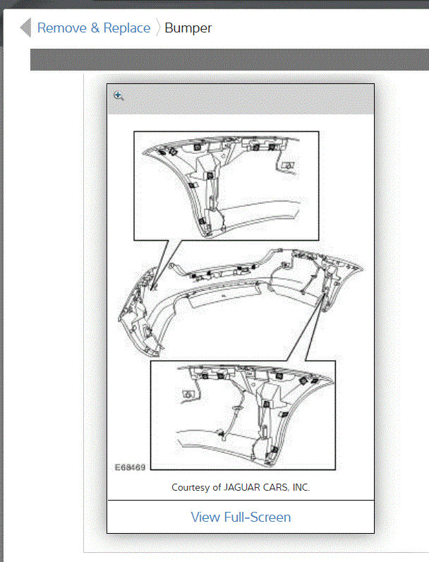

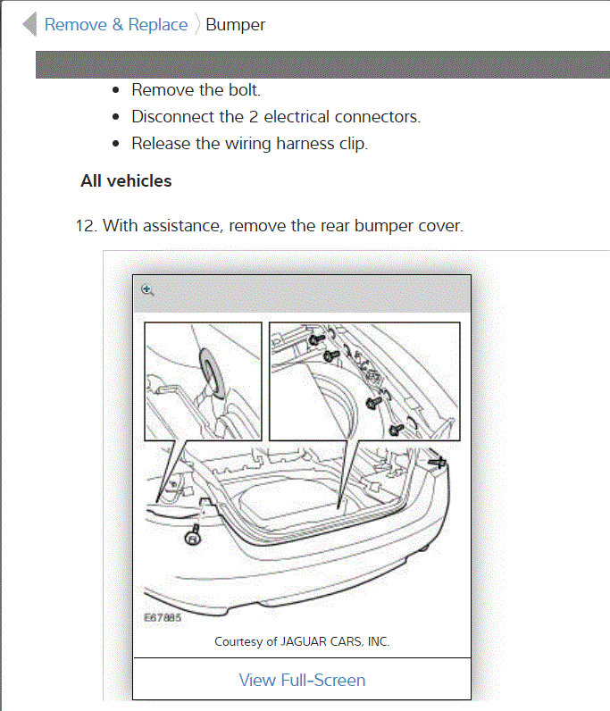

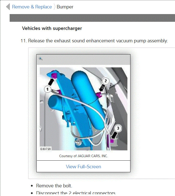

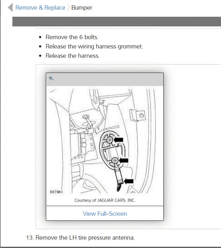

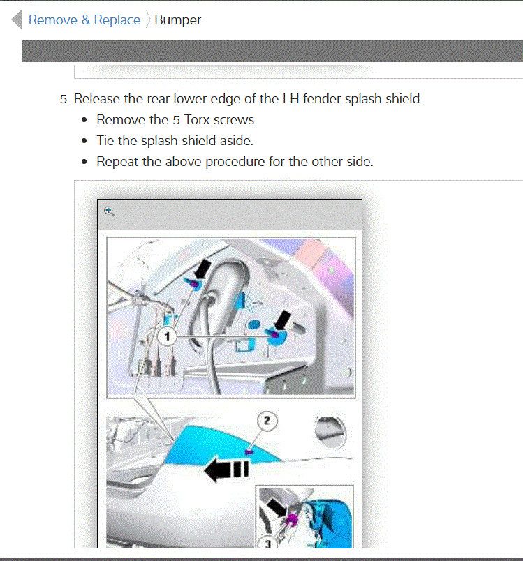

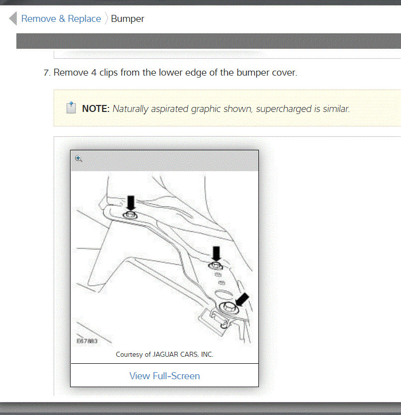

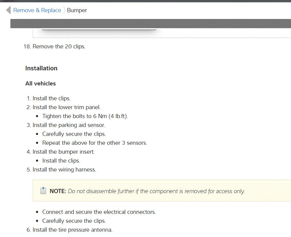

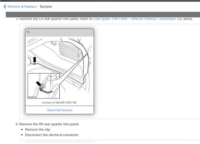

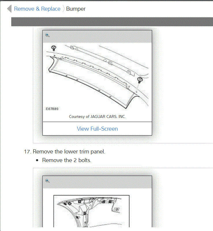

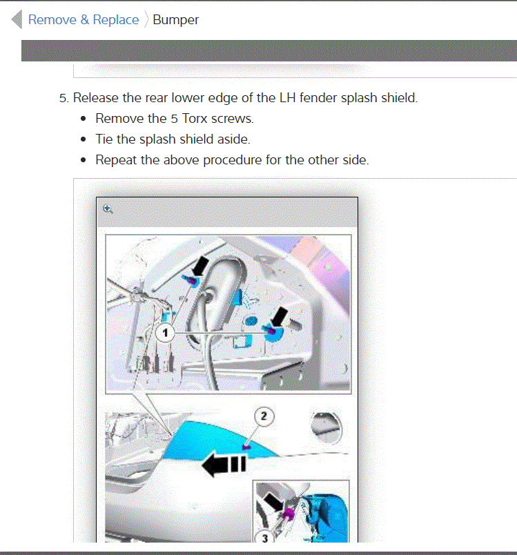

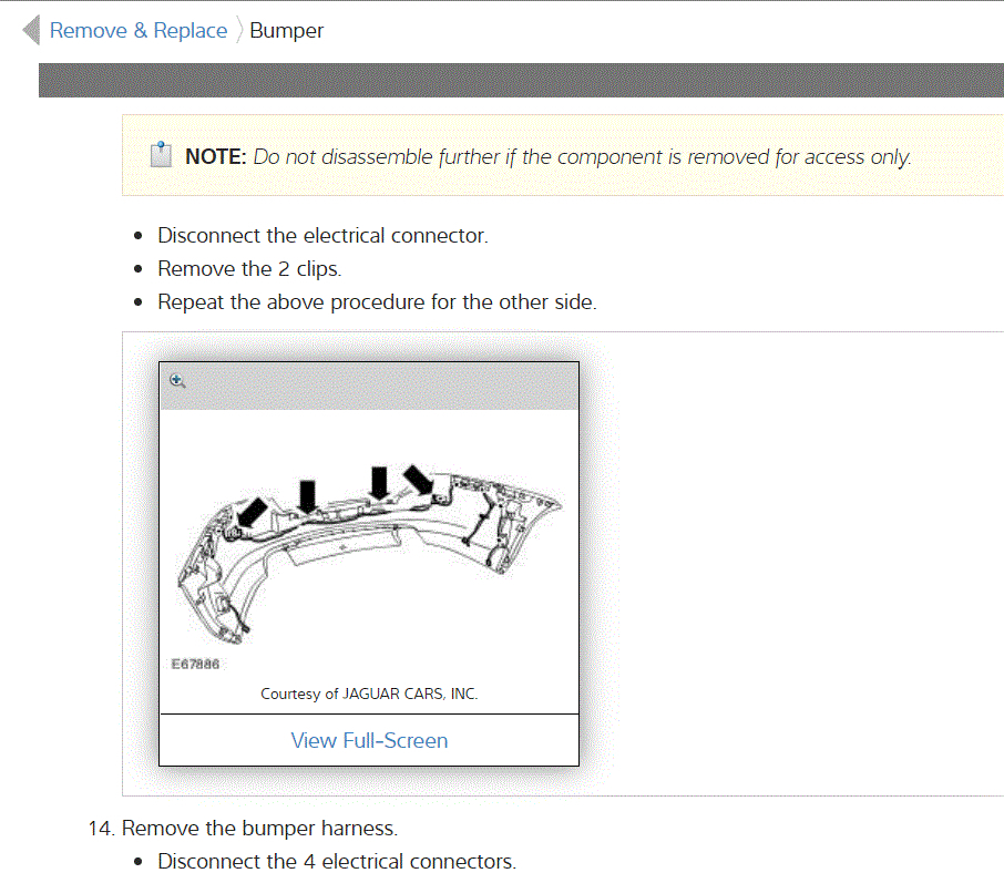

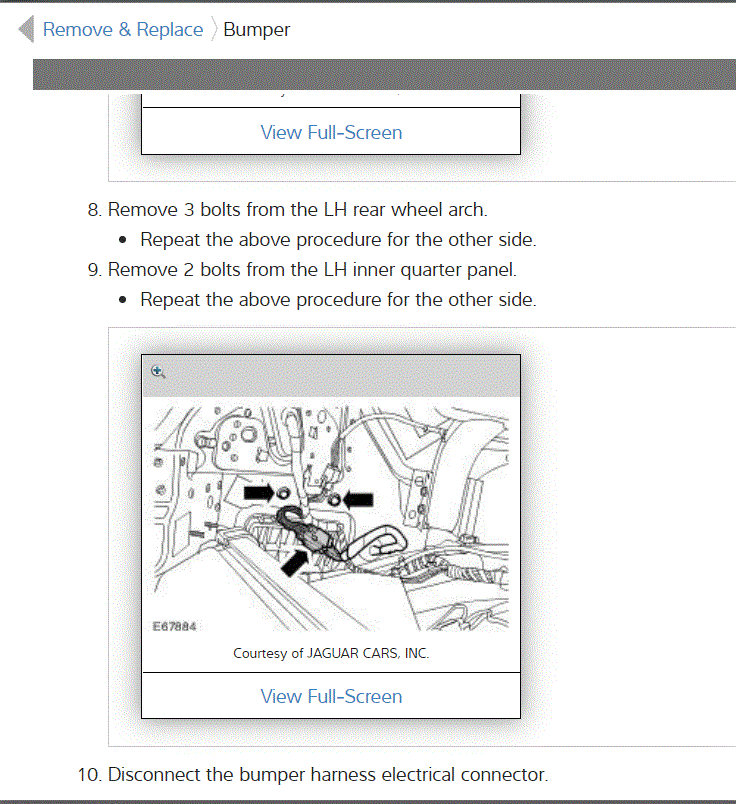

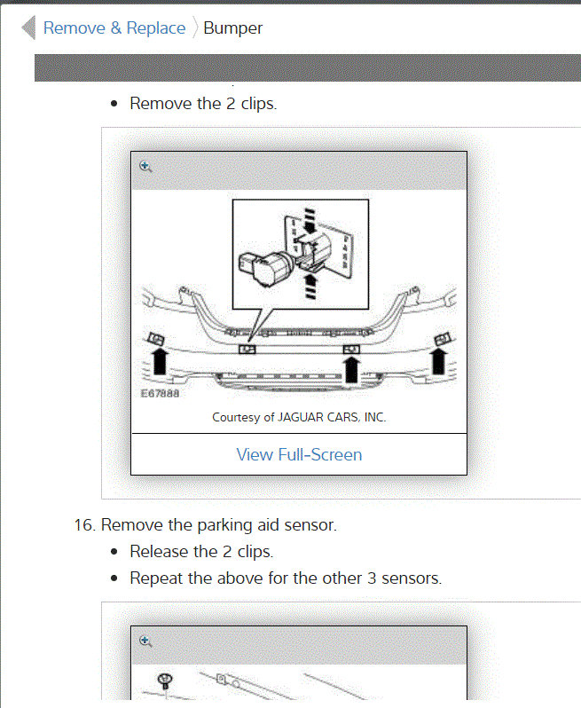

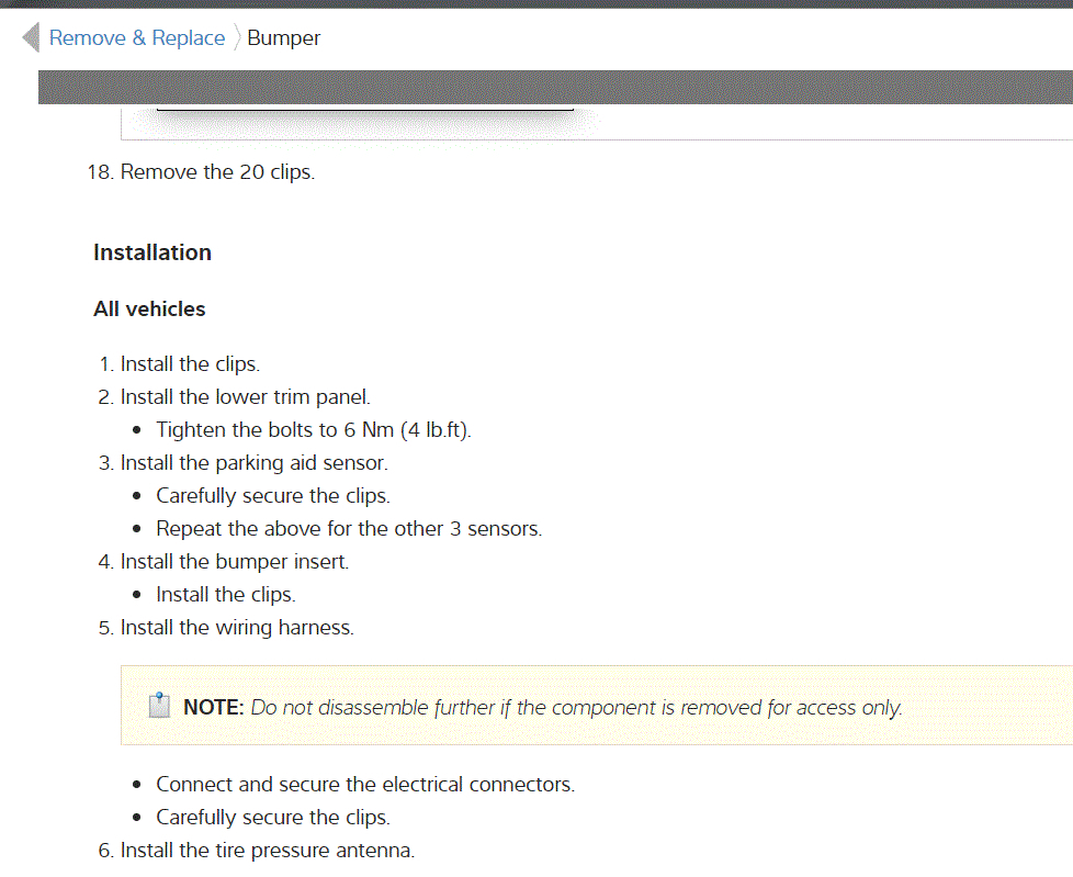

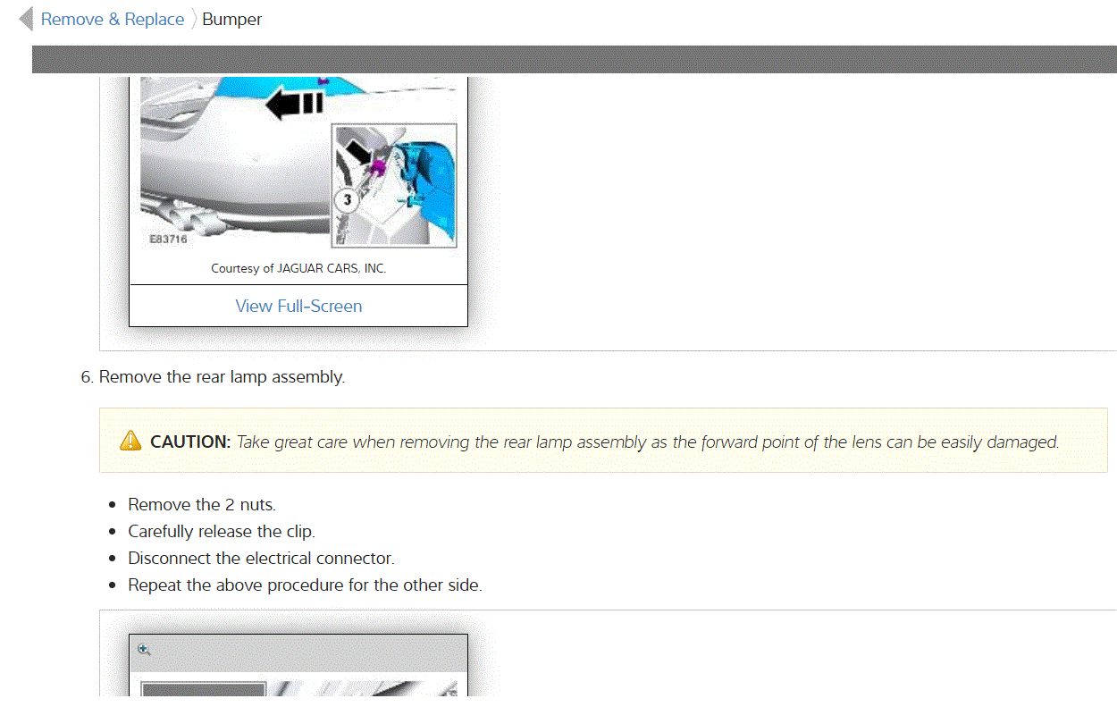

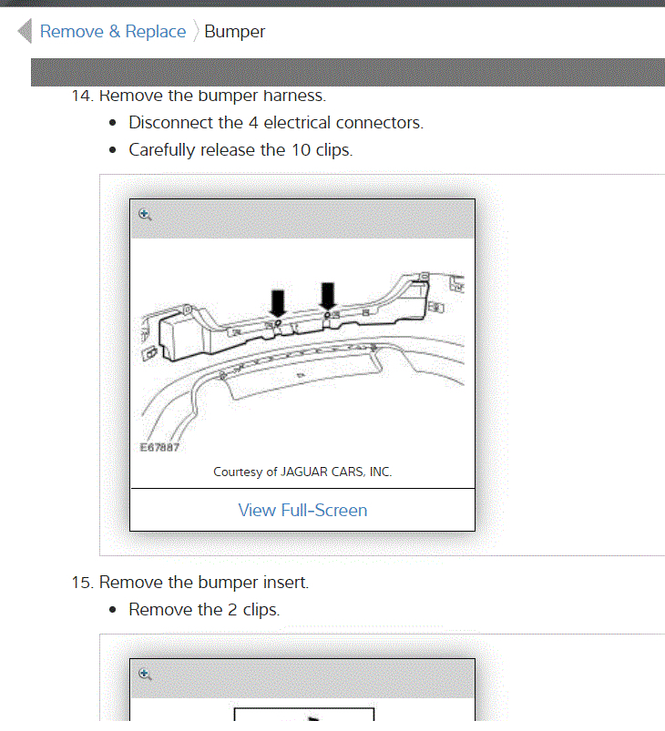

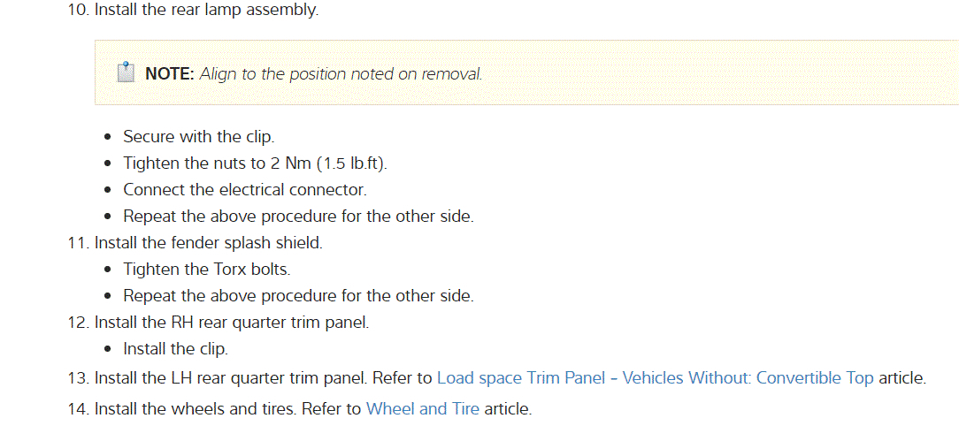

One of the parking sensors fell inside the bumper so i need to get it back out. any help on removing the bumper cover?
Feb 19, 2020 at 10:38 AM
  • 110,251 POSTS

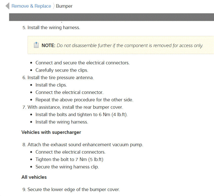

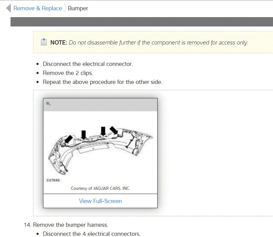

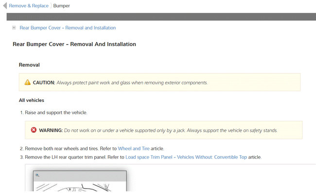

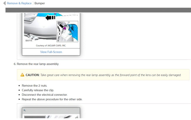

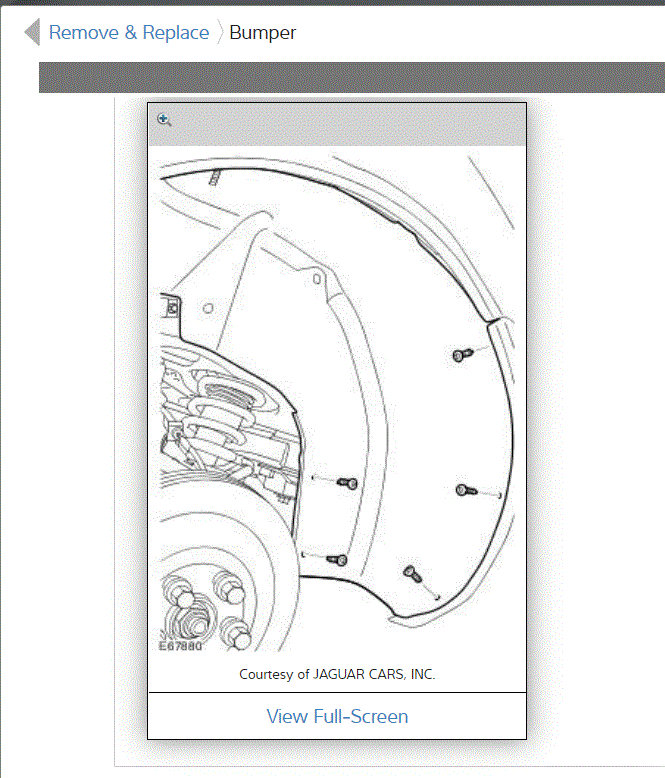

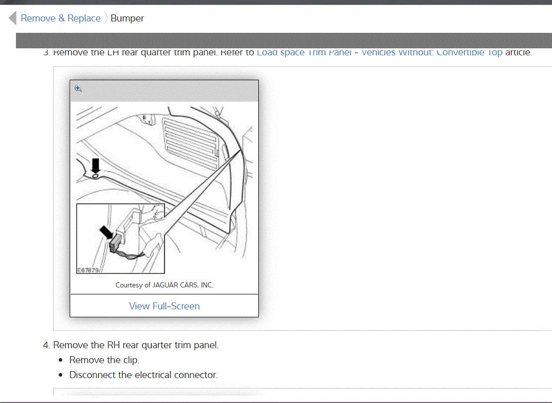

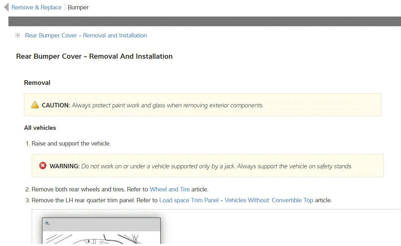

I attached the directions, but I had to do it in pictures. I did overlap each picture so you could follow them. Let me know if it helps or if you have other questions.
Feb 19, 2020 at 11:10 AM
NASER NASER
  • 836 POSTS
Wow, it's like rebuilding a motor, lol. thanks that helps.
