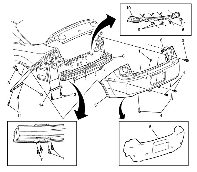

How do you take off the rear bumper?
Mar 27, 2019 at 11:04 AM
  • 110,241 POSTS
Welcome to 2CarPros.

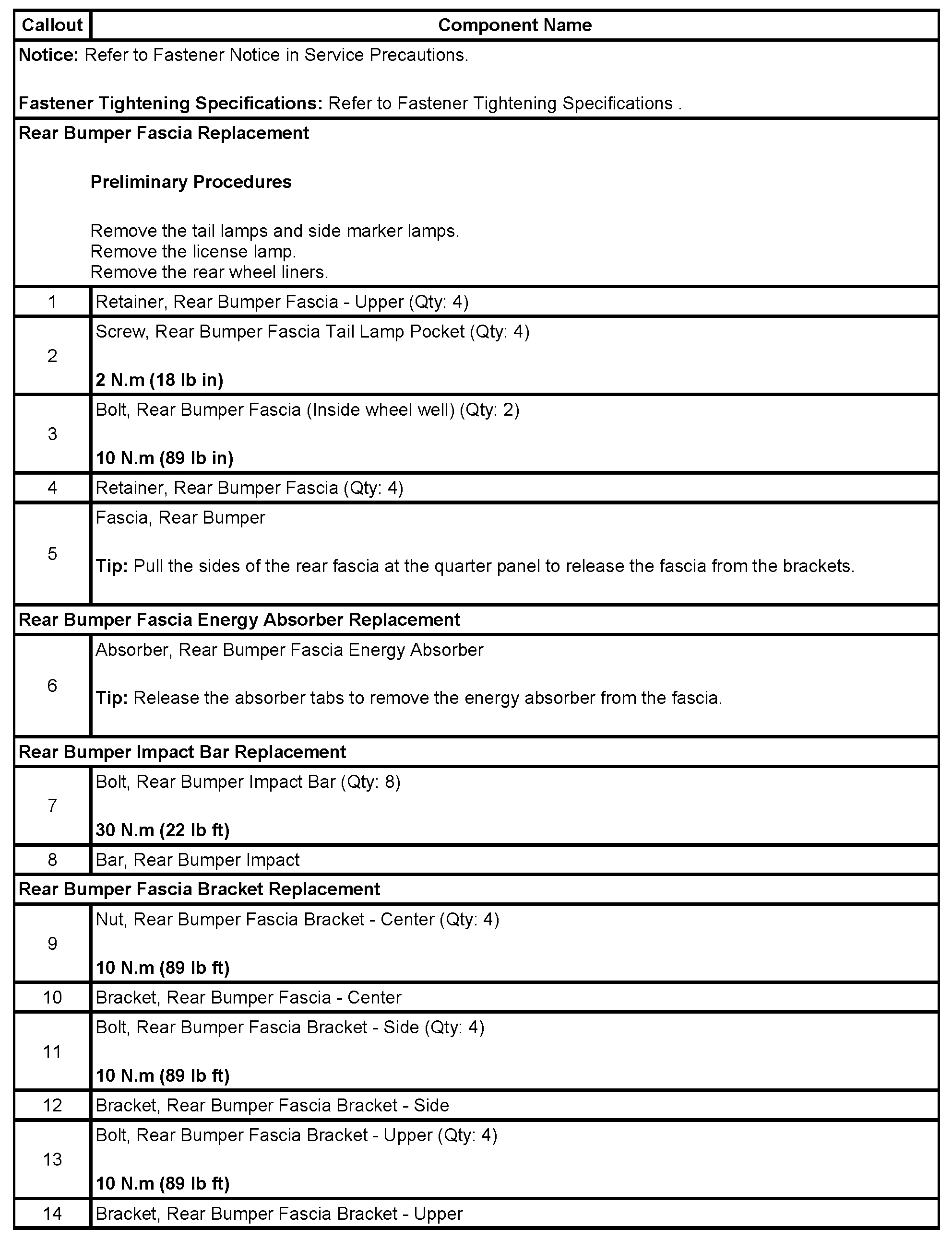

I'm not sure if you are referring to the bumper cover or the steel bumper under the cover. Take a look through the two pictures I attached. One shows an exploded view of all the fasteners. The second picture are directions.
Let me know if this is what you needed or if you have other questions.
