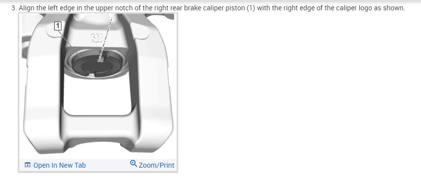

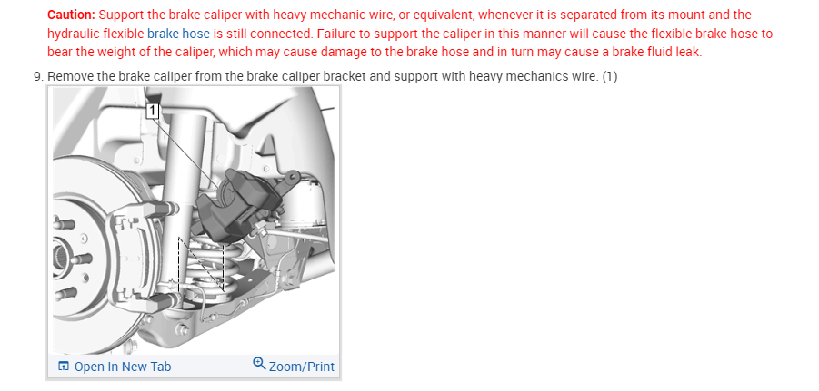

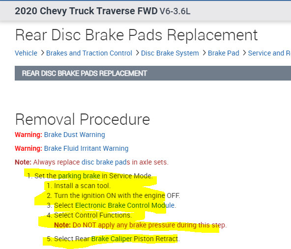

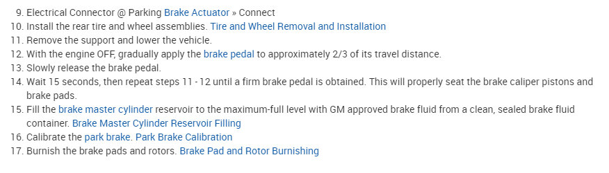

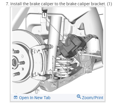

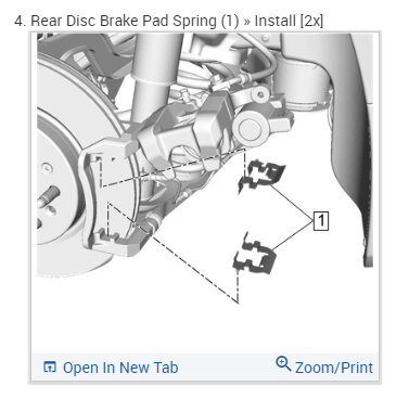

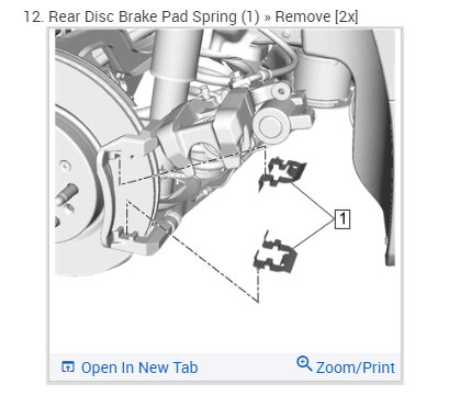

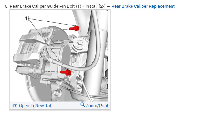

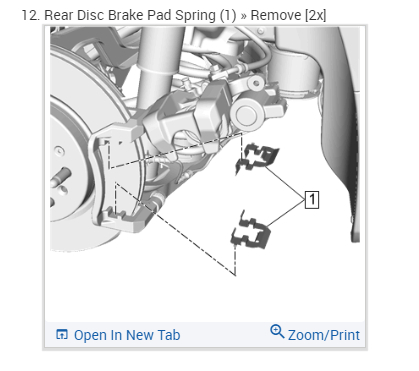

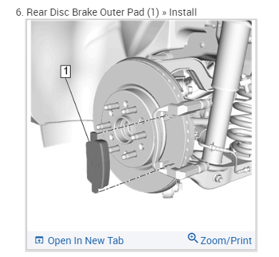

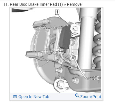

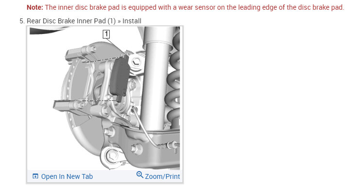

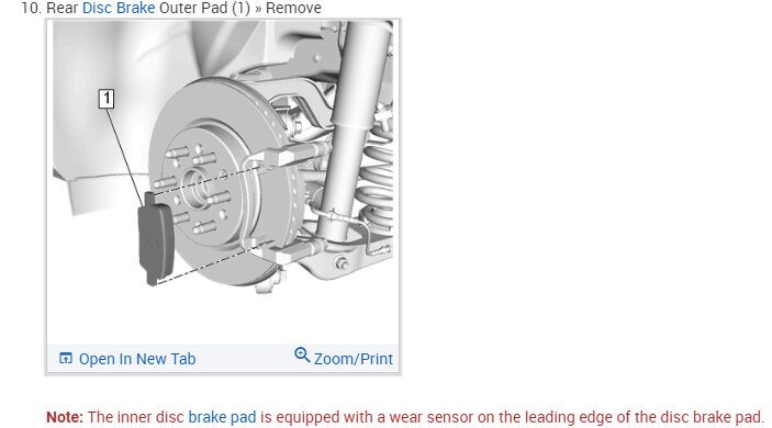

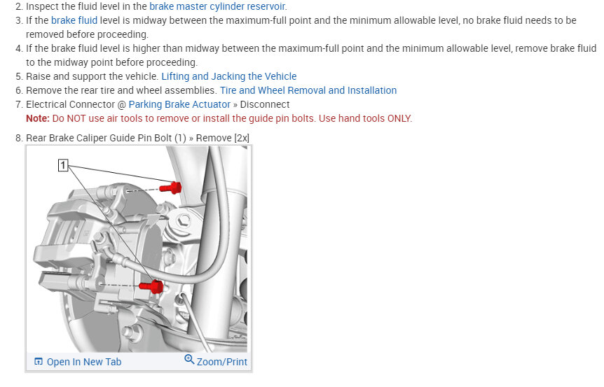

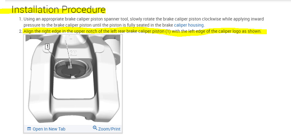

The rear brakes have the electronic brake system attached to the rear caliper and they do not retract.
Sep 4, 2023 at 9:49 AM
Experienced Mechanic
110,248 POSTS
You need a scan tool that can communicate with the vehicle. I have no idea why they need to make things this way. LOL
I attached the directions below for replacing the pads. Let me know if they help.
