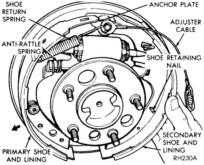

5. Vacuum brake components to remove brake lining dust. If vacuum is not available, use water dampened cloths to remove dust.
6. Remove shoe return springs with brake spring plier tool.
picture 1

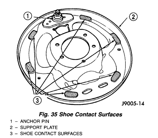

13.Remove brake shoe retainers and springs.
picture 2

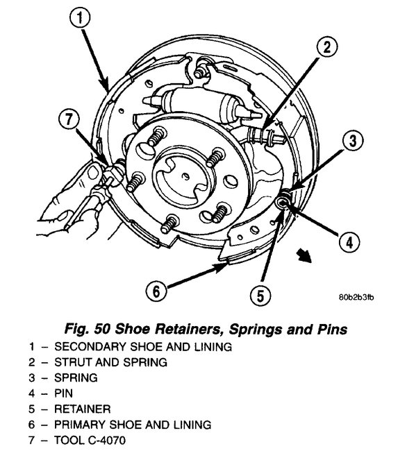

1. Clean and inspect individual brake components.
2. Lubricate anchor pin and brake shoe contact pads on support plate with high temperature grease or Lubriplate.
picture 3

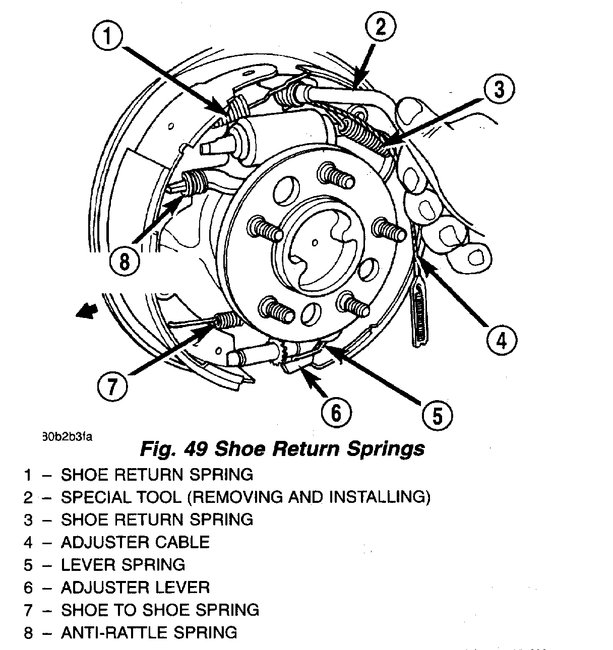

7. Install secondary shoe on support plate. Insert strut in shoe and guide shoe onto anchor pin. Temporarily secure shoe with retaining pin.
Fig 7 Installing Brake Shoes
picture 4

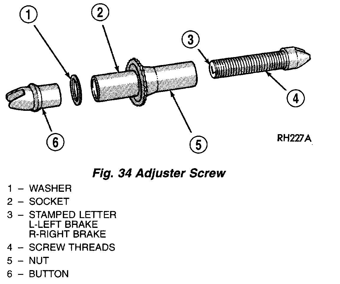

10.Assemble adjuster screw, then install between the brake shoes.
picture 5
NOTE: Be sure the adjuster screws are installed on the correct brake unit. The adjuster screws are marked L (left) and R (right) for identification.
