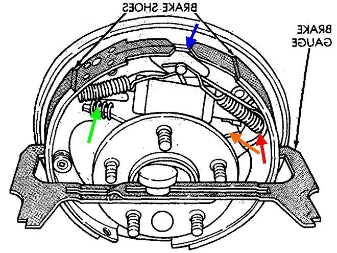

The self adjuster do not work on my truck after replacing the brake shoes. I went over them sever times but the self adjuster is not working right. It is new and I used anti lock stuff on it so it would not freeze up. I changed the axle shaft and the dust cover new springs and wheel cylinder and all that stuff on the side it is not working on. Another thing I cannot figure out is the brake drum on same side since changing the axle shaft it locks that side up tight. I checked to see if the brake shoes are touching but they bare not. It calls for the bigger drum but the smaller drum from the 1997's work just fine, but no self adjust so I have to keep adjusting them manually. Any ideas?

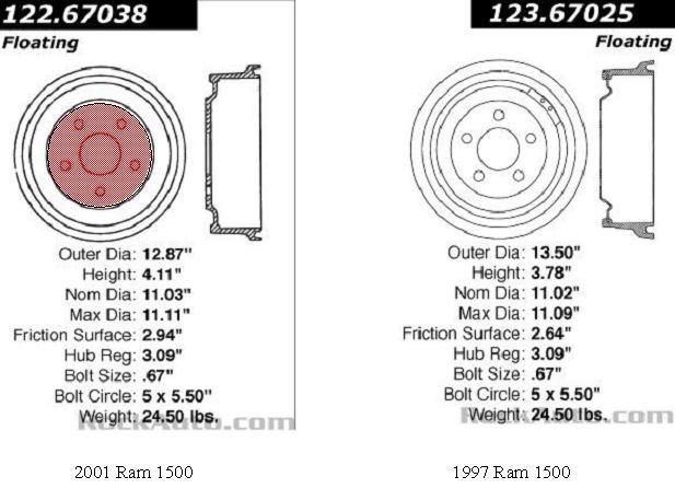

The drum you mentioned is not interchangeable on your truck. Unless specified differently by the manufacturer, the maximum a drum can be machined over-size from original is .060". That is only .030" of material removed all the way around, totaling a .060" larger diameter. Even at that, the diameter of new shoes will not match the diameter of the drum until they wear quite a bit. 1997 drums have a much different diameter, so the first thing is to get the correct drum on there before you go looking for other causes that may not exist.
Any chance you can post a photo of the brake shoes on that wheel? Without seeing it, I can only offer some suggestions of the common things I have run across and that I have caused myself. The first thing is to be sure the "leading shoe", the one toward the front of the truck, has the shorter lining, and the trailing shoe has the longer lining. The smaller front shoe simply grabs the rotating drum and tries to rotate with it. As it does, it pushes on the adjuster assembly, and that pushes the bottom of the rear shoe into the drum, to apply it. The piston in the wheel cylinder pushes the top of the rear shoe into the drum, also to apply it. (That is why it is called a "duo-servo" brake). The rear shoe does most of the stopping. That is why it needs to be a longer and/or thicker lining.

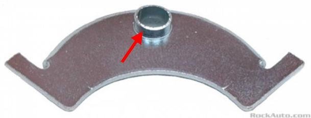

This next problem is a little harder to describe. Look at the quarter-round stamped metal guide the adjuster cable rides on. That is held in place by the hook on the rear shoe's return spring. It is easy to overlook that guide popping out and not sitting flush with the shoe. In the photo below, I added a nifty red arrow pointing to the formed tube that must be seated in the hole in the shoe. I have found it is impossible to slide that into place after the spring has been installed. You have to remove the spring, seat the guide, then reinstall the spring. Hold the guide in place with your thumb as you stretch the spring into place, otherwise it is likely to pop out again. If it does pop out, it will be pulled up and toward the axle shaft, making the distance too short for the cable. You will see the adjuster lever will be down too far, and even if it does move, it won't move far enough to advance the star wheel.
The next often-overlooked problem is a parking brake cable that is rusted in the partially-applied position. That alone will prevent the self adjuster system from doing its job. The first thing to look at is both brake shoe frames must be resting solidly against the anchor bolt on top of the backing plate. That is the blue arrow in the second drawing. I turned this drawing around so it is correct for the left rear brake. Those points are hard to see behind the springs and metal plate. Instead, push forward on the top of the rear shoe. If it moves, you will also see the front shoe move away from that anchor. That is proof the parking brake cable is not fully-released.
Even if both shoes are resting against the anchor bolt, look next at the parking brake strut bar between the two shoes. There needs to be 1/8" gap between that bar and the front shoe, (green arrow). Push forward on that bar with your thumb at the rear shoe, by the orange arrow. The bar should move easily against the pressure of the anti-rattle spring. If that is tight with no free play, it is because the sticking parking brake cable is holding the lever attached to the top of the rear shoe partially-applied, or pulled forward. The self adjuster will be ineffective if there is no free-play in that strut bar.

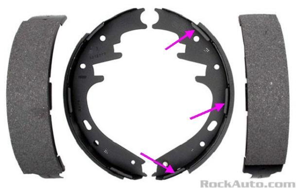

For drum brakes that seem to apply by themselves, or fail to release properly, there are six "lands" on the backing plate that must be inspected. Those are the raised surfaces the shoes ride on, (three for each shoe). High-temperature brake grease must be applied to those spots during routine brake service. When it is not used, grooves can form on those lands, then the shoe frames can catch on them. A shoe may not apply properly, but more commonly, it will get stuck and won't release. GM has had a real big problem with this since the 1970's. Chrysler uses a version of the same brake, but there are three bent-over tabs on both sides of each shoe to increase the wear surface and reduce this problem. Those tabs are not shown in this drawing. I found a better drawing. The three purple arrows in the third drawing show those lands on the trailing shoe.

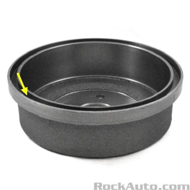

One last thing I should mention is with the wrong drum, one thing we forget to consider is the "labyrinth" seal. The yellow arrow in the fourth photo is pointing to it. There is a lip formed on the outer circumference of the backing plate that fits into this groove around the drum. Its purpose is to reduce entry of dirt and water. With the wrong drum, the backing plate might rub on the drum in that area. I suspect you would have heard that, but it is worth mentioning for others who might be researching this problem. It is also common for rust to build up on the drum and cause a grinding sound, but that typically wears away rather quickly, and is soon forgotten.

The only thing you can have is the drum is rubbing on the lip on the backing plate. To prove that, I have a spray can of leak detector powder that would work perfectly. You spray a light coating on one part, assemble them, take them apart, then look for where that powder transferred to the other part. You might be able to do that with a spray can of white lithium grease, or even spray paint. You might also try using our special tool for this, . . . a dollar bill. Hold it across the lip on the backing plate, then slide the drum on. If the two parts are rubbing, you won't be able to pull the dollar bill out.

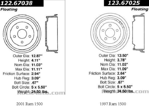

I cannot help but feel if you put the right parts for the model year on the truck, you will solve the problem. Here is the list of specs for the two years. The fact the original drum diameters are different tells me these are not the same truck in many ways. The diameter of pistons in the front calipers, rear wheel cylinders, and master cylinder, and the size of the friction surfaces are all factors in designing a brake system that is perfectly balanced front-to-rear.
Besides the legal ramifications of modifying the brake system, and having two brakes that do not stop as hard as the other two, also consider that a brand new drum with no wear to the friction surface is going to be very hard to install over brand new brake linings that are starting out at the maximum diameter of their life. There is very little room to spare, but you're trying to install a drum that is smaller in diameter by .010". Even when the shoes are adjusted down as far as possible, getting that drum shoved on is going to take some effort. To see if this is what is happening, assemble the shoes and star wheel as a unit, and try to stuff it inside the drum. You should be able to separate the tops of the shoe frames where they hit the large anchor bolt on top, by a good 1/4". If you cannot do that, the drum is too small.
There is one more thing to look at that is not real common for this problem, but it is worth checking. Look at the inside of the drum that is red on the second drawing, and the mating surface on the end of the axle shaft. Look for any impacted rust, scale, or other debris. When that gets caught in there, it will tilt the drum and change the relationship to the backing plate. I have also seen that happen to two-piece drum/hub assemblies like those used on older Escorts. The pieces are held together by the studs, and there is shoulders on them that cannot get lined up right to the holes in the drum. That can cause a horrendous wobble in the drums and the wheels/tires.
