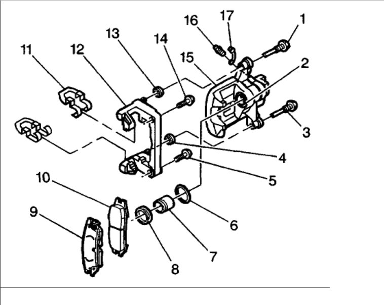

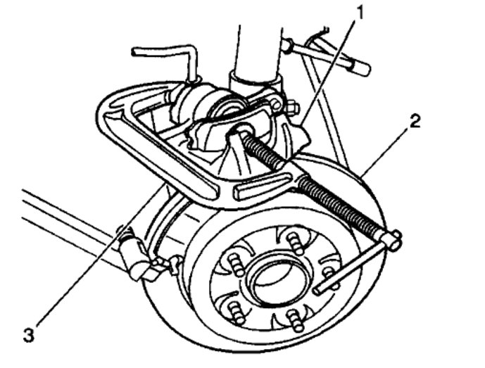

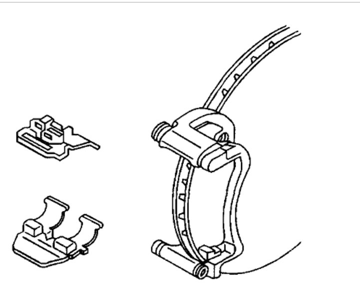

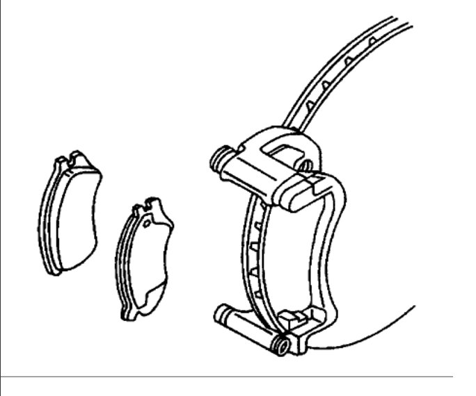

Wanting to know how to replace my rear brake pads only.
Sep 21, 2017 at 9:44 AM
Experienced Mechanic
55,766 POSTS
Hi!,
Yep the first thing you must do is the raise the car safely. Here is a guide.
Here is a guide to show you what you are in for when changing the rear brake pads and rotors.
https://www.2carpros.com/articles/how-to-replace-rear-brake-pads-and-rotors
You should bleed the brakes after you are done.
https://www.2carpros.com/articles/how-to-bleed-or-flush-a-car-brake-system
Here are some diagrams to help you get the job done on your car. (below)
Images (Click to enlarge)
