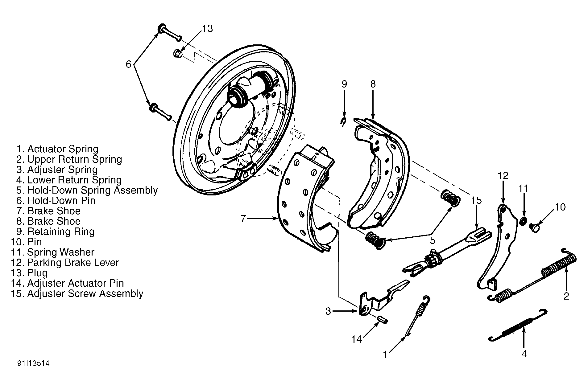

Replace rear brakes and brake booster and now sometimes after stopping my truck drags when trying to accelerate or take off. Also, sometimes it is hard to shift into drive or reverse. I have to wait for a minute before I can move.

Hi and thank you for using 2carpros.com. It sounds like either a spring was not correctly installed or a retaining pin has failed. What I would recommend is to remove the rear drums and reinspect the components. Once your sure everything is together properly, then properly adjust them. These are the directions for adjustment direct from Alldata.

Additionally, here are general directions for brake replacement just to be sure they were done correctly.
https://www.2carpros.com/articles/how-to-replace-rear-brake-shoes-and-drums
I also uploaded a spring diagram to confirm that you have it back together correctly.
