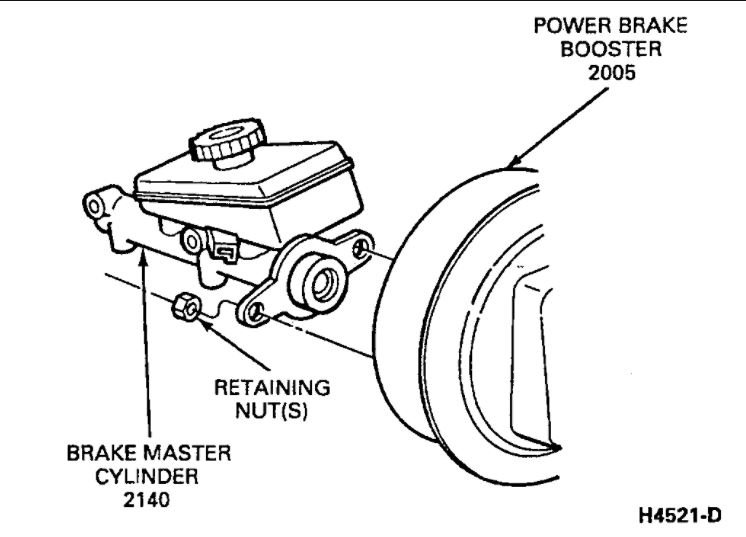

Has any work been done? This sounds like a bad master cylinder and it is not producing pressure to the wheels.
https://www.2carpros.com/articles/brake-pedal-goes-to-the-floor
https://www.2carpros.com/articles/how-to-bleed-or-flush-a-car-brake-system
https://www.2carpros.com/articles/how-to-replace-a-brake-master-cylinder
I attached the procedure for you below for the repair.
REMOVAL
1. Disconnect the brake warning lamp indicator wire from the plastic reservoir low fluid level warning switch socket.
2. With the engine (6007) turned off, push the brake pedal down to expel vacuum from the power brake booster (2005).
3. Disconnect the brake master cylinder connector tube (2A040) from the brake master cylinder.
4. Remove the wrap-around clip and attaching nut from the booster master cylinder mounting stud.
Brake Master Cylinder
5. Remove the brake booster-to-master cylinder retaining nuts. Remove the brake master cylinder from the power brake booster.
