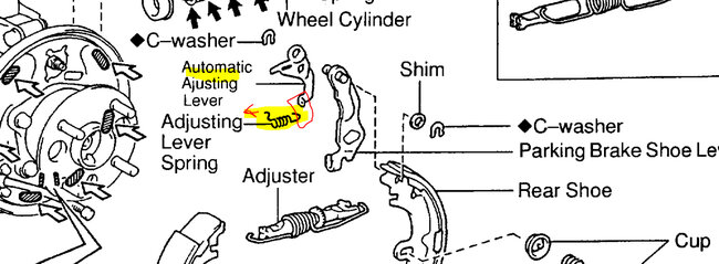

So, the car needed new brake shoes. Yes, rear shoes. Non-ABS model. I've swapped out wheel cylinders on cars before, but never had to do the shoes and all of that mess.
After much toil, hammering, and trouble, I got it done. But there are 2 burning questions. 1) each side has a spring on it that runs to the rear shoe from a piece of hardware. Not one of the springs that holds the shoes together and not the spring clip. It has a double hook on one side and a regular hook on the shoe side. I can't remember how that egoes for sure. I've got it in place where it's not coming out, but it doesn't "feel right." I'm thinking it has become too stretched to go into the holes that it's supposed to go into.

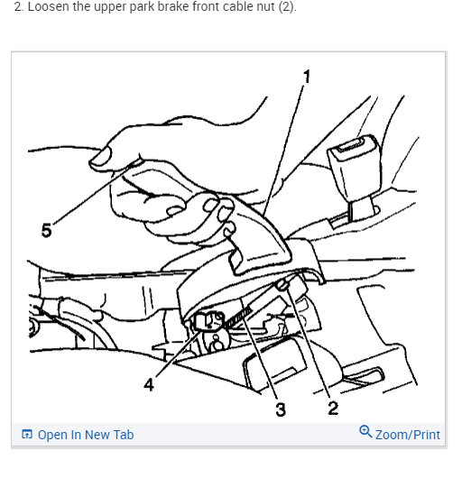

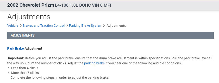

I'm looking in the manual, but I do not see what you described. I attached a picture below. Do you see the spring you are referring to? (see pic 5)

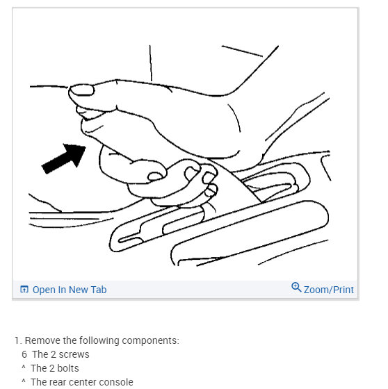

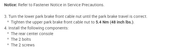

As far as the parking brake adjustment is concerned, it is done at the parking brake lever. The correct adjustment is based on the number of clicks from the handle. See pics 1-4 below.

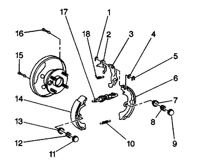

18 in the exploded diagram.
Sep 17, 2023 at 1:04 AM
  • 110,248 POSTS
The spring is for the self-adjuster. The one end connects to the self-adjuster lever and the other (that looks odd) will attach to one of the brake shoes where there is a circle drilled into it. See pic below.
If this doesn't help, take a pic of what you have and upload it for me to see.
See pic below.

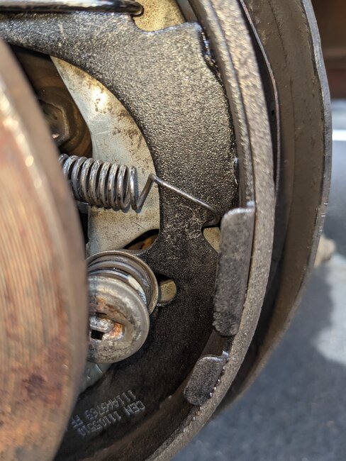

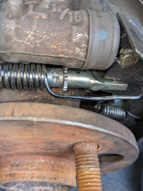

Well, I got around to one side of it this morning. Got it figured out and pieced it together. Nearly all assembled when I realized the lower spring had come loose. Took things back apart to take care of that. And then s*** went to hell and it took me an hour+ to get the dirtiest puzzle ever reassembled. But I got it. And I got the e-brake adjusted (I think, didn't really test it but there's good tension in the lever). I'm attaching pics of what it looks like for future reference. After all, there are still millions of these cars out there (Chevy/Geo Prizms and Toyota Corollas) so it may come up again for you. I'll get better pics when I fix the other side some day (maybe next Thursday, when I also try to patch the brand-new giant exhaust leak that makes it sound sporty).
