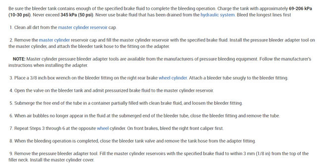

Replaced wheel cylinder assembly and other brake components and hard brake line (which had a hole) bled brakes so no air in line. What is causing uneven braking pressure?

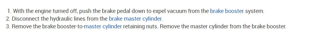

https://www.2carpros.com/articles/how-to-replace-a-brake-master-cylinder
https://www.2carpros.com/articles/how-to-bleed-or-flush-a-car-brake-system
If you have unequal pressure, most likely it is the master cylinder.

I understand that if its uneven from front to rear but the unevenness is only on one rear wheel, just the passenger rear. Driver rear is applying adequate force.
Jun 2, 2021 at 5:28 AM
Okay, I understand. It still points to the master cylinder.
Jun 2, 2021 at 7:53 AM
F1501986
Thanks for your assistance; I'll try a replacement and see how it goes!
