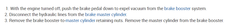

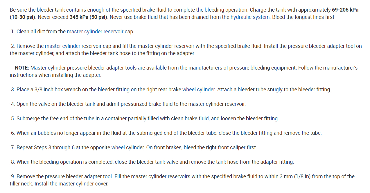

This could be the master cylinder. The way the system works is the master cylinder sends pressure to the right front and left rear from one line. Then the other line goes to the left front and right rear.
https://www.2carpros.com/articles/how-to-replace-a-brake-master-cylinder
https://www.2carpros.com/articles/how-to-bleed-or-flush-a-car-brake-system
If you have unequal pressure, most likely it is the master cylinder.
