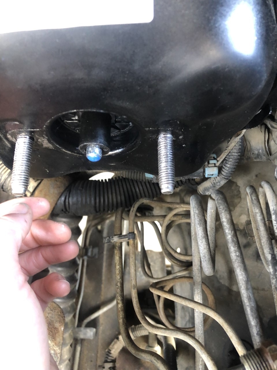

Just replaced the master brake cylinder and booster 4 days ago. Have driven about 6-800 miles since and all has been fine. This morning after about 45 minutes of driving my rear passenger tire started smoking a decent amount. Is it the wheel cylinder? I replaced the booster because both rear cylinders were not engaging while depressing the brake pedal.

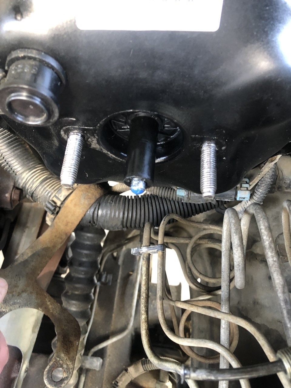

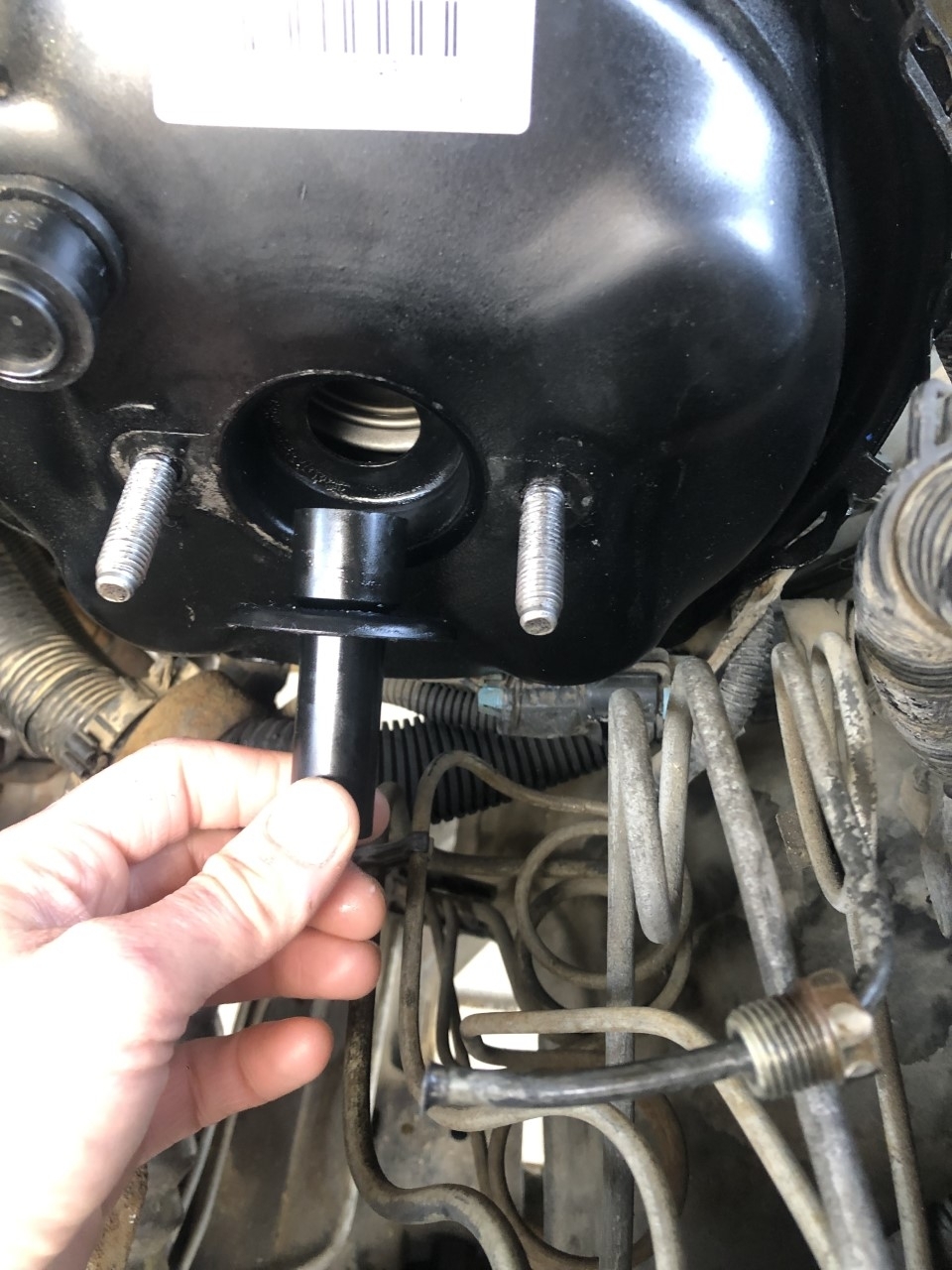

the tires spin freely. You said if i did both sides, are asking if i changed the brake shoe? if so, no i didn't. since the first message i put new wheel cylinders on. i'm not sure how to tell if the plunger in the housing is fully returned or not and also this booster does not have an adjustable rod. so i'm not sure how to make sure it's at the appropriate, and safe, distance from the master cylinder. before i knew that though, i did remove the brake master cylinder and reached down to turn the rod, wouldn't turn, so i messed with it a bit and it just came out completely. Is that normal?

I don't like that the rod just came out, but it might be normal. When the brakes are locked up can you loosen the master mounting nuts about three turns to see if the brakes unlock? Can you check the plunger in the rear of the master to see if it returns fully?
