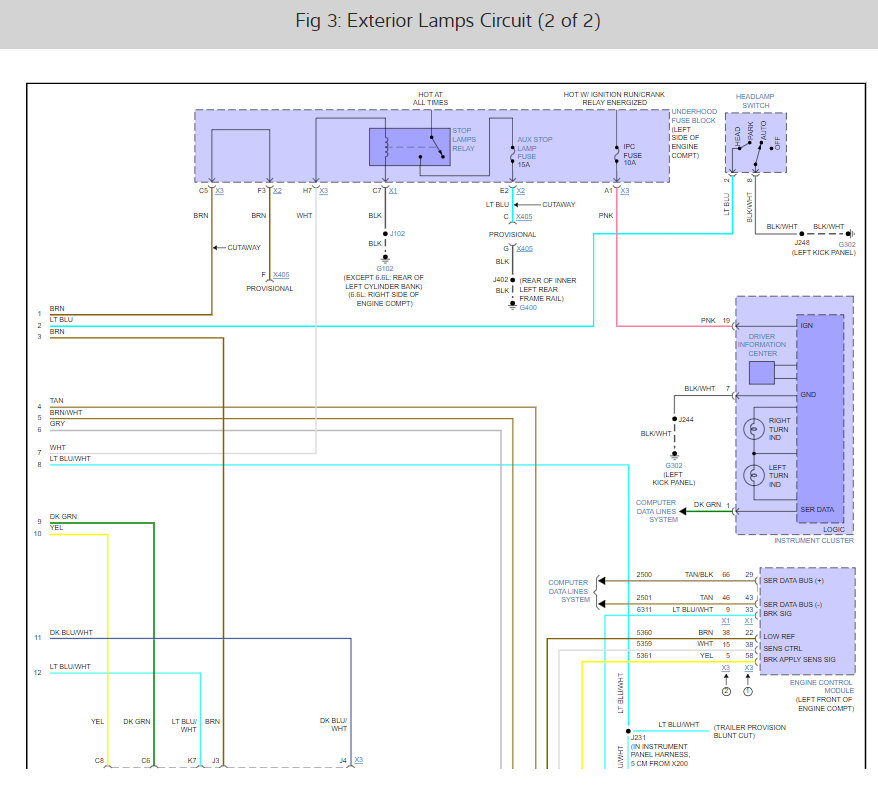

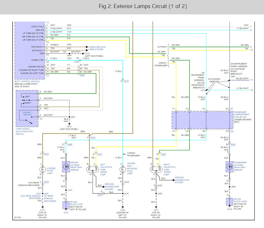

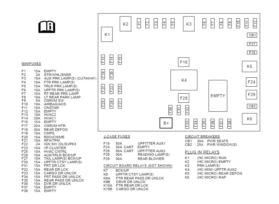

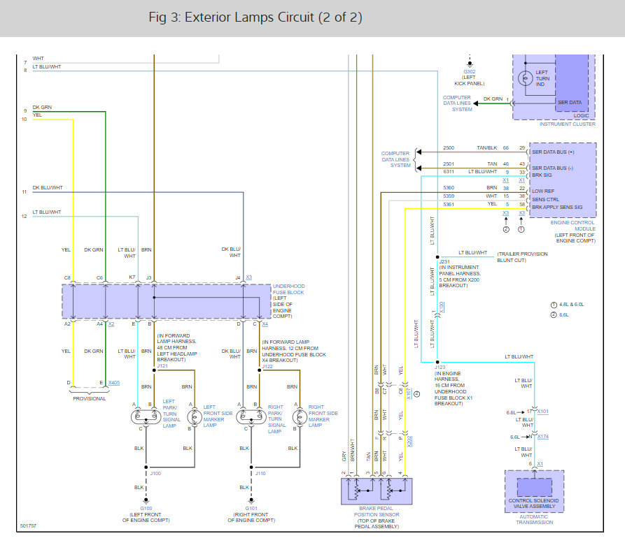

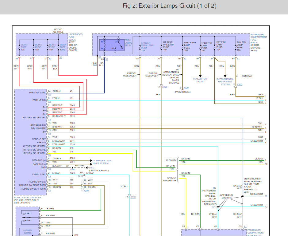

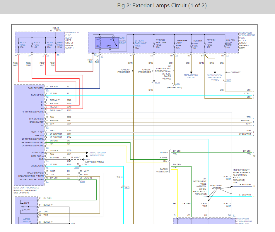

I would check the left rear park lamp fuse located in the driver's side fuse panel under the seat. Here is the location of the fuse plug a guide on how to check it with blinker and parking light wiring diagrams for your 2016 GMC Savanna in the images below.
