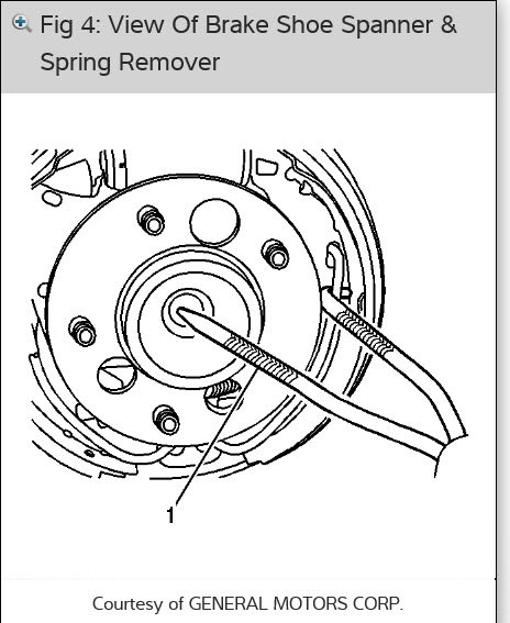

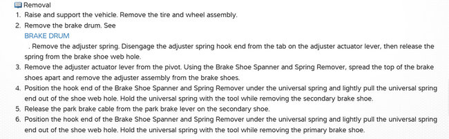

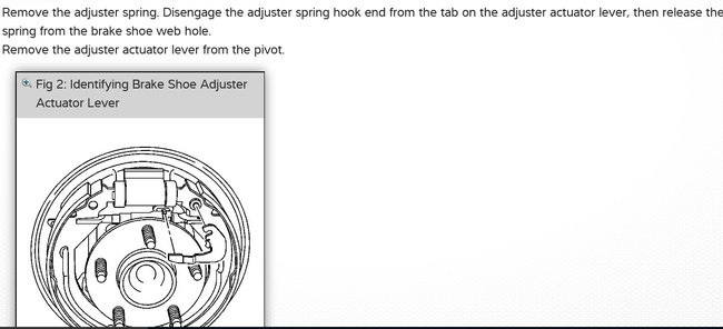

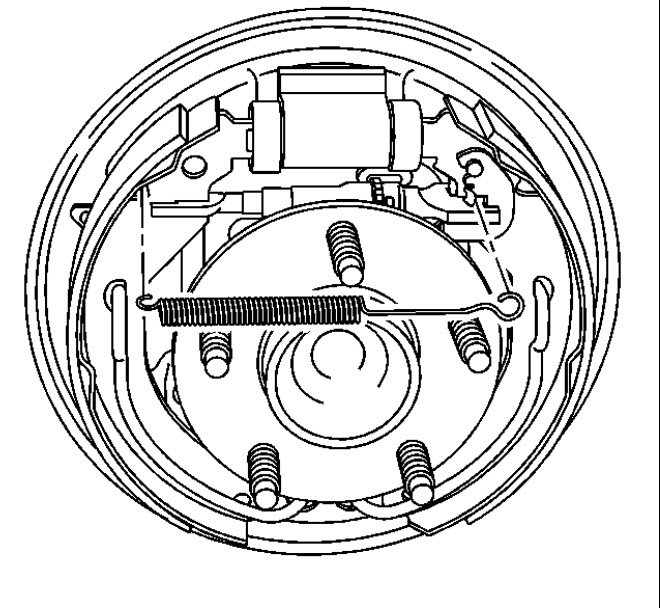

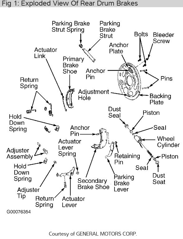

Thank you for your reply. After more research I have found that at sometime in the past the previous owner replaced the rear axle with an axle from a Pontiac Sunfire. I am swapping the shoes I purchased from an automotive store for the correct ones. Again, thank you for your help.
Feb 25, 2021 at 1:20 AM
HMAC300
  • 48,601 POSTS
maybe these pictures will help this is off a 2005 Sunfire.
JON SANDOVAL

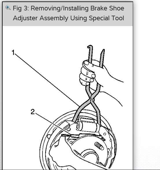

Thank you so much! That is the exact assembly! What is the name of that special tool for installing the shoes?
HMAC300
  • 48,601 POSTS
they call it a brake shoe spanner and spring remover it is a Kent more tool auto parts will have something like it probably like lisle or one to rent possibly it is not worth it to buy it. you can probably use dykes for the one spring removal and a screwdriver for other.
