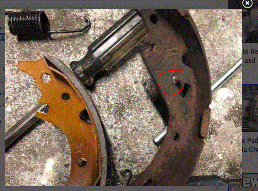

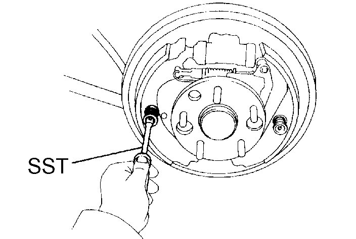

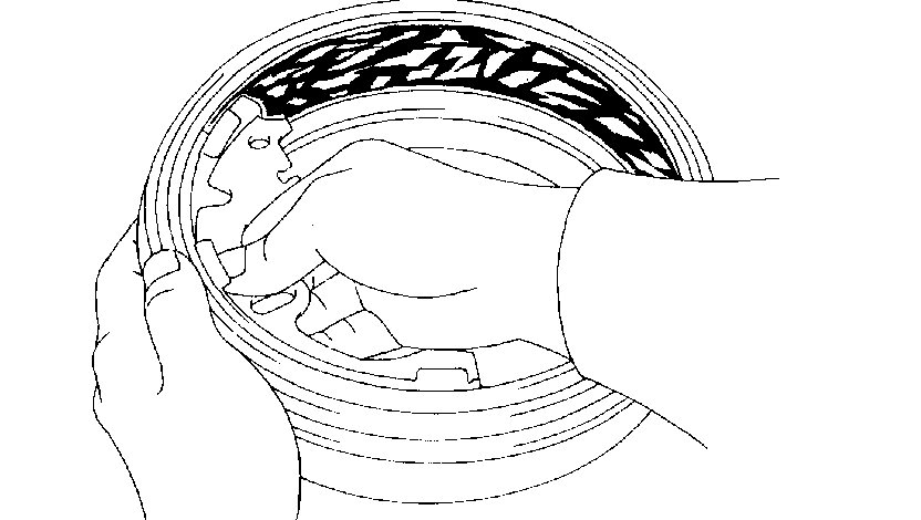

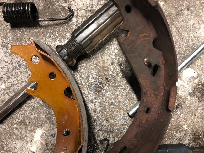

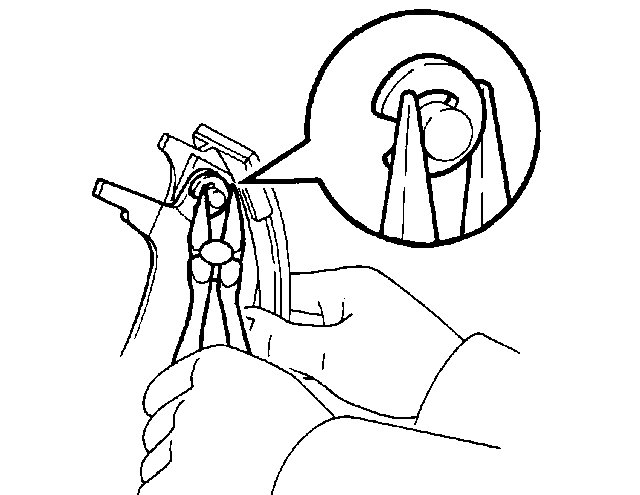

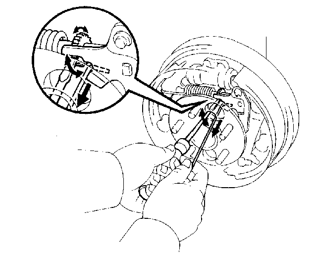

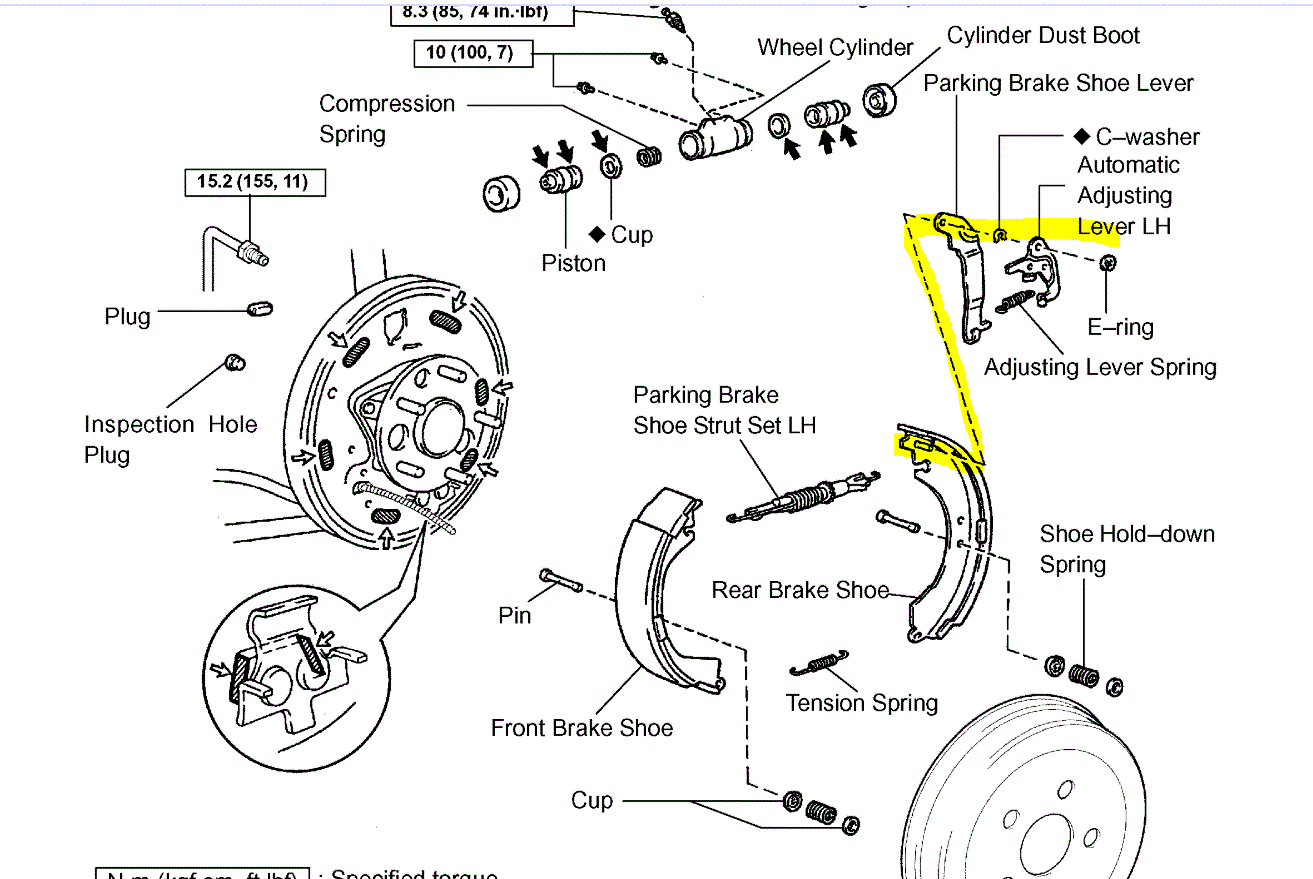

Trying to install new drums and shoes, but the shoes that come in the kit all look the same, one of them should have a built in or welded pin like the original, but none have it. can you see the picture and see the pin and tell me if there is a way around it?
Aug 1, 2020 at 11:17 AM
  • 110,251 POSTS

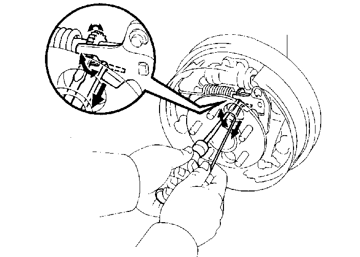

The shoe itself looks different. However, the pic I believe you are referring to is reused. You need to tap it out of the old shoe and then reinstall it in the new one. But the new one doesn't seem to have a location for it. There is usually a U shaped clip that holds it in.

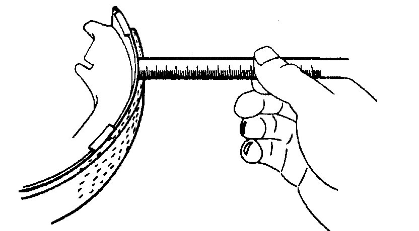

I copied your pic and circled what I believe you are referring to. Check to see if both of the new shoes are the same or if one has a location to reinstall that part. Pic 2 shows what I believe you are referring to as well.

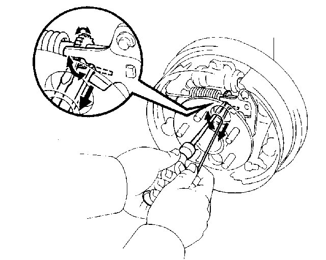

pic 3
REAR DRUM BRAKE
OVERHAUL
HINT:
^ Overhaul the RH side by the same procedures with LH side.

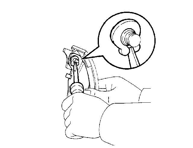

pic 4

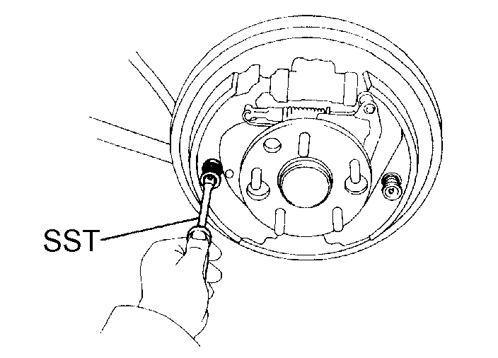

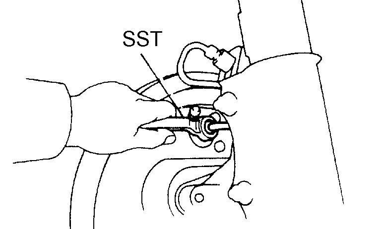

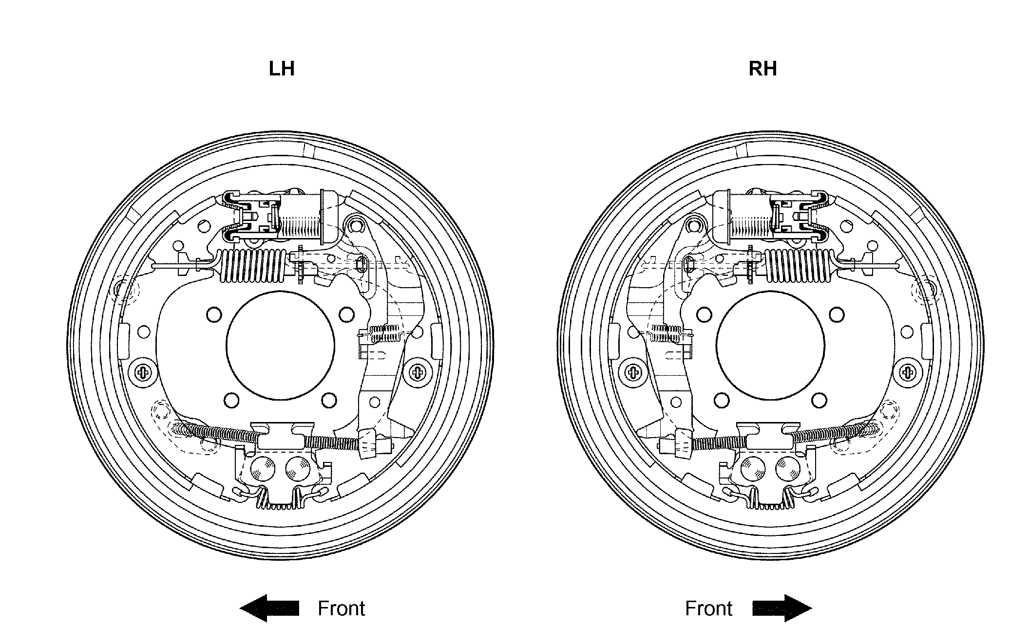

3. REMOVE REAR BRAKE DRUM SUB-ASSEMBLY
HINT: If the brake drum cannot be removed easily, do the following steps.
a. Insert a bent wire or equivalent through the hole in the brake drum, and hold the automatic adjusting lever away from the adjuster.
b. Using a screwdriver, reduce the brake shoe adjustment by turning the adjuster.
c. Remove the rear brake drum sub-assembly.

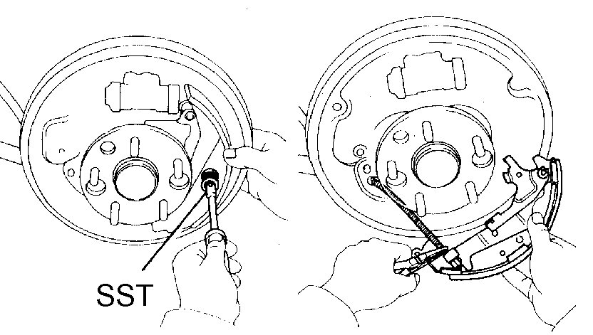

pic 5

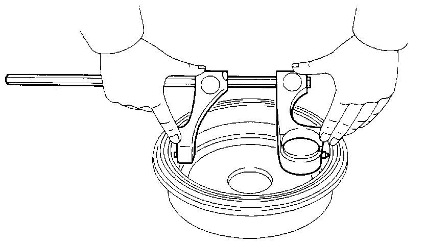

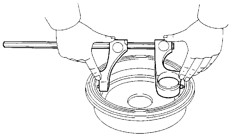

4. INSPECT BRAKE DRUM INSIDE DIAMETER
a. Using a brake drum gauge or equivalent, measure the in side diameter of the drum.
Standard inside diameter: 228.0 mm (8.976 inch)
Maximum inside diameter: 230.6 mm (9.079 inch)

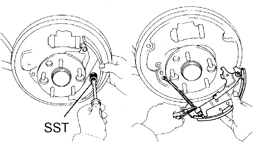

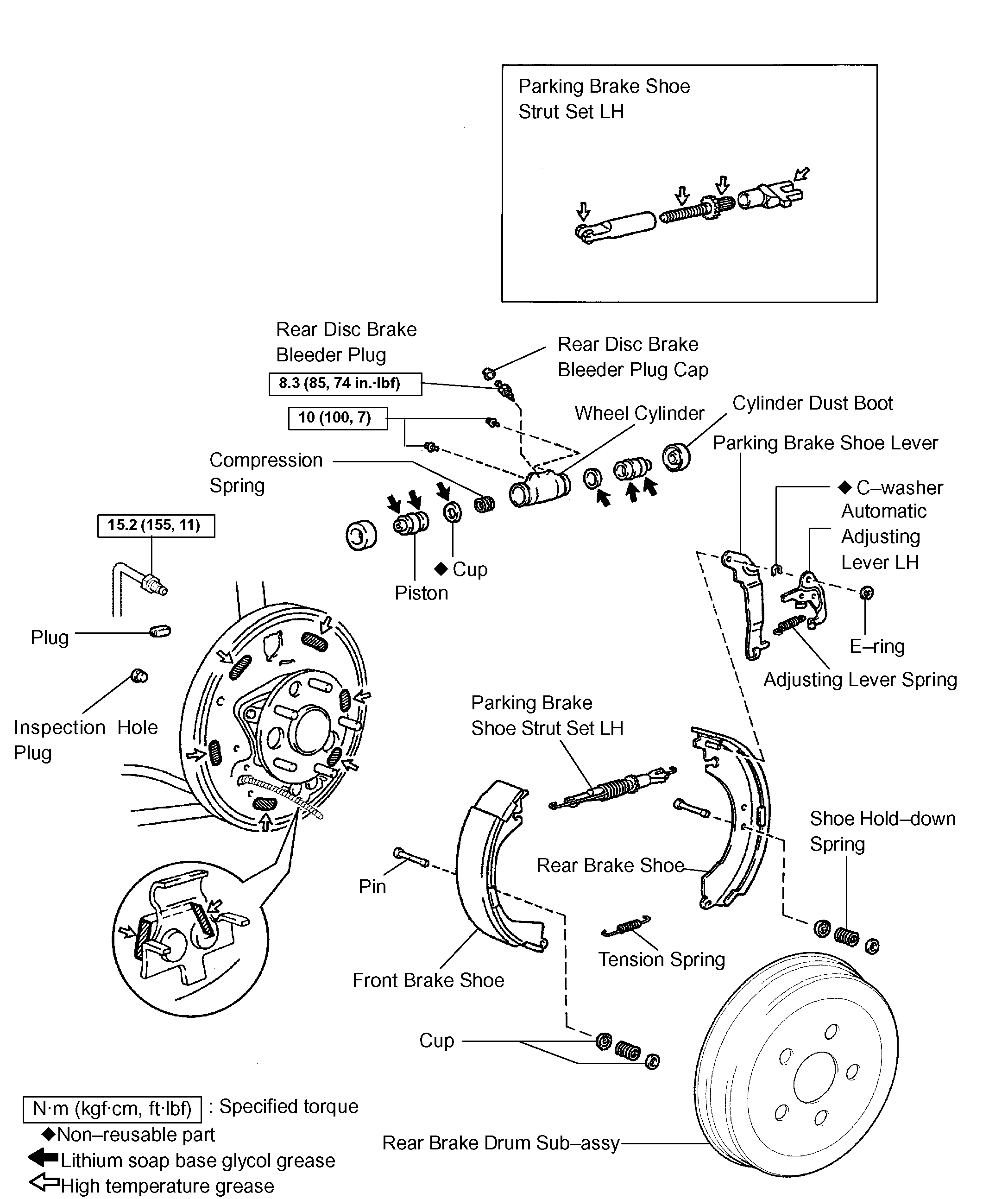

5. REMOVE TENSION SPRING
a. Remove the tension spring from the front brake shoe and rear brake shoe.

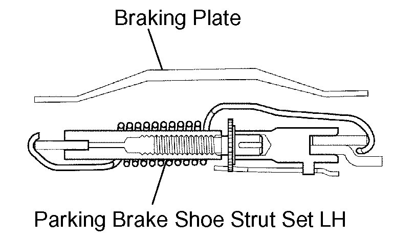

pic 6

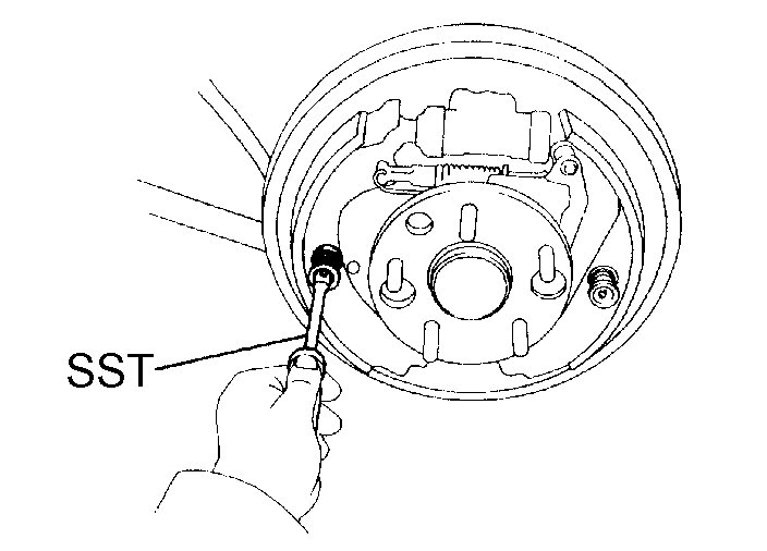

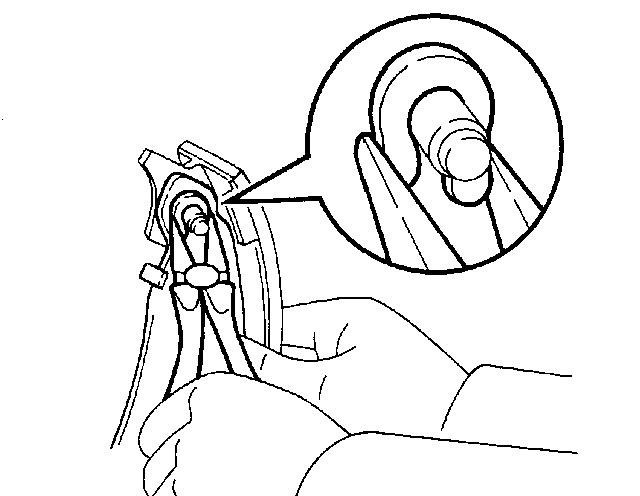

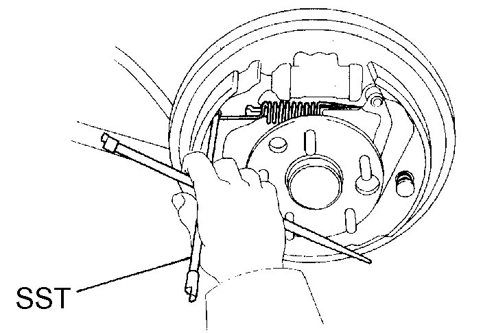

6. SEPARATE PARKING BRAKE SHOE STRUT SET LH
a. Using SST, disconnect the shoe return spring and separate the parking brake shoe strut set LH.
SST 09703-30010
NOTICE: Do not damage the wheel cylinder boot.

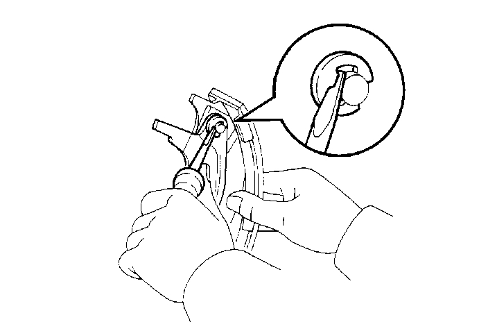

10. REMOVE REAR BRAKE AUTOMATIC ADJUST LEVER LH
a. Remove the adjusting lever spring.
b. Remove the E-ring.
c. Remove the automatic adjusting lever.

11. REMOVE PARKING BRAKE SHOE LEVER LH
a. Using screwdriver, remove the C-washer and parking brake shoe lever.

24. INSTALL PARKING BRAKE SHOE LEVER LH
a. Install the parking brake shoe lever with a new C-washer.

Yes, you circled it right. but what's in pics 15 is different. i have already removed that from the old shoe. this one you circled is from the left shoe it can't be removed.
Mar 5, 2021 at 2:11 AM
  • 110,251 POSTS
It should come out or the new shoes should have come with a new one to install. I'm looking at the two shoes in your picture and there isn't a location to place that part in the new one. Are you certain you have the right shoes?
