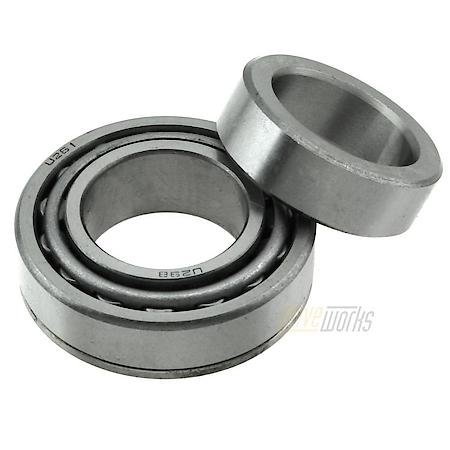

so is this what i need? it's listed as a rear wheel bearing. and the way to remove the old one is the use a drill press and then cut it off somehow? Not looking forward to that part of the project.
Apr 1, 2018 at 5:58 AM
STEVE W.
  • 15,257 POSTS
Those and the axle seal itself. It sounds bad but the ring on top is the item you drill into, then hit it with a chisel to split it and take it off.
Check the axle tag before you order parts Jeep used a couple rear ends in those.
