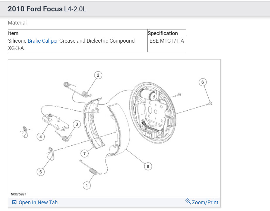

I recently saw your video titled "How to Replace Front Brake Pads and Rotors Ford Focus 2008-2011 - EASY!" and it was very informative and helpful. Do you have a video, or can you recommend a video for how to replace the rear brakes for the car listed above? I found some tutorials for different models/years, but I'm unsure how much overlap there is in functionality/parts. Thank you, Kristopher
May 30, 2023 at 2:34 AM
  • 55,694 POSTS

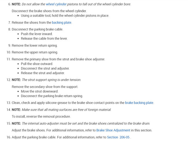

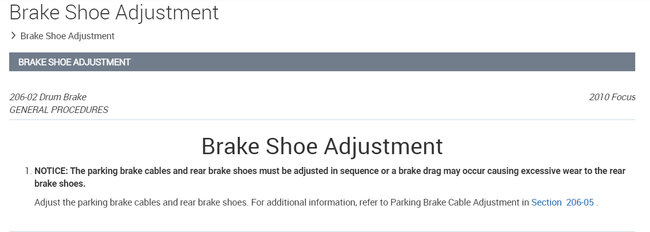

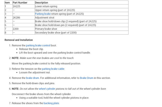

Here is the brake video in question and I have included instructions for your car in the images below:
https://youtu.be/1j7qDoi1LP0
Check out the images (below). Please let us know if you need anything else to get the problem fixed.
