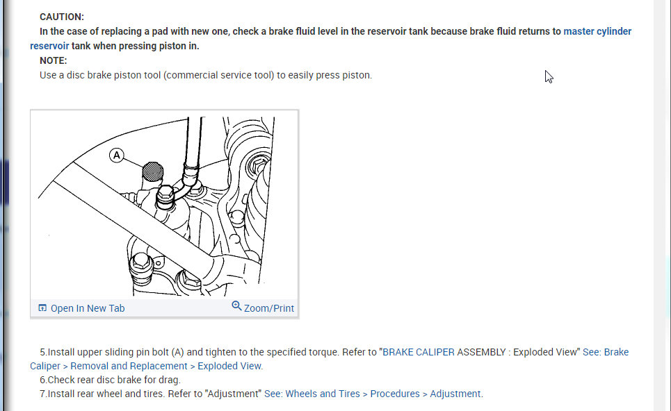

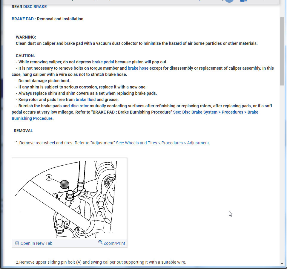

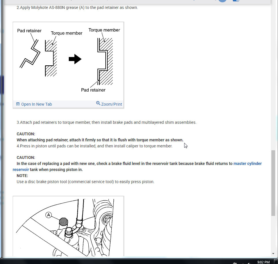

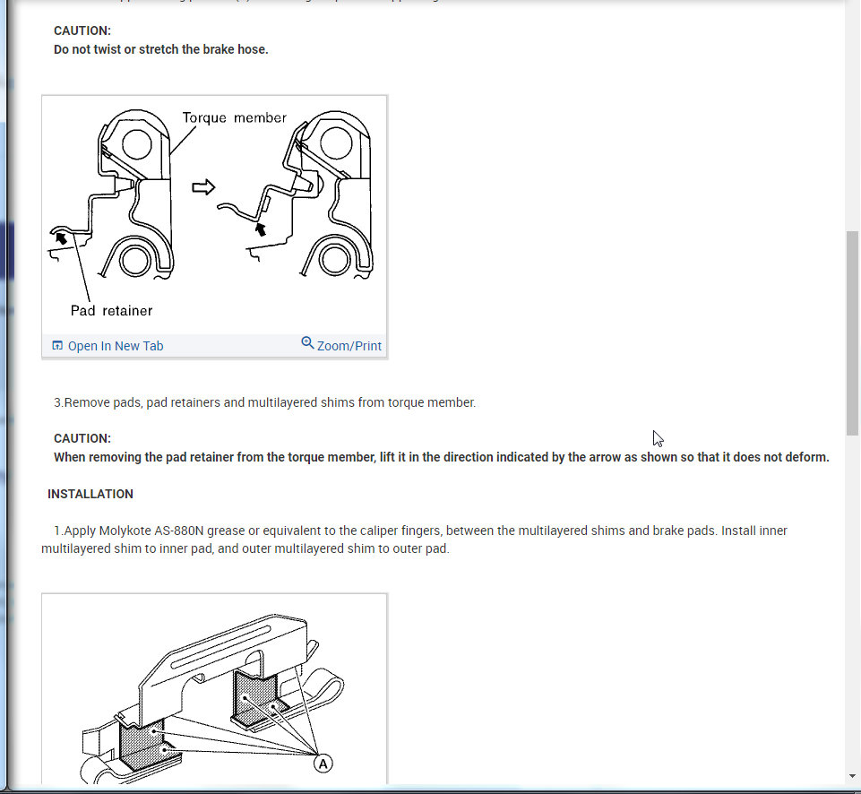

I am attaching the process below on how to replace the pads so you can review just to make sure you performed the repair properly.
However, before you go through any major processes, how much have the pads worn? Did you measure them? How long as it been since you installed them?
