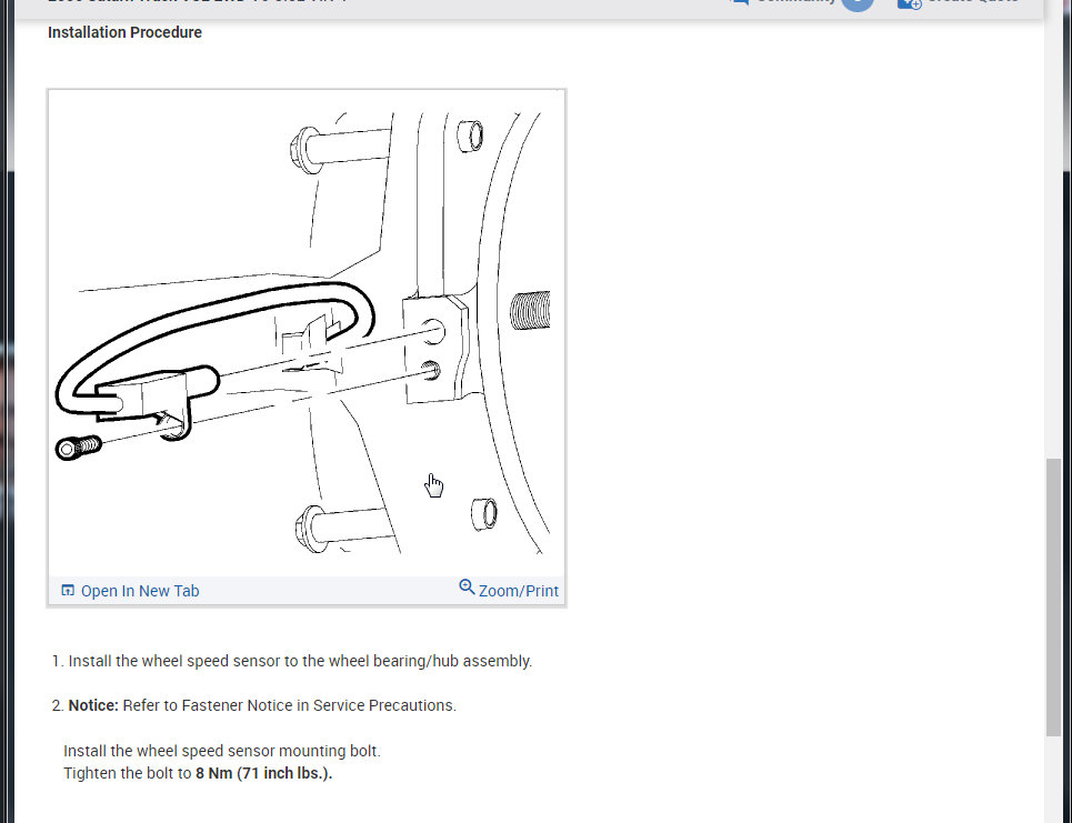

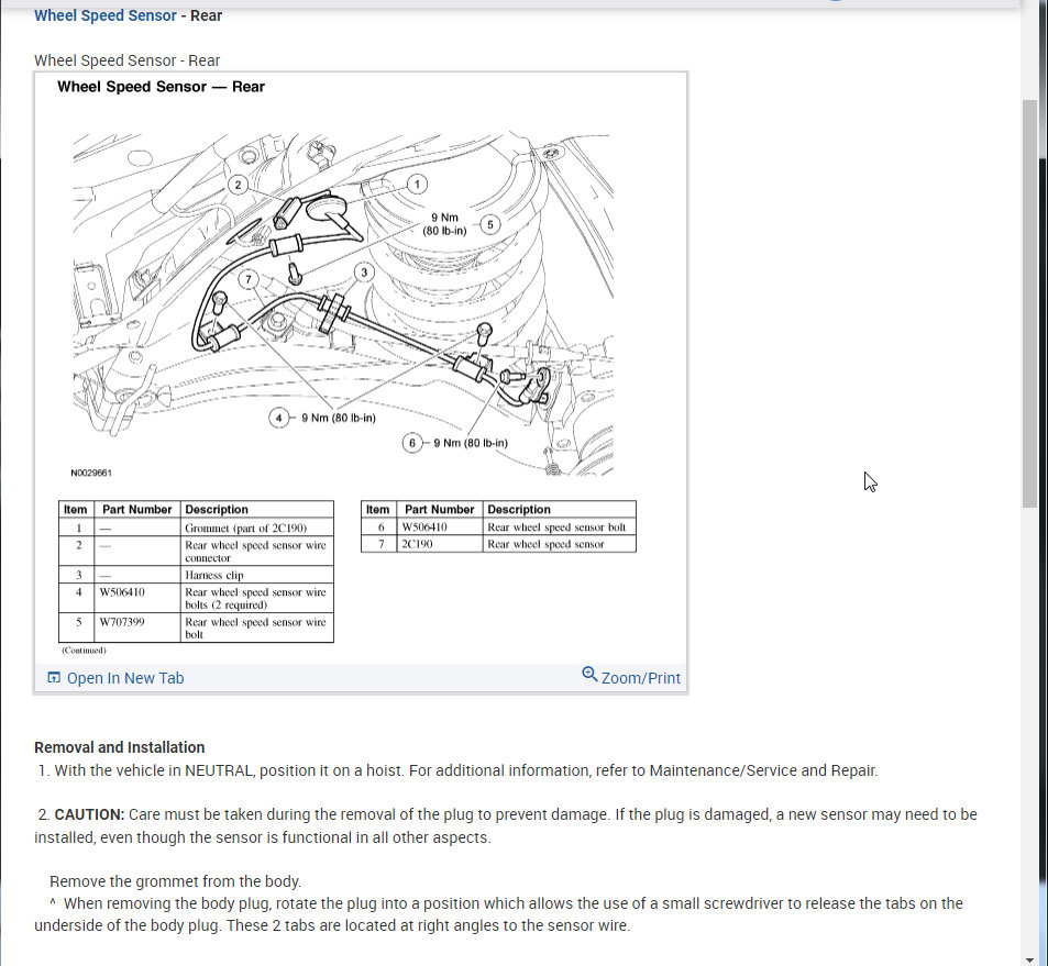

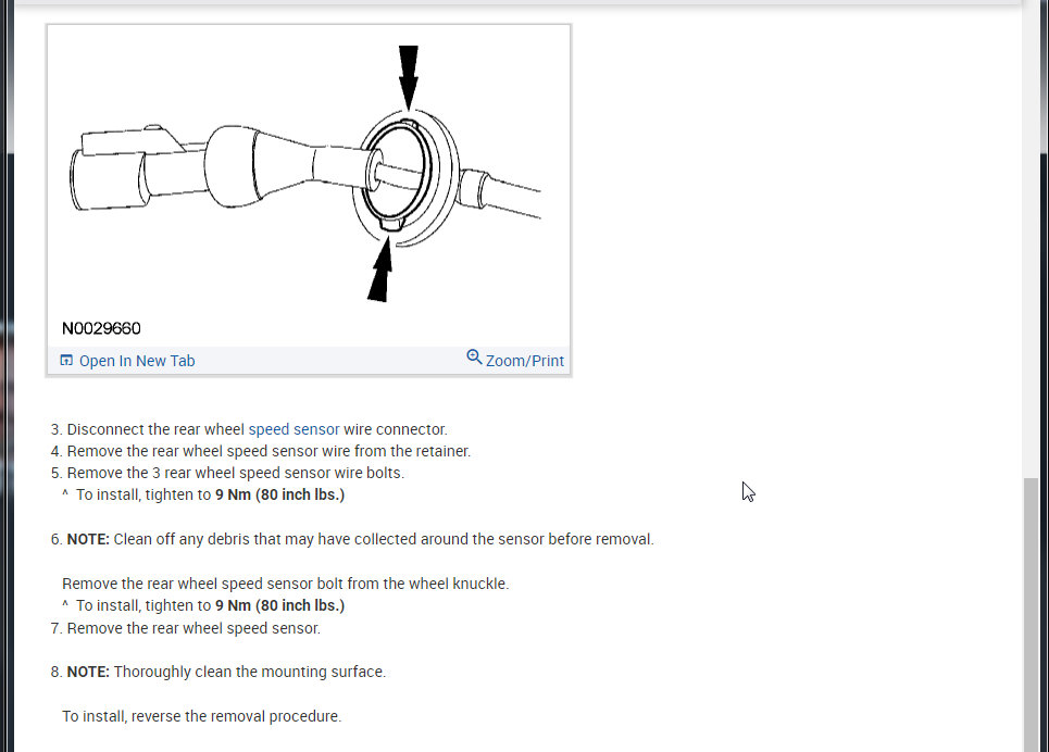

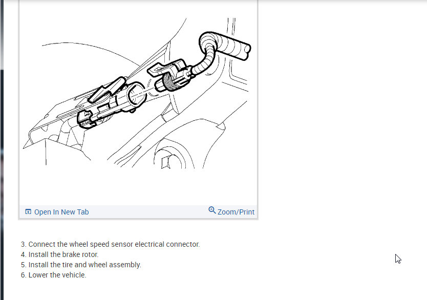

Changing passenger side, rear caliper on my vehicle listed above XLT model. I need to know how to change out the wheel speeds sensor? Any help is appreciated. Thanks!
Sep 15, 2018 at 1:25 AM
Sure. Here is a guide that will help with this as well:
https://www.2carpros.com/articles/how-to-replace-an-abs-wheel-speed-sensor
Plus below you will find the process from the manual that will give the needed info. Please review this and let us know if you have other questions. Thanks
