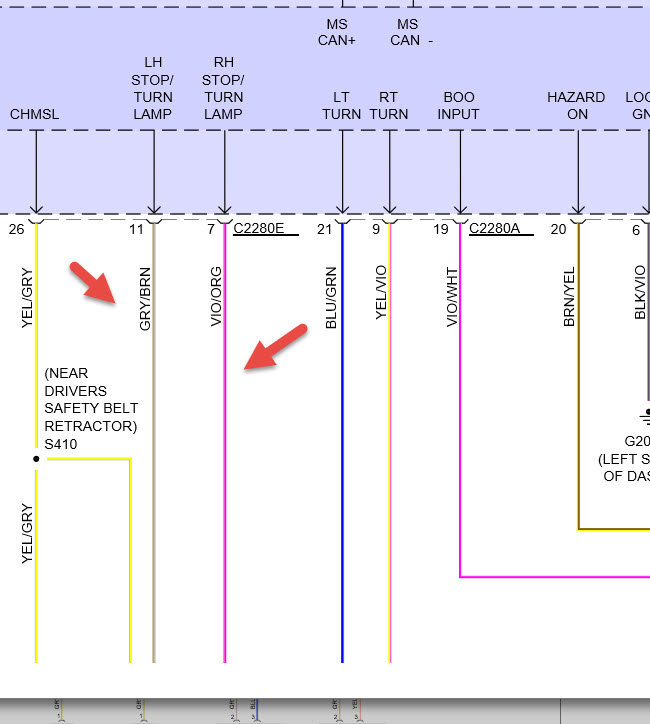

check wires leading from smart junction box in pic if no power there with brake applied then you'll have to have it scanned to see if sjb is bad as it's a module.

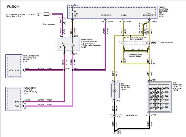

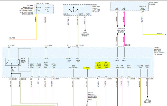

Power for the brake lights, signals, and the center high mounted brake light are all powered via the smart junction box (SJB). Now, if the third brake light is working, then we know power is getting to the SJB and the brake light switch is working.
What you need to do is at the SJB, check the gray/brown wire and the violet/orange wire for power when the brakes are applied. I attached a pic below. Note that the yellow/light gray wire is for the 3rd brake light. (see pic 1)
Now, if there is no power from the SJB on those wires, the SJB is the likely cause.
Try this and let us know if you have other questions or need help. Also, if possible, let me know the results.

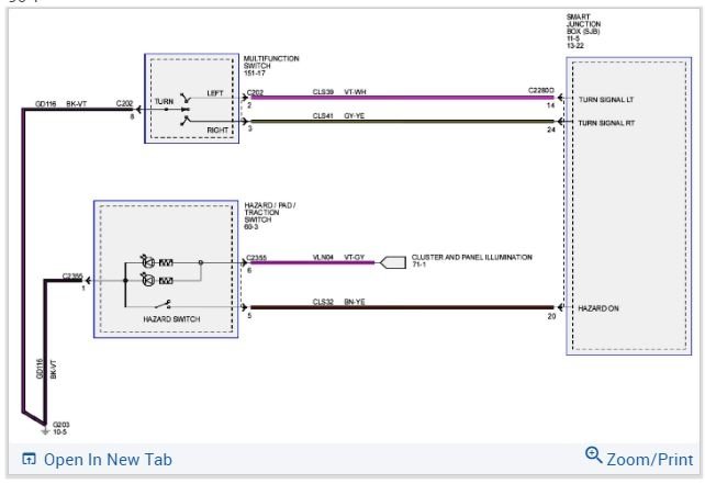

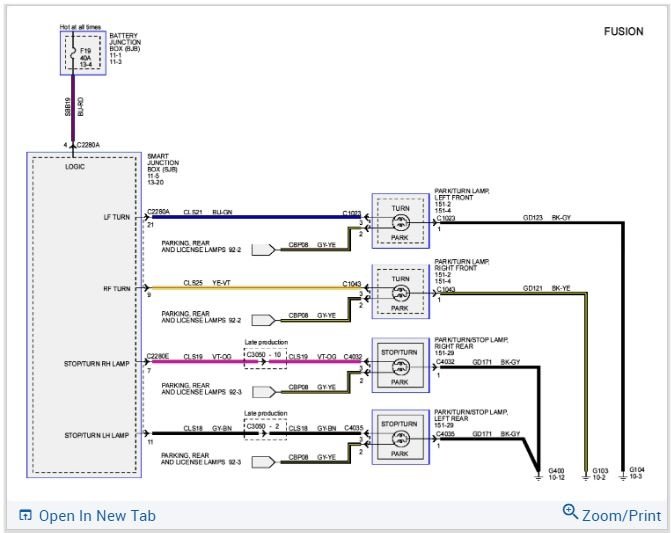

When you say the blinker is out in the rear do you mean completely? it does not light at all? What about the front drivers turn signal, is that functioning normally? What happens on the dash does the indicator on the dash light up at all? If the front is working fine and the back not at all the issue is going to be right at the bulb, socket or the wire leading to the bulb most likely. Let me know, Here are the electrical diagrams for that circuit. Take a look if you have any questions about it let me know.
