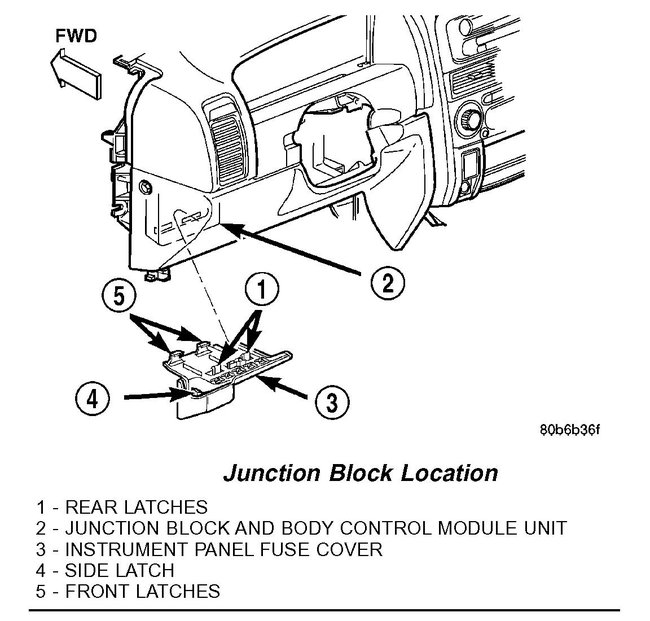

When you step on the pedal, no brake lights come. I do have brakes, all blinkers work and rear lights all turn on.
Oct 17, 2018 at 1:07 AM
CARADIODOC
  • 34,331 POSTS

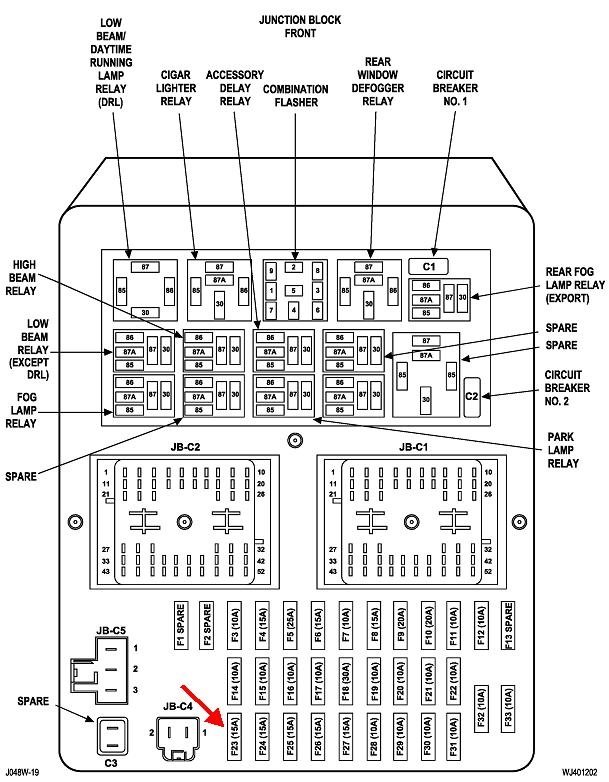

While it is possible to have all three bulbs burned out, that is not very likely. If the center brake light also does not work, the best suspect is the brake light switch. There is also a blue, 15-amp fuse dedicated just for this circuit, so check that first. That is fuse # 23 in the fuse box on the left side of the dash.
