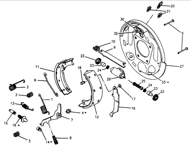

The self adjuster on the right side should have the reverse threads. I would confirm that first. Here is an exploded view of the brake show assembly so you can make sure there are installed correctly. Here is a video that will help as well.
https://www.youtube.com/watch?v=-Ts8SRUxRc8
Check out the images (below). Please upload pictures or videos in your response

Cheched the Self Adjuster and everything is installed correctly.
