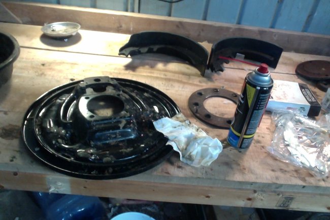

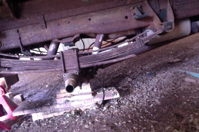

#1. down to the axle housing(?) axle is in two parts on the wall.
how to fill with what? do the lines need to be replaced? has there been anything else removed?

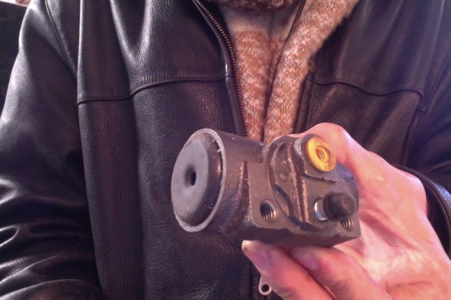

#2 cleaning chicken droppings off the brake case(name?) fresh drums a semi rusted hub spacer (name?)

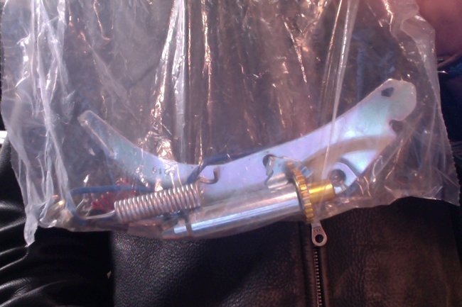

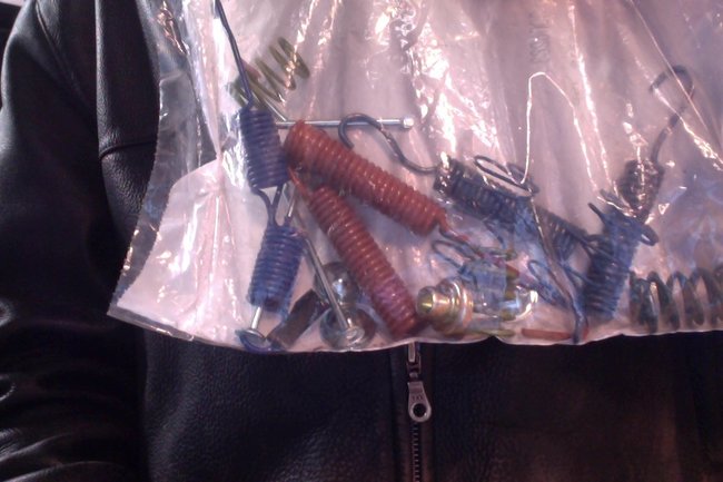

#3 unidentified
#4 unidentified
#5 unidentified.
I am trying not to walk away from this as I want to impress my new boss, however, i never worked on drums before, I can confidently say that with the aforementioned Youtube video, install all that is needed. To the extent of my knowledge, i am missing the bearing, washers, keys.
Would you ID the parts here, and assess what else i need? Assume what you see is what is here.

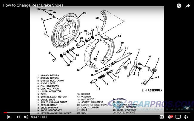

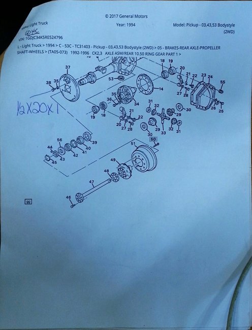

Hello Ken. Checking in. I finally started going over the parts after self educating myself. i found that we are missing the 4 bolts of the PLATE BACKING to fasten it to the AXLE ASSEMBLY. would you be able to know where I can find this information?
Could you send me what bolt size/thread it is? i would like to pick it up from the Hardware store.
Nov 14, 2017 at 9:23 AM
ALSHABBAB
  • 10 POSTS
Here is a screenshot from the posted video
Nov 14, 2017 at 9:24 AM
  • 54,840 POSTS
You should be able to tell by checking the hole size for the bolts probably 3/8 by 1 inch.

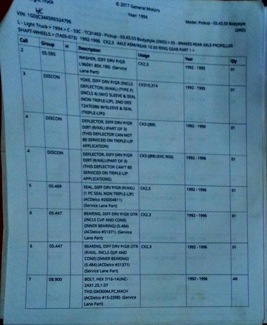

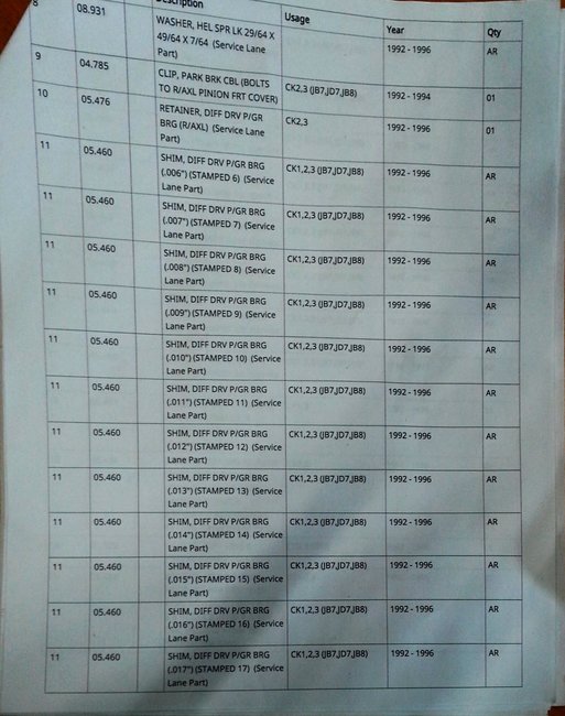

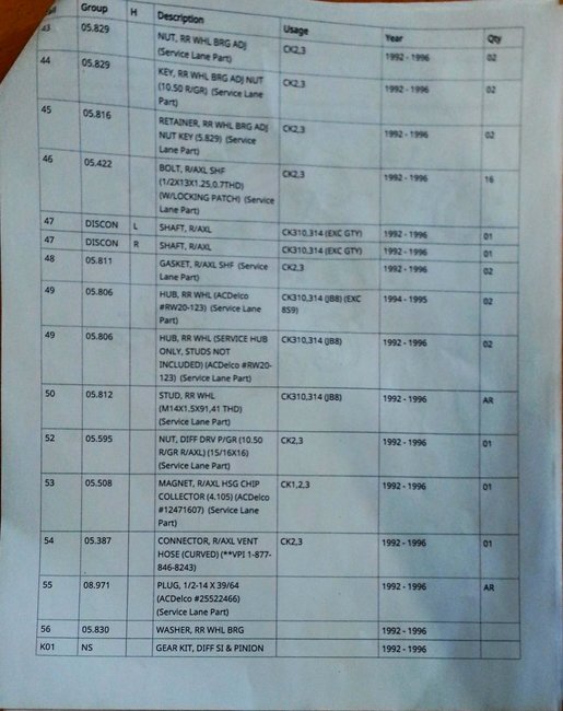

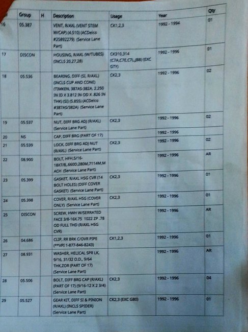

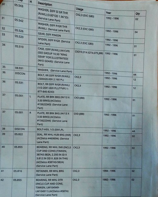

Closing statement: I went to the dealership with the VIN. the car is a 94 GMC. they did not have some of the bolts. most of the parts are available. They DID however pull a schematic of an exploded rear brake system. with a numbered parts list. I need to bend new lines to the wheel cylinders, assemble the plate, shoes, seizing mechanism, axle. fluids, etc etc. I can post the paperwork if requested, so others can see this. have a blessed Holiday. Thank you -Alex.
Nov 25, 2017 at 11:42 AM
  • 54,840 POSTS
Hey Alex, Yes please post any information you have on this job so if anyone else needs it they can see what we are talking about.
Nov 26, 2017 at 1:56 PM
ALSHABBAB
  • 10 POSTS
1. Screenshot from aforementioned YouTube,
2. Scan of Rear Brake System, courtesy of Ford Dealership in Liberty NY.
3. PARTS LIST. many generic items can be furnished from ace. like #35,37 bolts, washers for reasonable price.
they are not on pdf, the data is legible.
Nov 27, 2017 at 9:31 AM
