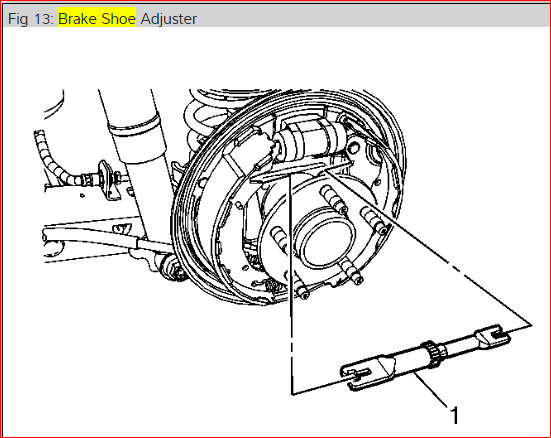

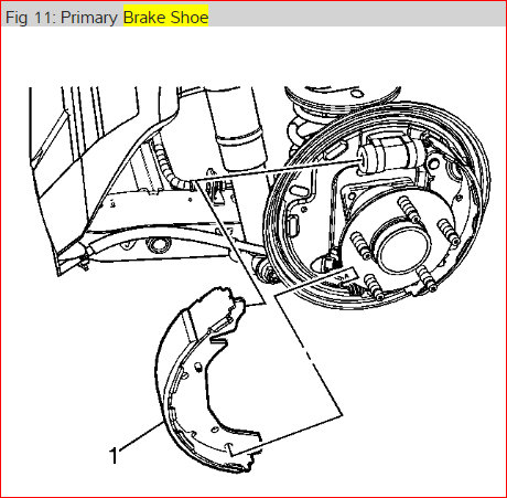

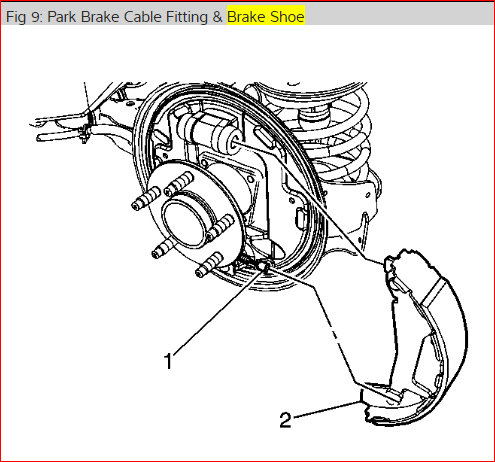

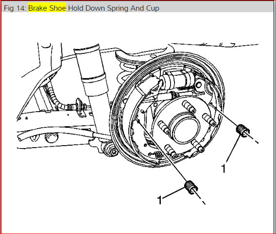

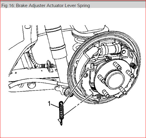

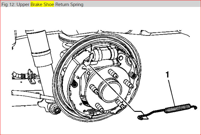

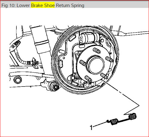

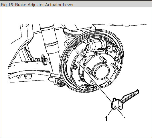

Do you have a diagram on how the back brakes reassembles?
Jul 20, 2018 at 11:07 PM
DANNY L
  • 5,648 POSTS
Hello, I am Danny.
Are the rear brakes disc or drum? Here is a guide to help you step by step with instructions in the diagrams below to show you how on your car.
https://www.2carpros.com/articles/how-to-replace-rear-brake-shoes-and-drums
Here are about eight different pictures attached showing various components being highlighted/installed in order. Hope this helps and again thanks for using 2CarPros.
