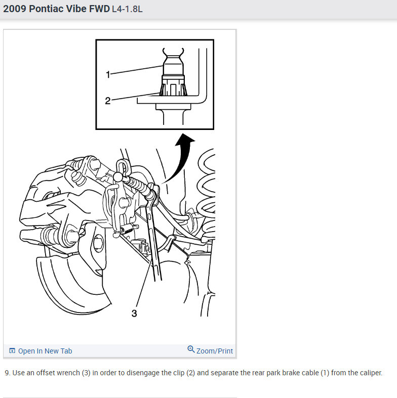

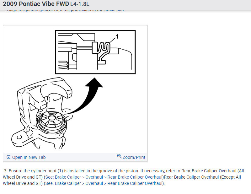

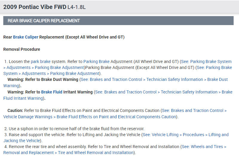

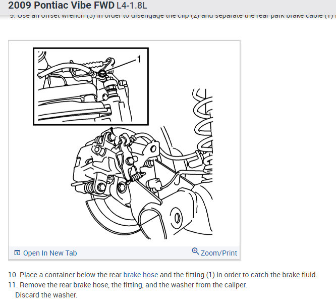

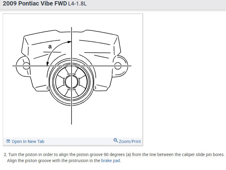

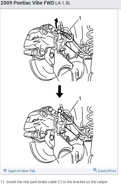

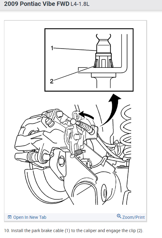

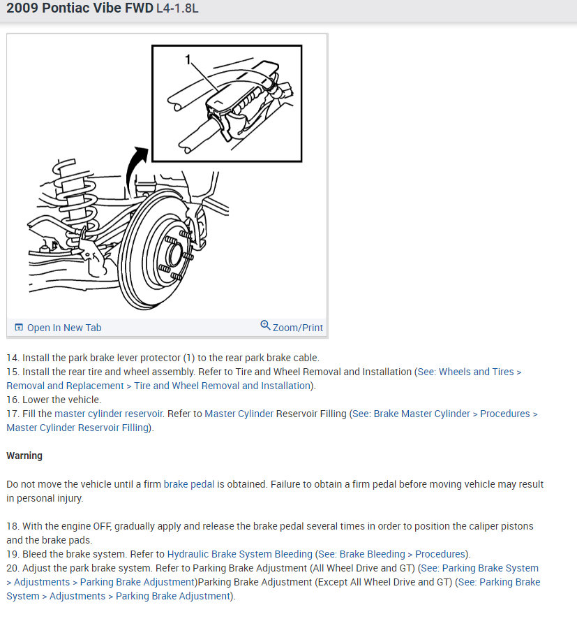

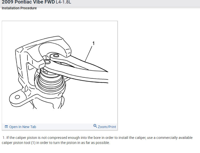

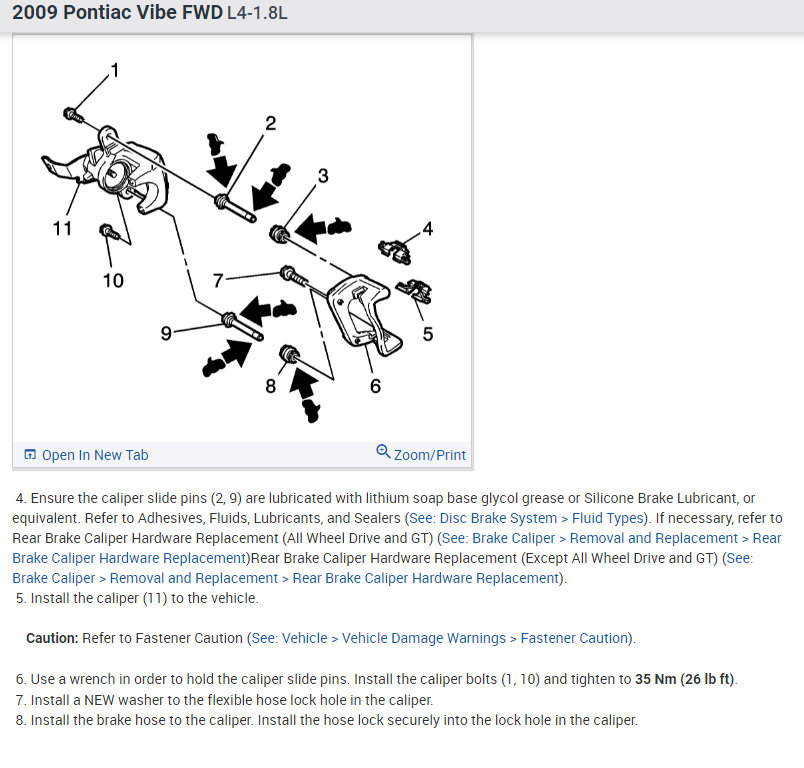

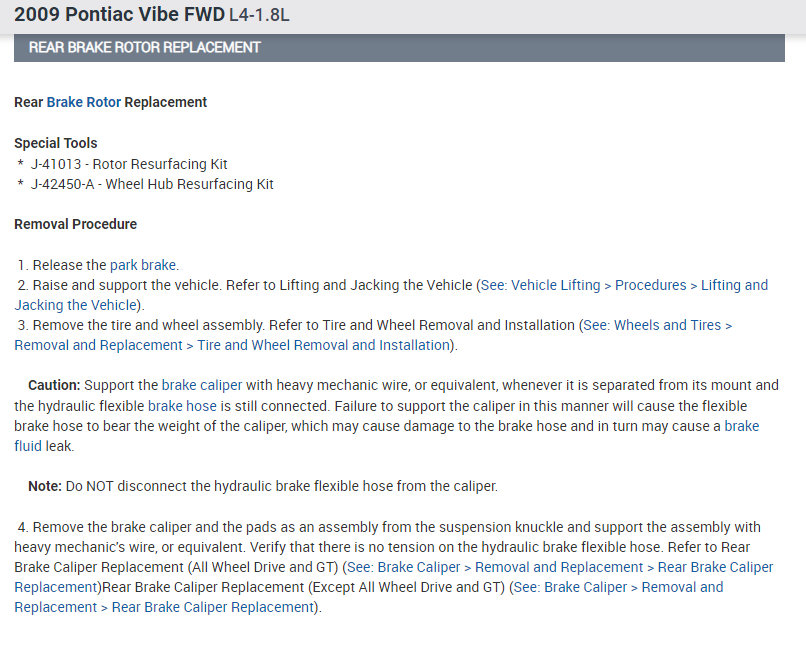

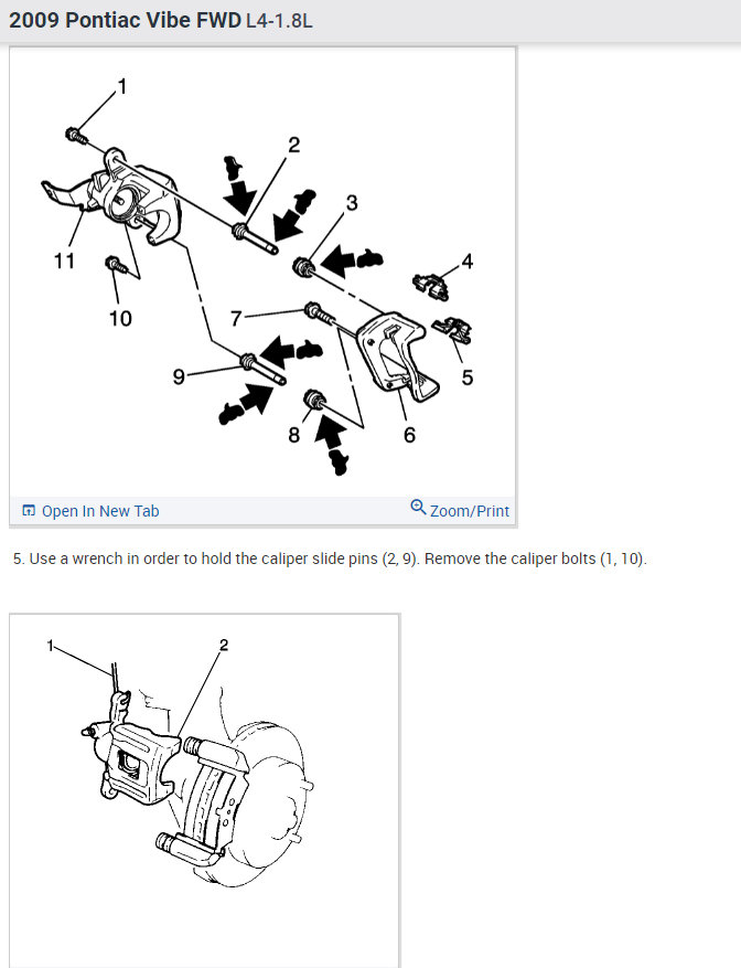

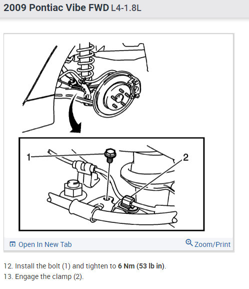

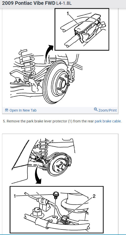

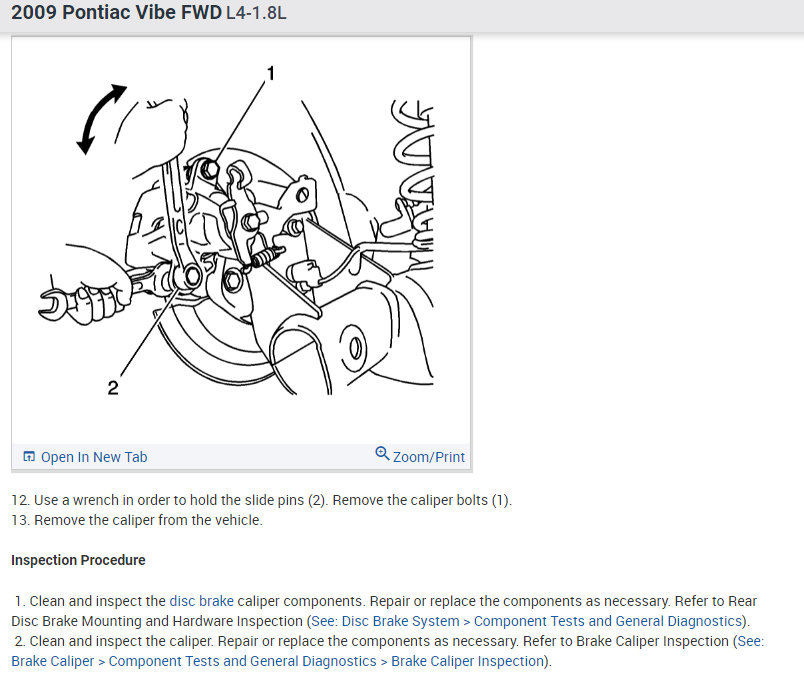

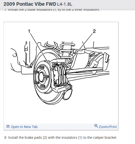

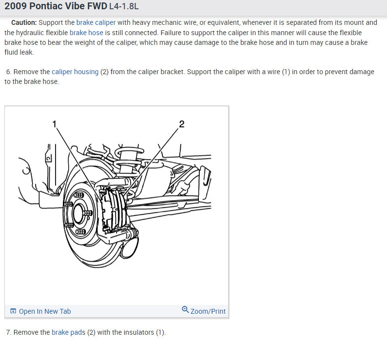

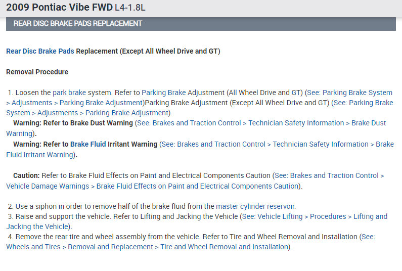

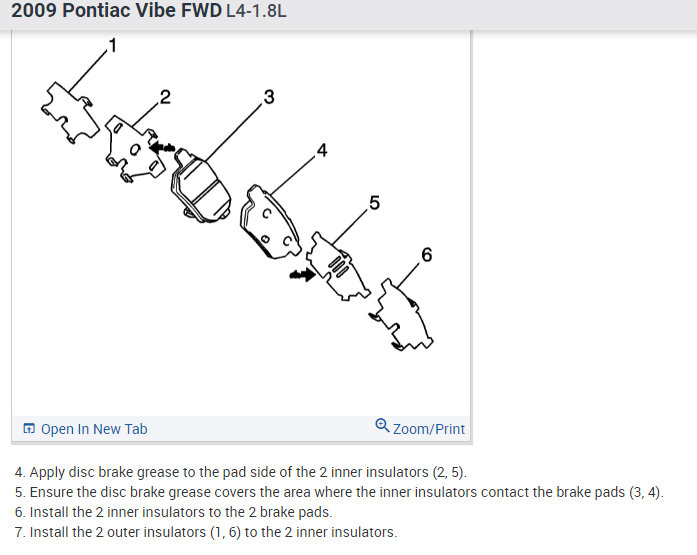

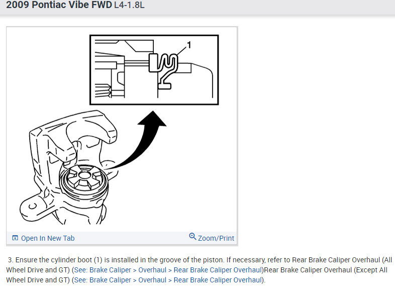

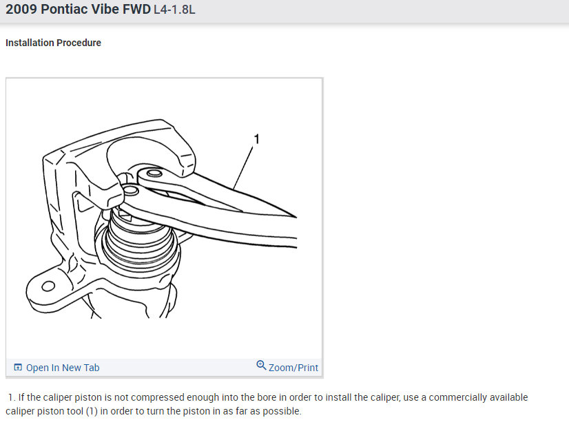

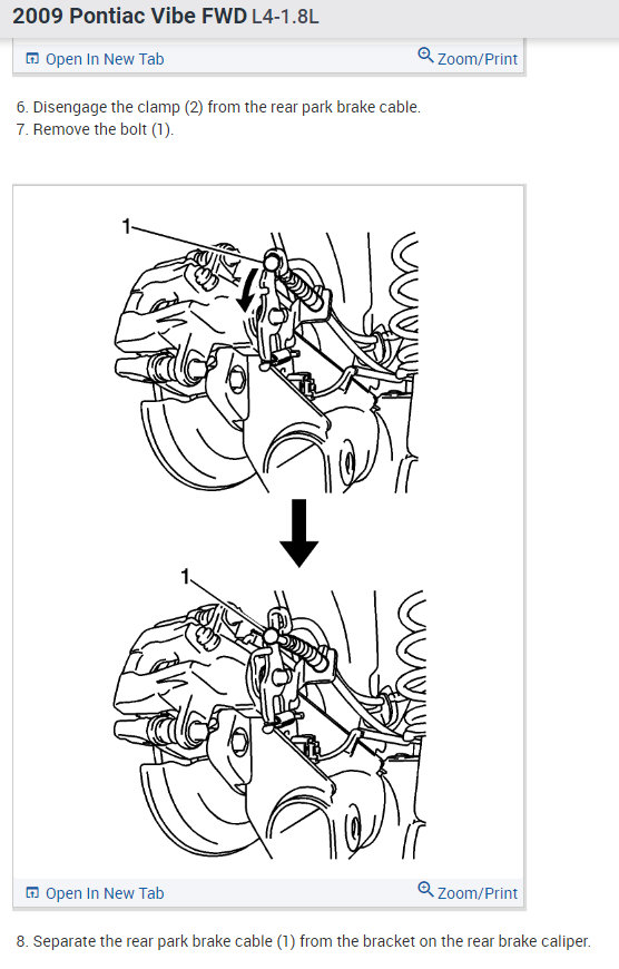

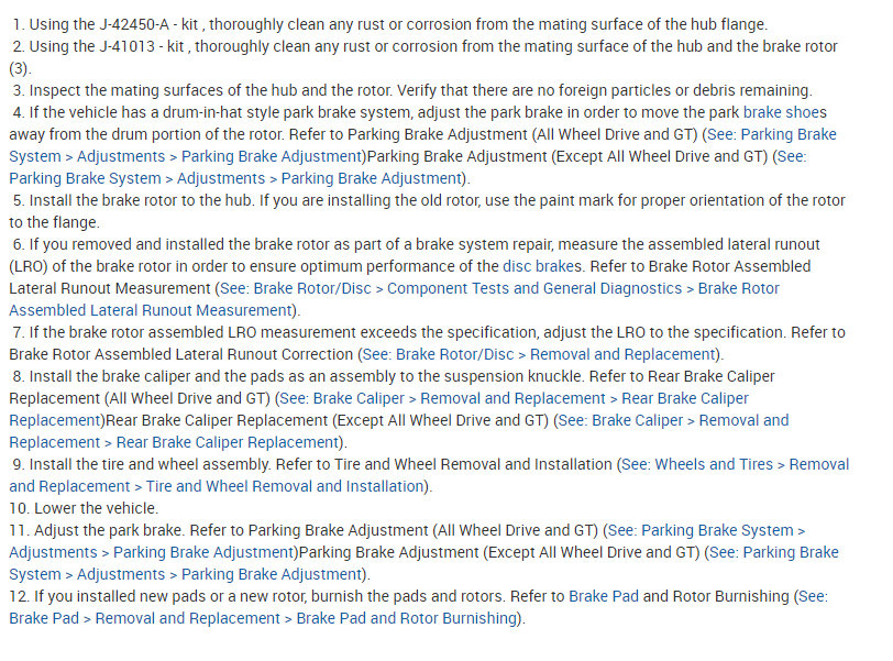

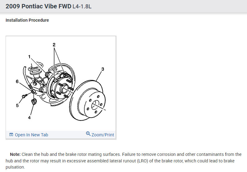

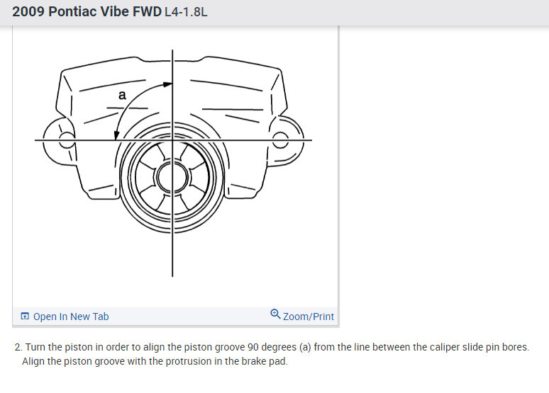

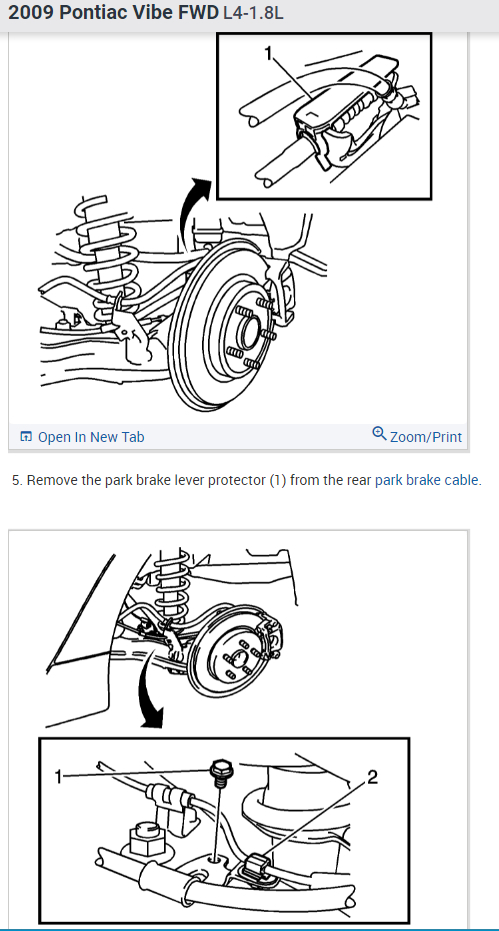

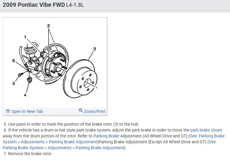

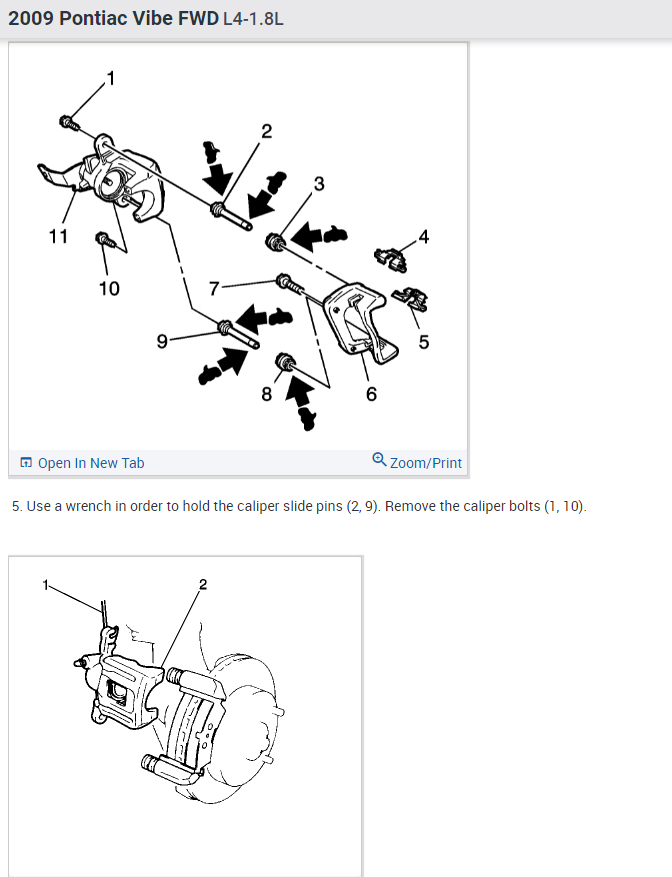

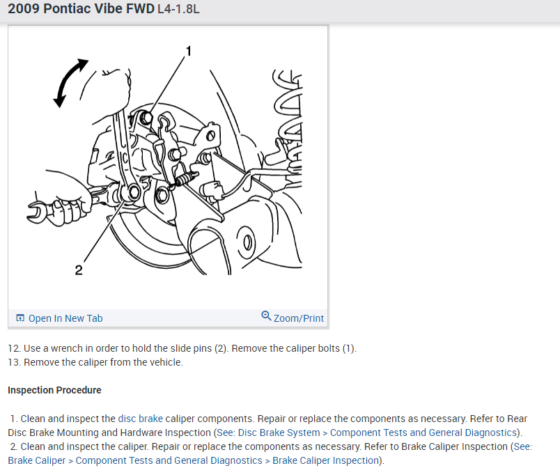

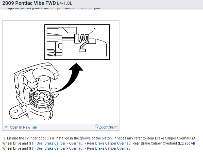

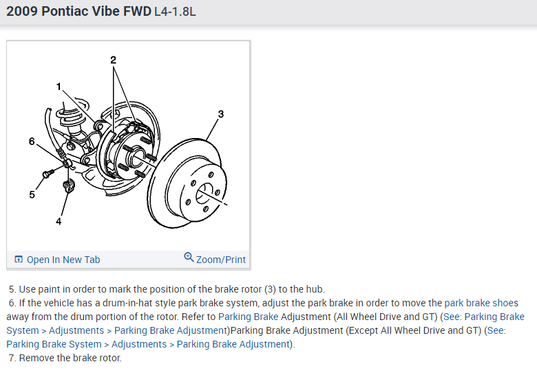

Have the tools and I want to replace the brake caliper
Feb 26, 2018 at 10:05 PM
SQM
Experienced Mechanic
6,383 POSTS

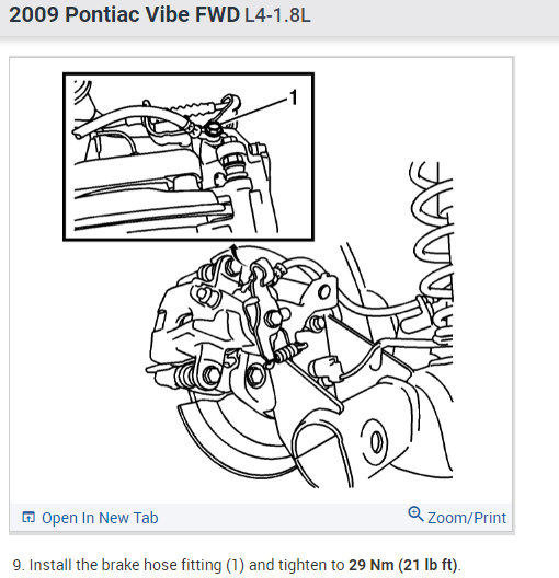

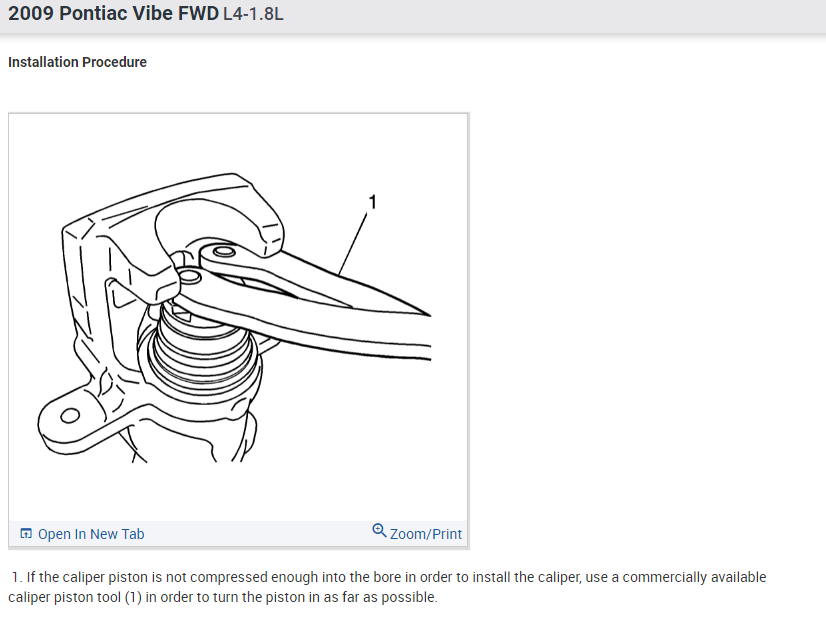

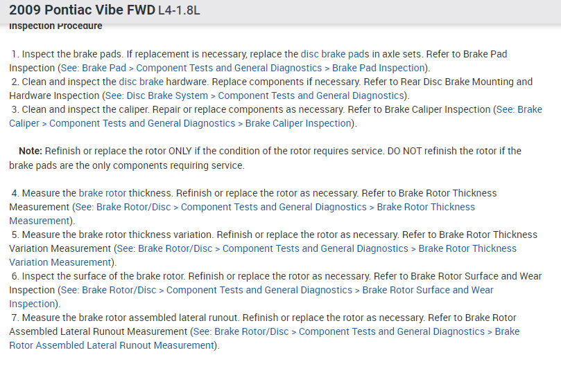

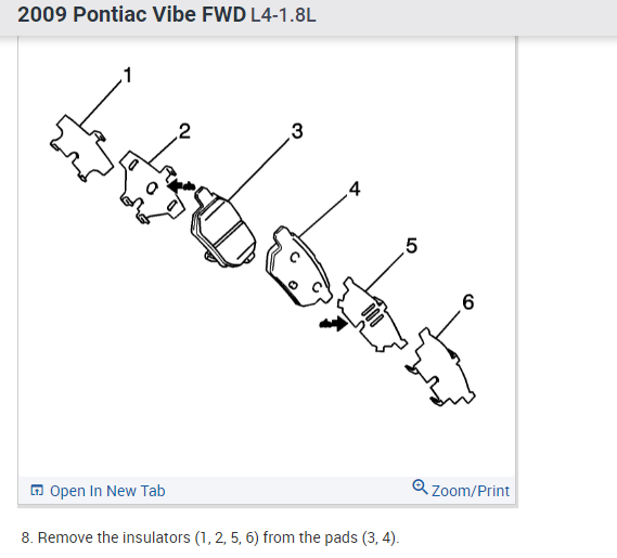

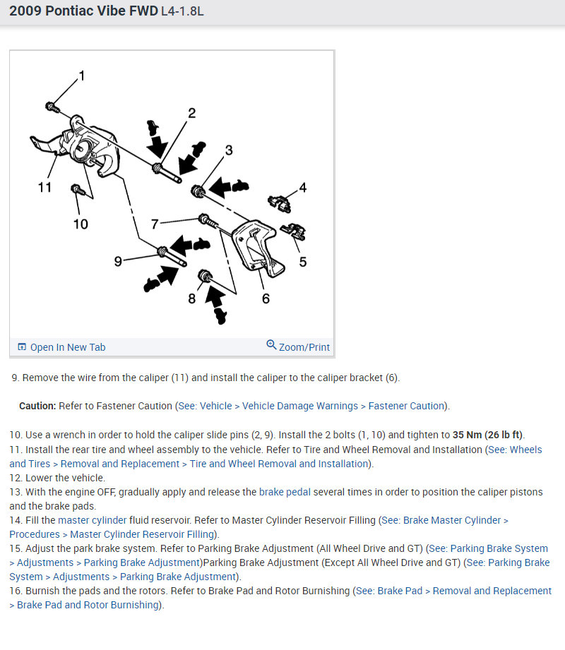

I have attached the complete rear brake replacement procedure including the pads, rotors, and calipers.
You will have to use the special tool to retract the piston back into the housing.
Here is a helpful video:
https://youtu.be/j8YwfSKEzZo
https://www.2carpros.com/articles/how-to-replace-rear-brake-pads-and-rotors
