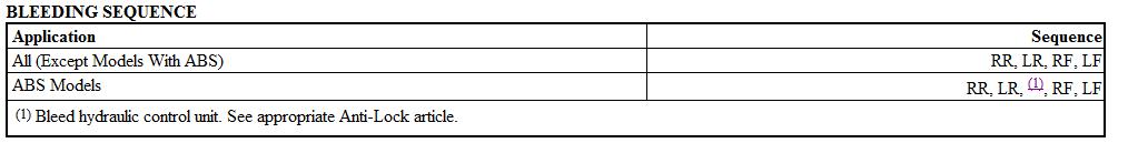

Trying to find out what the bleed sequence is for a 2001 ford ranger.

Bleed as per chart in pic hydro boost unit should self bleed with brakes.
