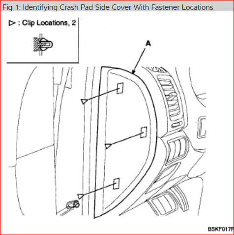

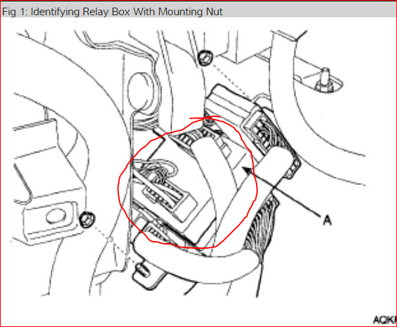

I have no power to rear blower motor, fuse in engine compartment okay. Looking for rear blower motor relay.
Jul 22, 2018 at 2:45 AM
DANNY L
  • 5,648 POSTS
Hello, I am Danny.
The blower motor relay box is located in the dash behind the crash pad cover. I have attached two pictures showing their location and description. I have also attached a link on how to test a relay. Hope this helps and feel free to ask any questions if needed. Thanks for using 2CarPros.
