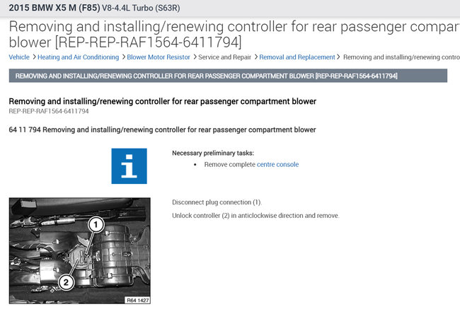

After the vehicle is turned off the blower in the rear continues to run. I tried turning engine on and off but still running.
Sep 30, 2022 at 3:04 PM
  • 55,748 POSTS

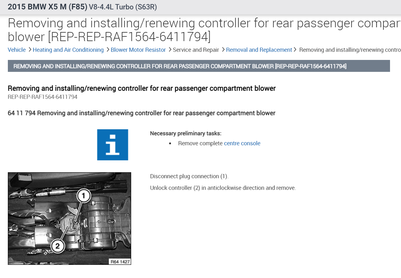

Yep, this happens when the rear blower speed control module burns out. here is the location so you can change it out. Check out the images (below). Please let us know if you need anything else to get the problem fixed.
