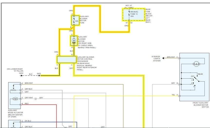

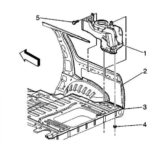

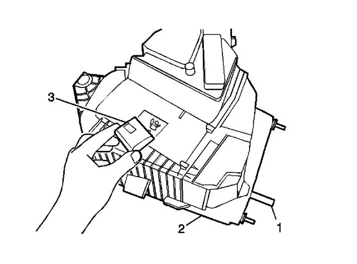

My rear blower motor for heat or A/C has never worked. When i turn the fan speed knob to any setting nothing happens. Was hoping you had an idea as to what i needed to check. I thought maybe rear blower motor resistor but don't know where this one is located even if this is the problem. Any advise and help would greatly be appreciated.
Apr 29, 2020 at 7:45 AM
Good evening,
I will attach the wiring diagram and the location for you to view. You will need a test light or voltmeter to do some quick tests.
The blower is common for failure but the reason it fails is from the blower motor drawing too much current.
It is in the right rear compartment under the trim panel. I attached some pictures for you.
