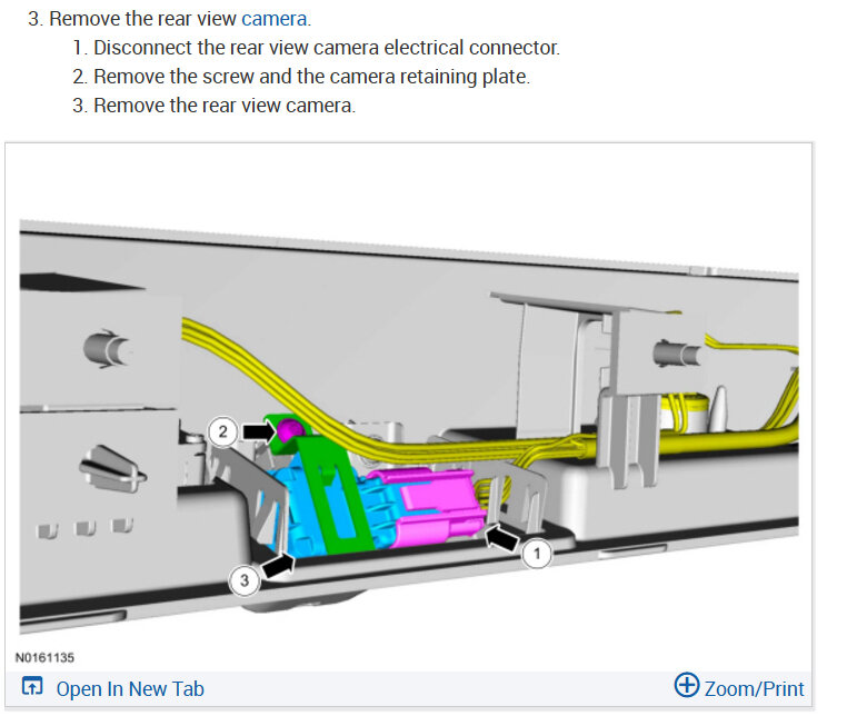

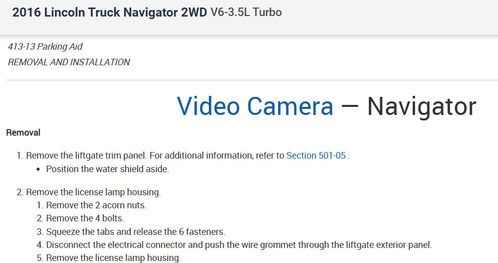

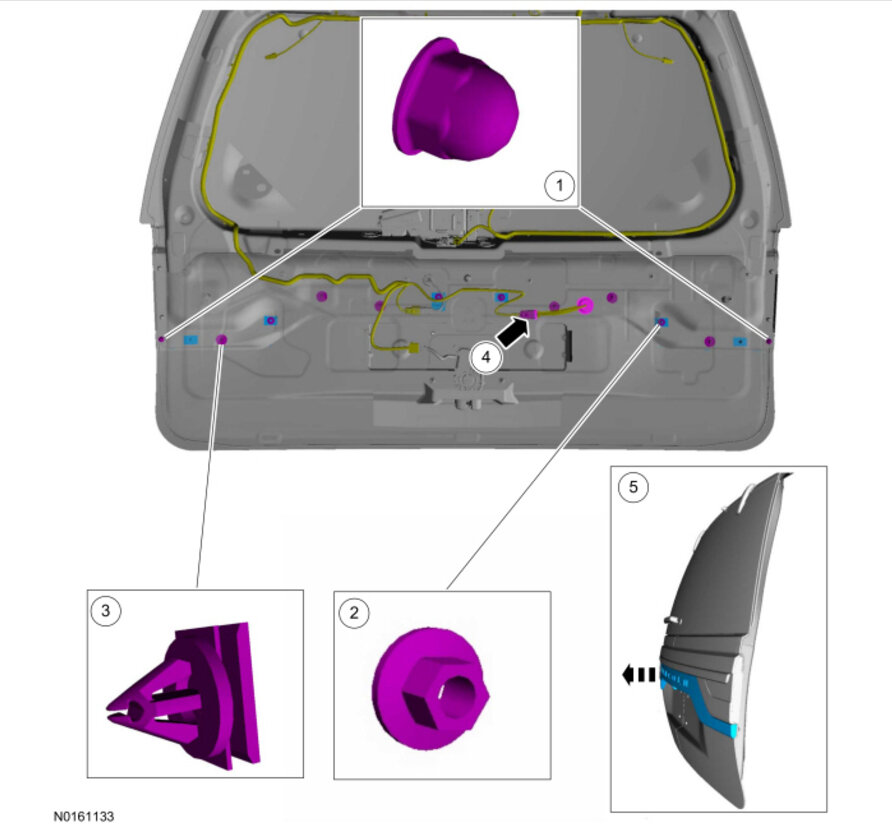

I have seen the camera cause this issue and the problem is common. I would get the camera from Ford, so it plugs right in, here is how to change it out. Check out the images (below). Let us know if you need anything else.
