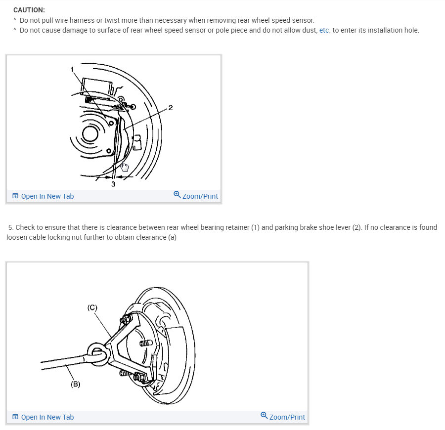

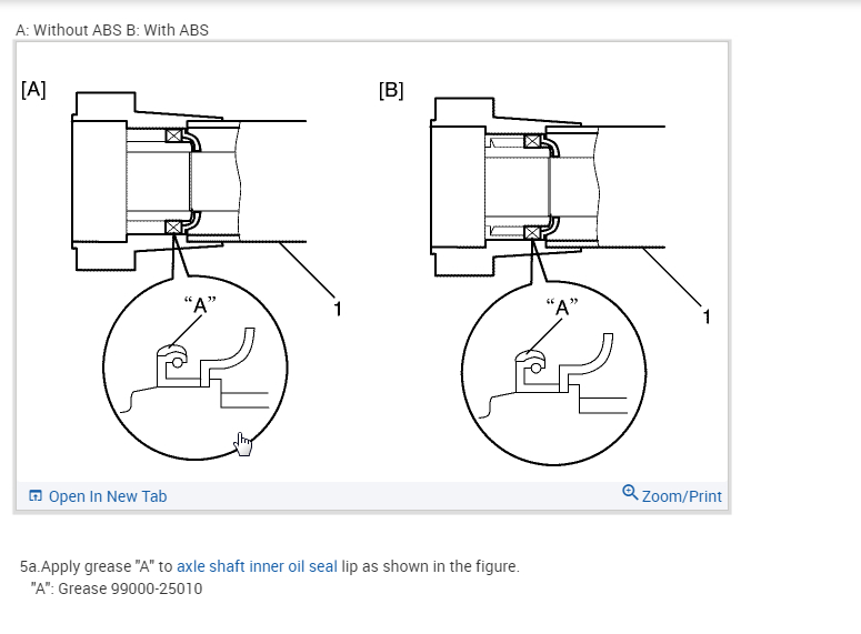

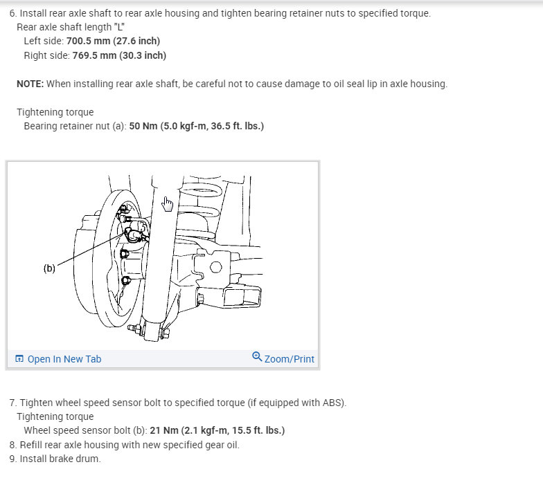

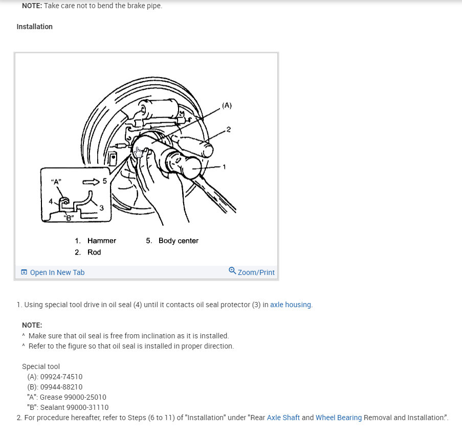

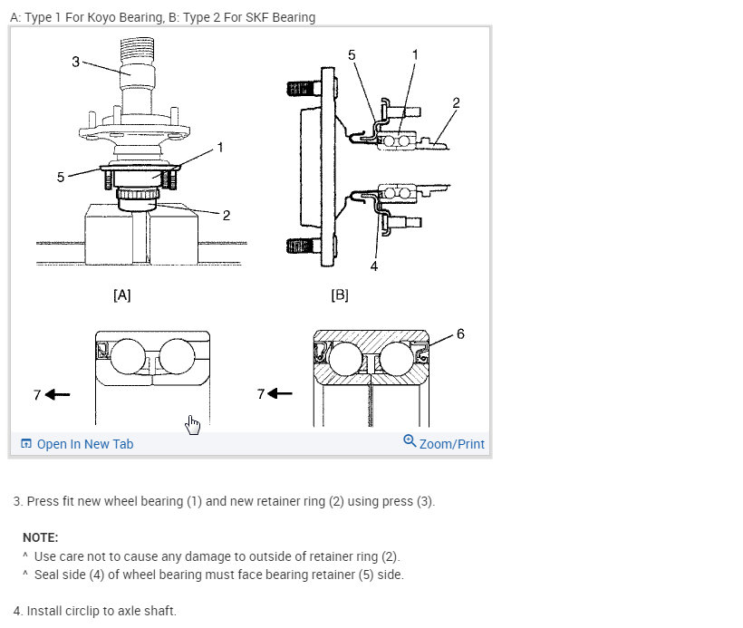

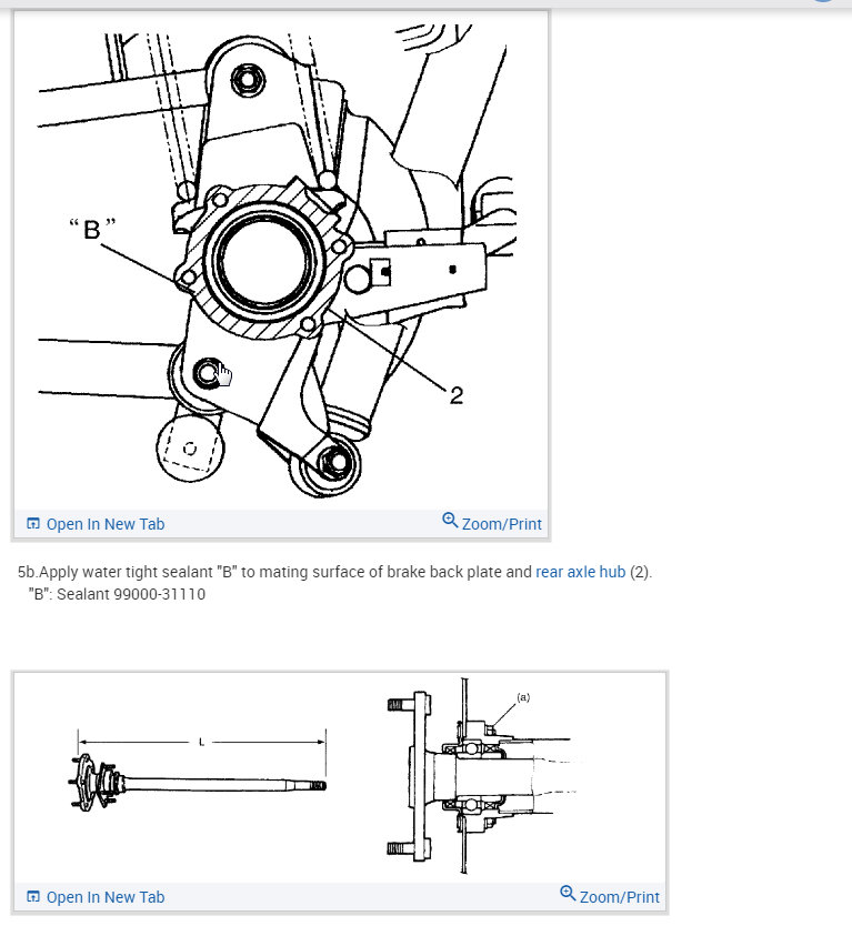

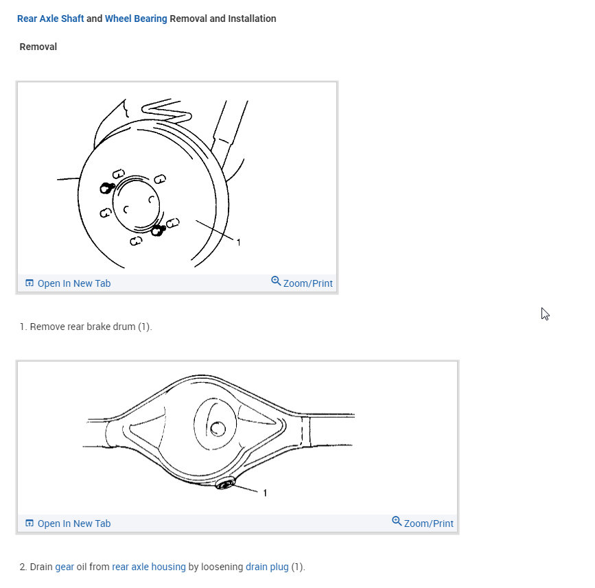

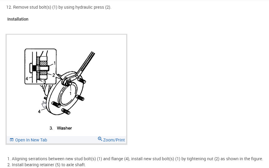

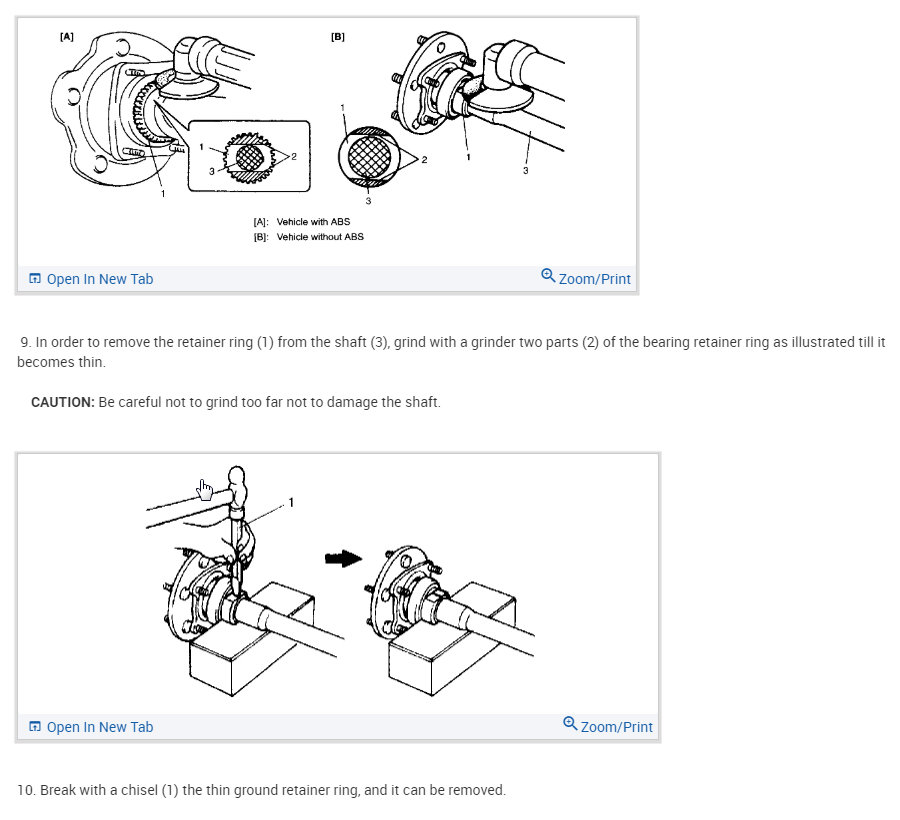

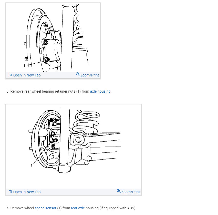

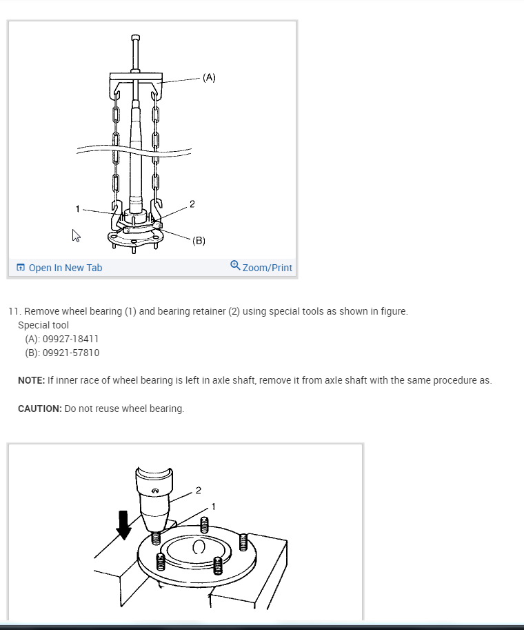

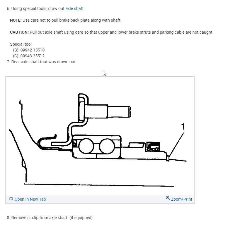

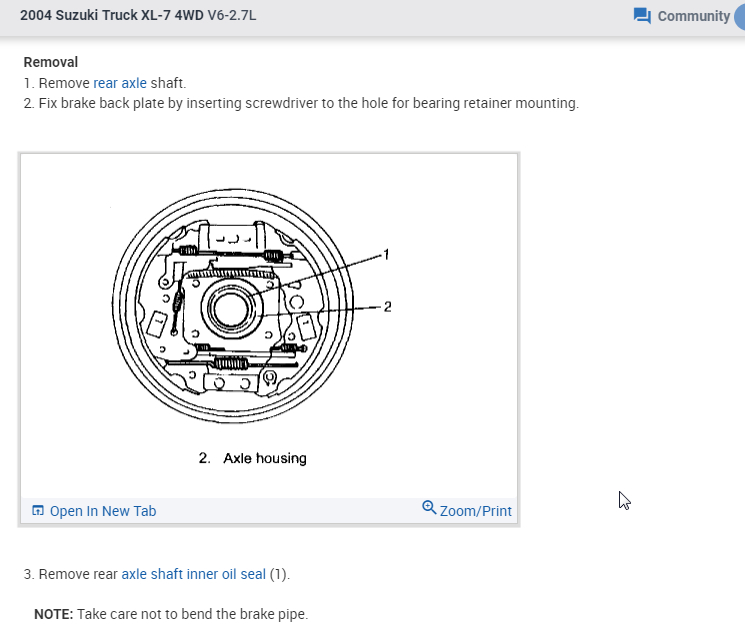

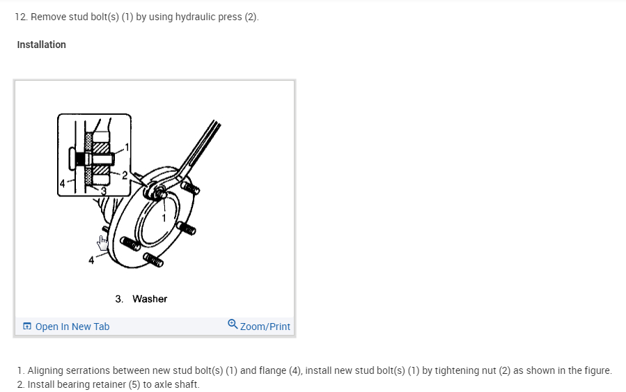

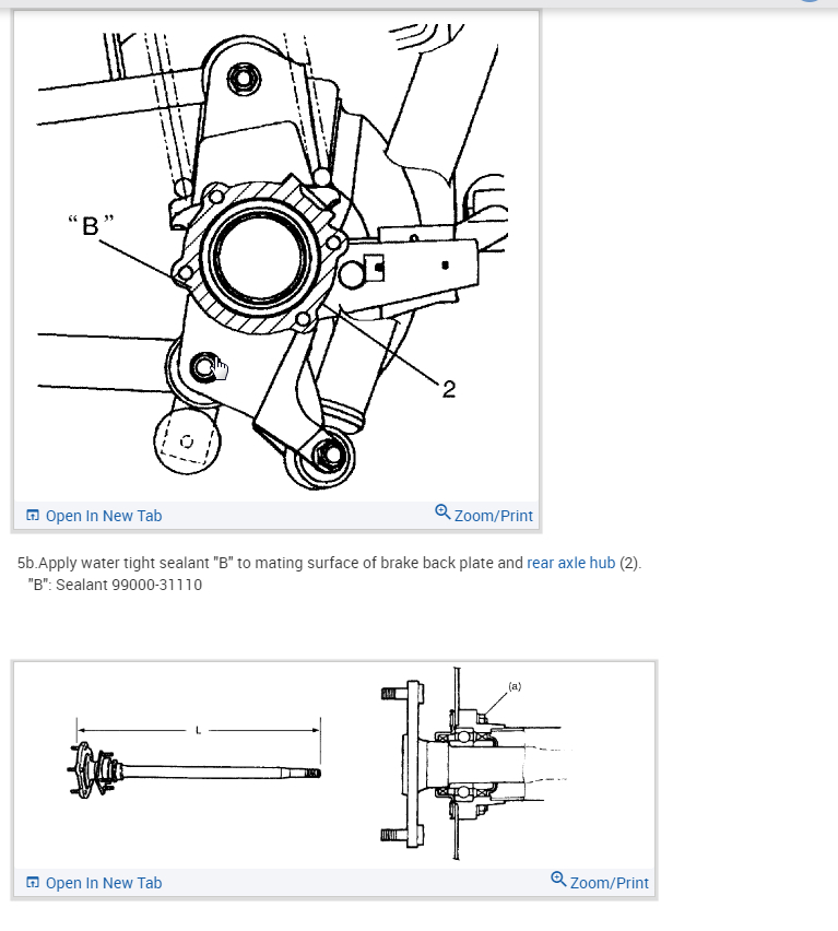

Okay, this the situation: i went and checked a customer's car out, i got in the passenger seat and noticed a sound when the rear wheel is slowly turning it didn't sound like the wheel bearing itself. so she parked it i jacked it up and took the rear drum cover off on the passenger side and noticed a lot of gear grease was coming from the middle area. in my head i am thinking the seal may just need to be replaced, at the same time i am thinking about changing the bearing too. i don't have access to any press equipment, but i am confident I can change the seal and see if that solves that problem. i just wanted some advice on removing the rear axle on this particular model because i was told i don't have to take the differential cover off just use a slide hammer. let me know what is the proper procedure. thanks
Aug 17, 2019 at 12:25 PM
Here is the procedure for removing this and installing it. Looks like you are correct for most of the procedures that you mentioned.
let me know if you have more questions. Thanks
