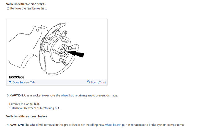

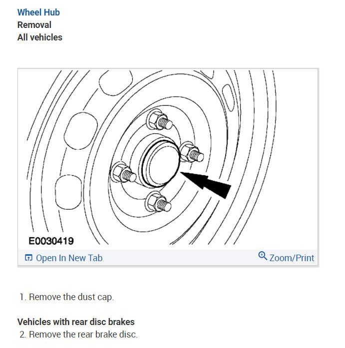

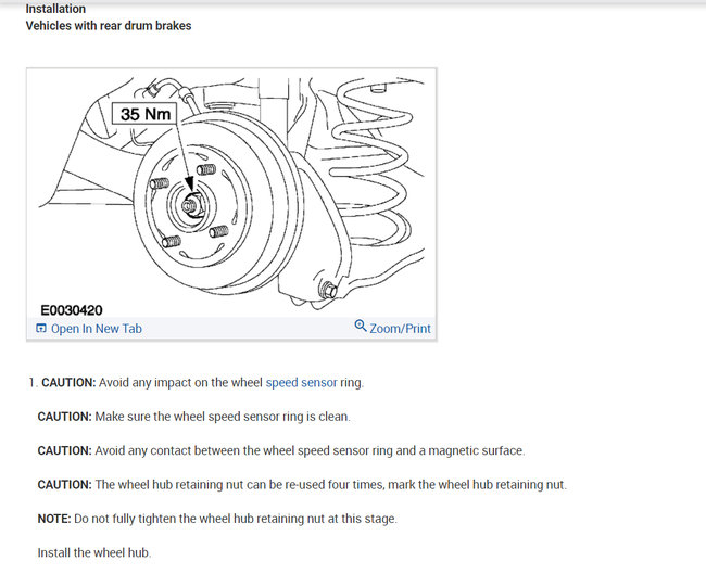

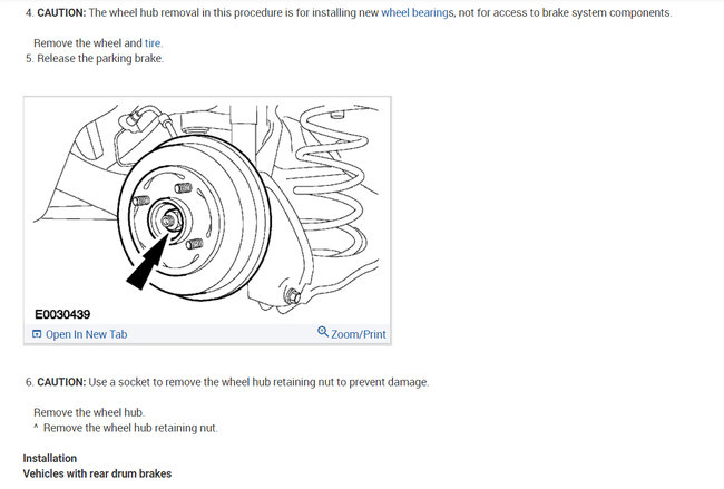

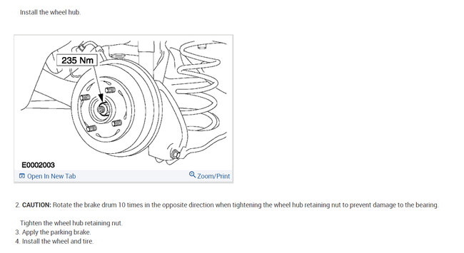

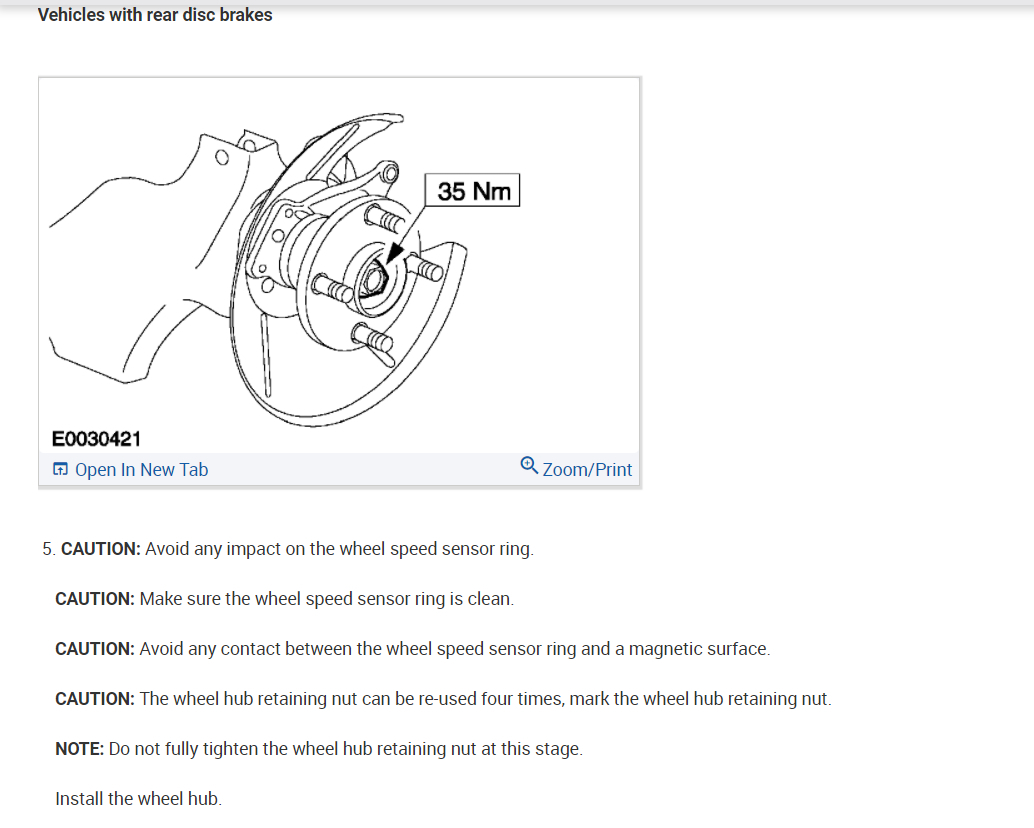

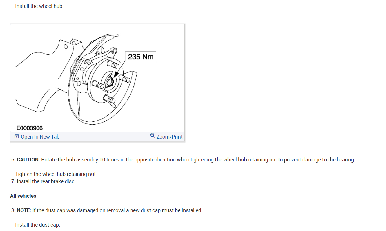

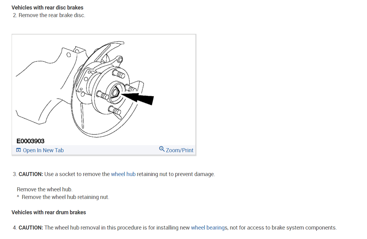

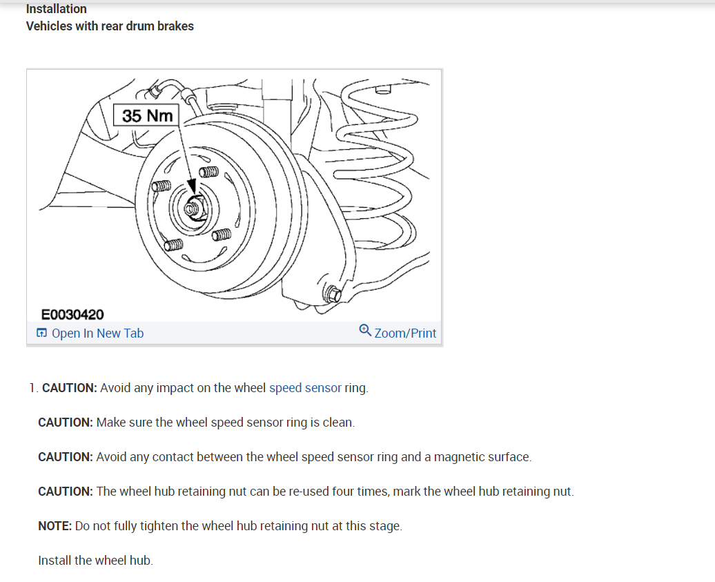

How to remove retainer on axle bolt and torque for this?
Sep 12, 2021 at 1:17 AM
Good morning,
I attached the procedure for replacing the rear hub assembly with the torque specs attached. You need a 30mm deep socket for the nut.
I attached both for disc brake models and the drum brakes procedure for you.
Let me know if you have any other questions.
