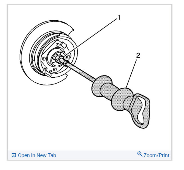

5. Using the J 44685 - remover (1) and the J 2619-01 - hammer (2), remove the rear axle shaft seal.
6. Using the J 45857 - remover (1) and the J 2619-01 - hammer (2), remove the rear axle shaft seal, bearing and the wheel speed sensor reluctor ring, if equipped.

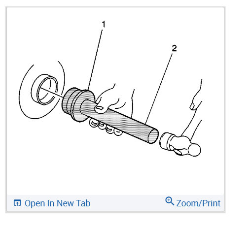

2. Using the J 23690 - installer (1) and the J 8092 - driver (2), install the axle shaft bearing.
3. Using the J 21128 - installer , install the axle shaft seal.
4. Drive the tool into the bore until the axle shaft seal bottoms flush with the tube.

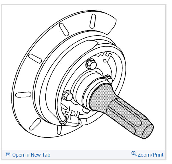

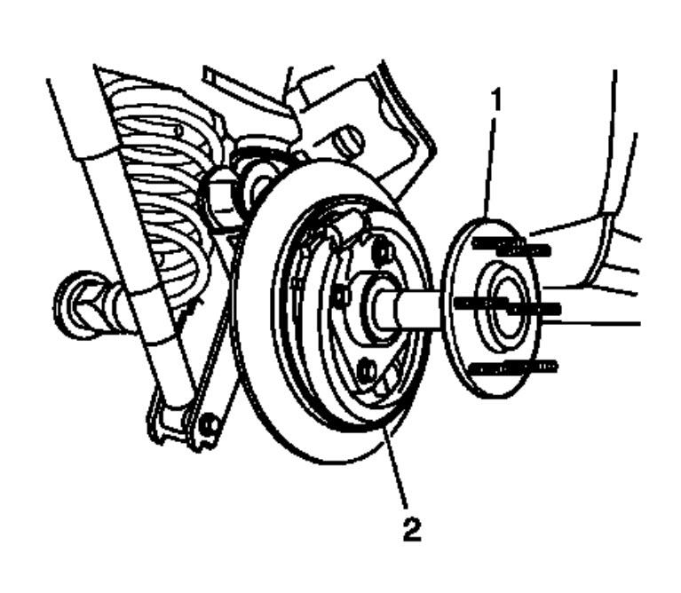

I am trying to replace a leaking rear axle seal on the passenger side. I have the pin and clip out of the differential but the axle wont slide out. Is there something else holding it in place?
Dec 2, 2019 at 3:52 PM (Merged)
HMAC300
  • 48,601 POSTS
I am assuming this is an 8.6 axle there are 4 different axles so instructions are for a n 8.6 make sure brake drum is off if drum brake and or caliper and caliper bracket as well as rotor. then it should come out. see pic
