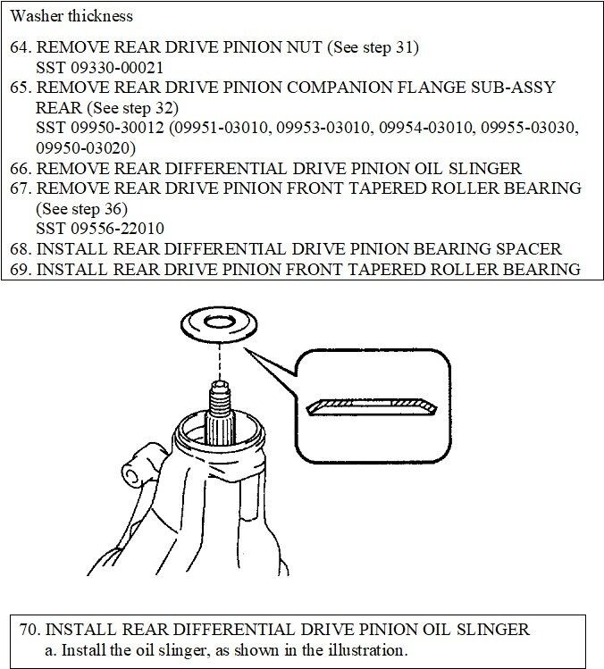

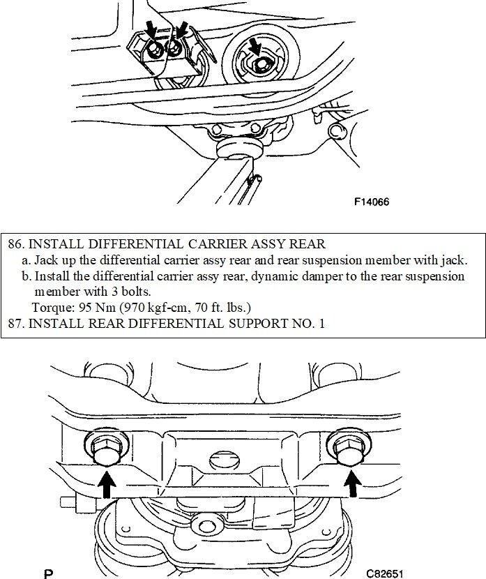

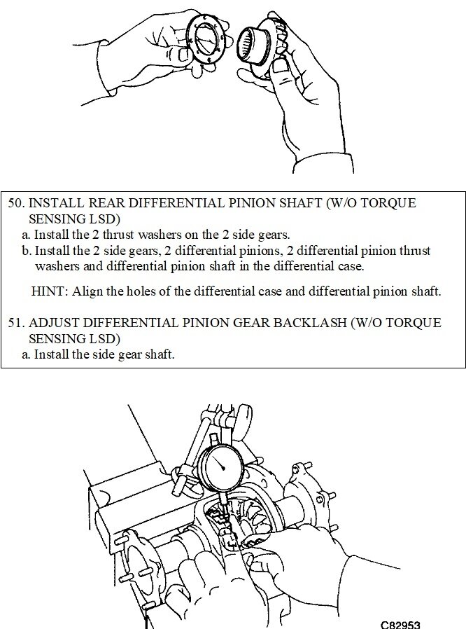

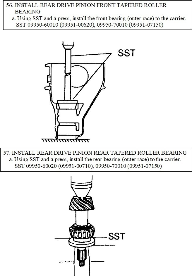

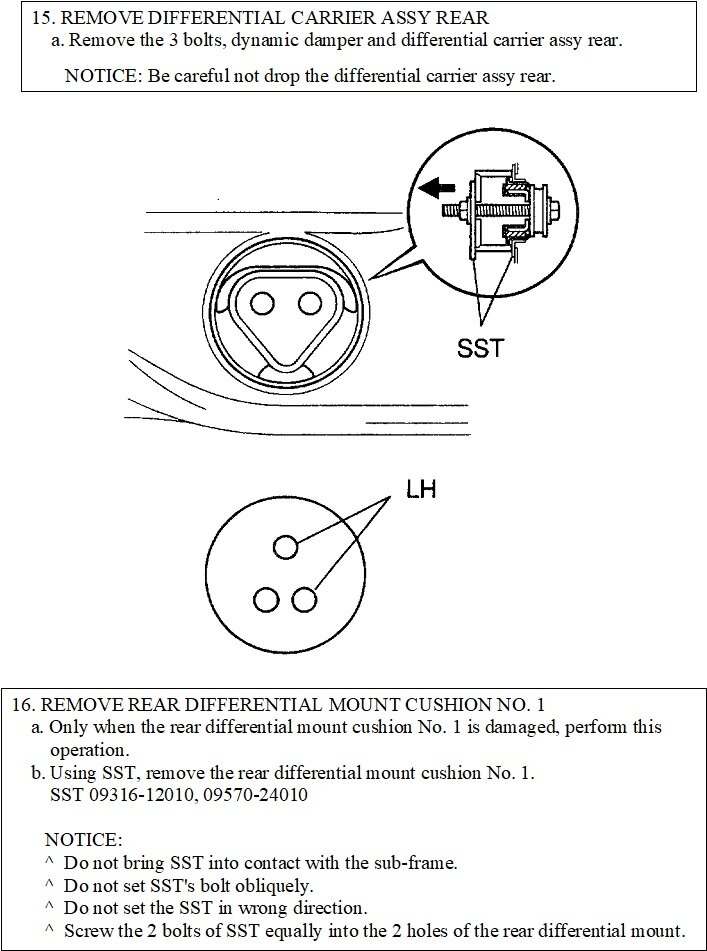

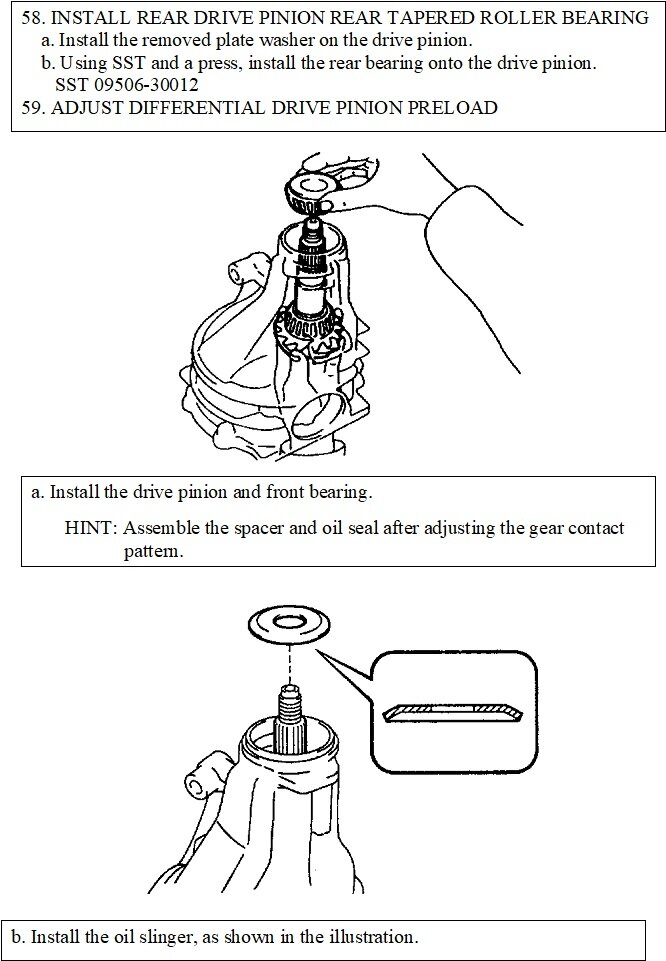

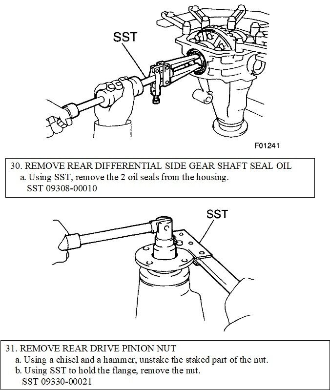

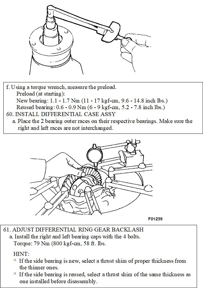

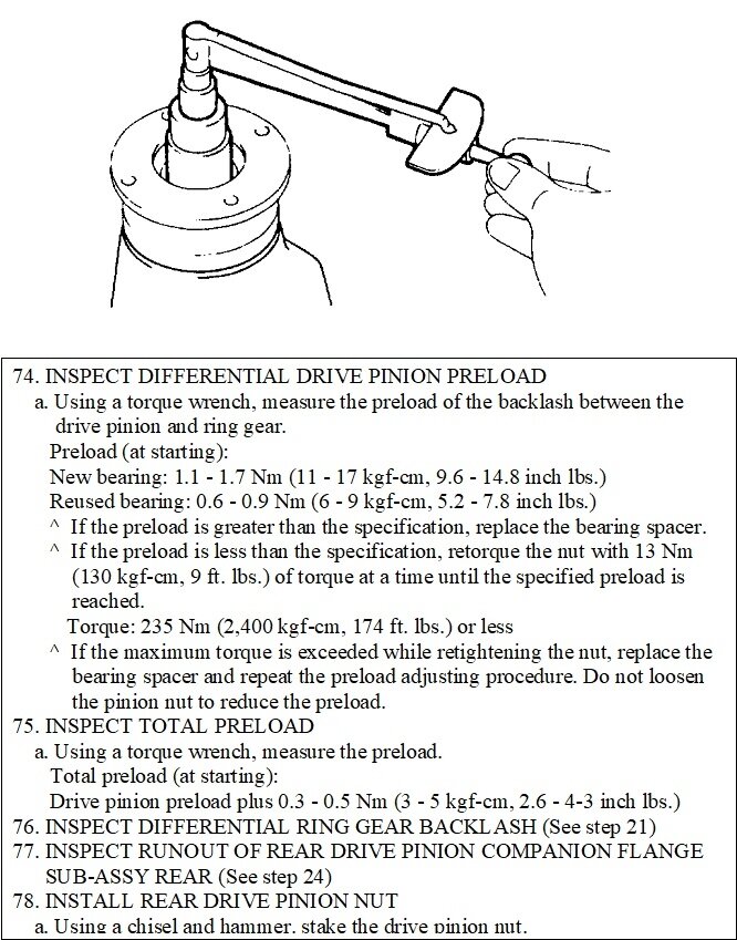

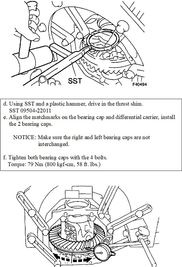

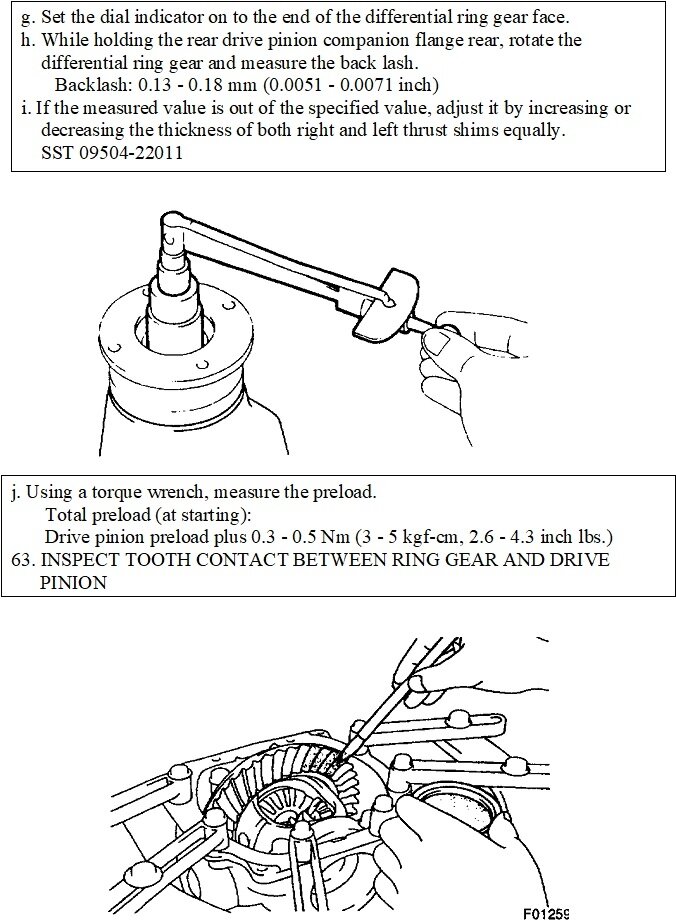

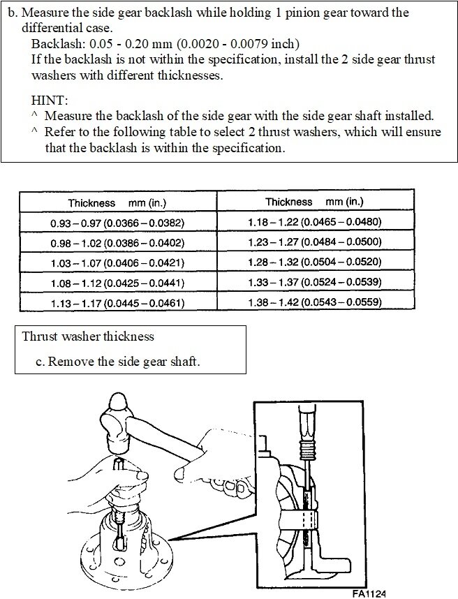

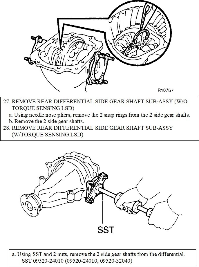

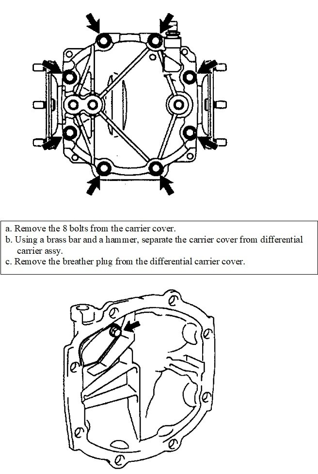

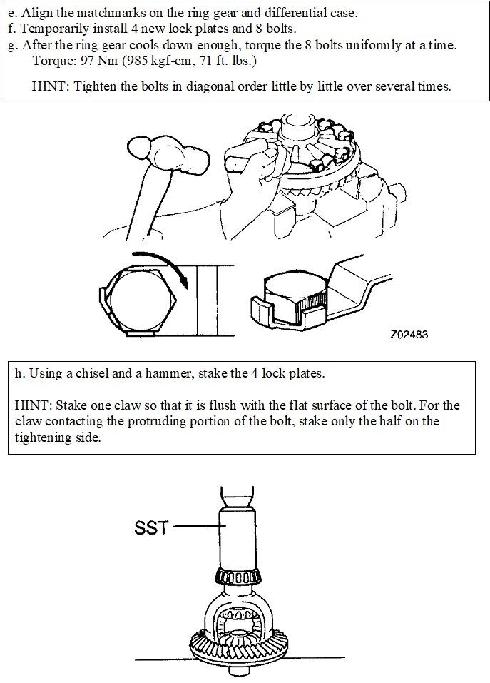

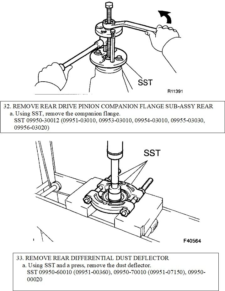

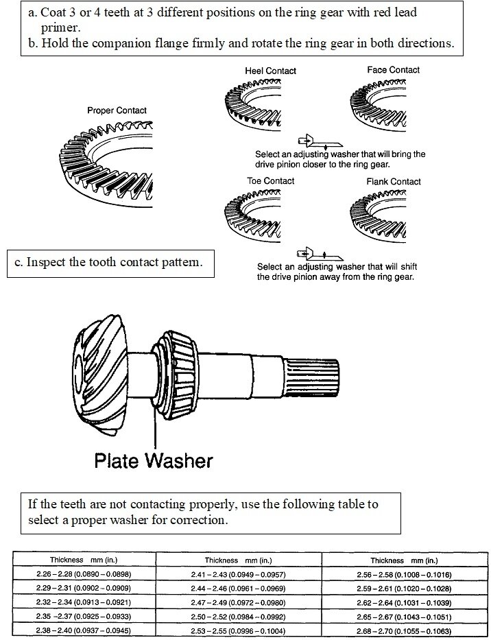

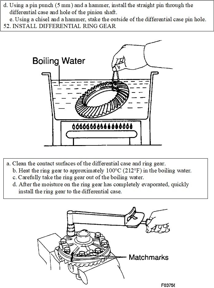

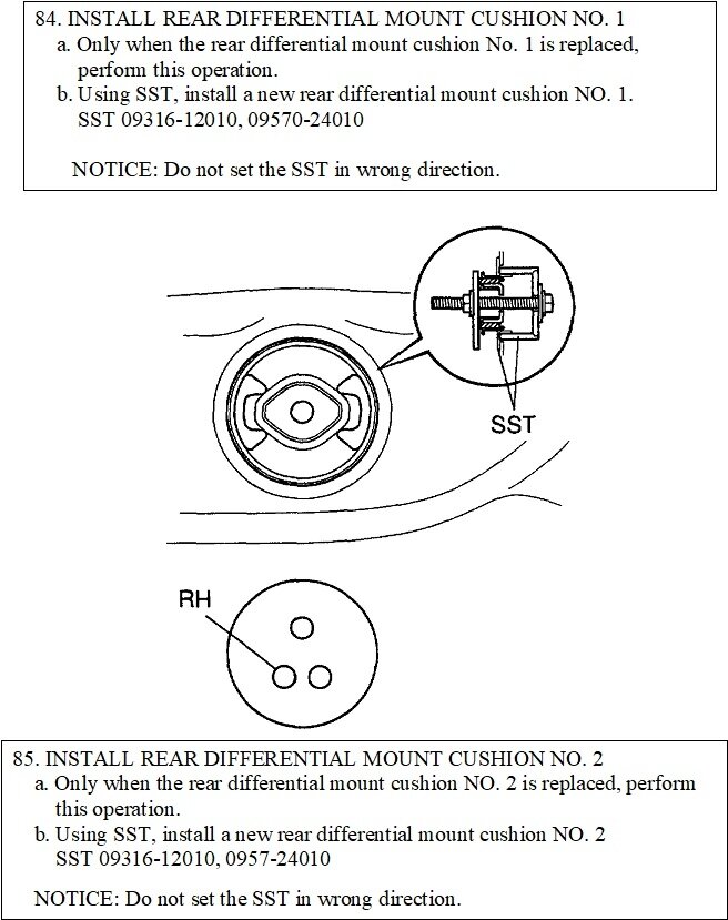

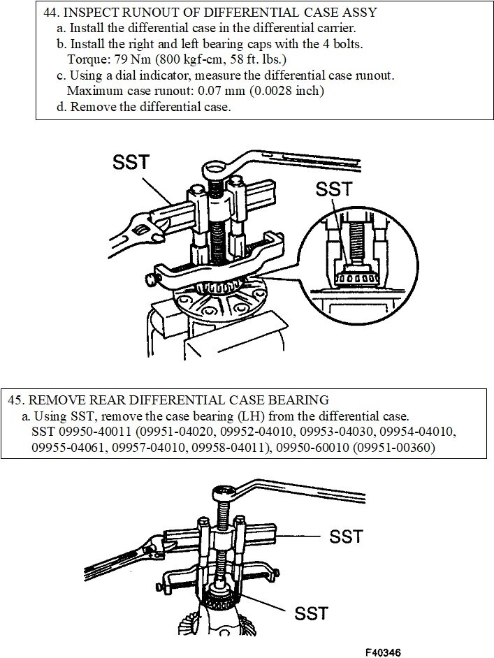

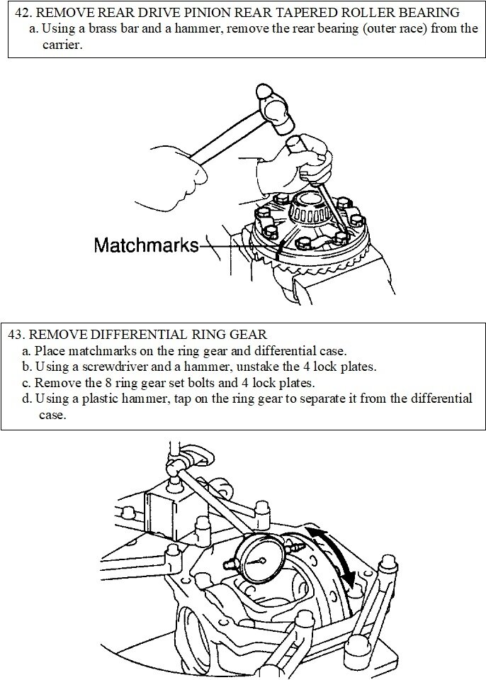

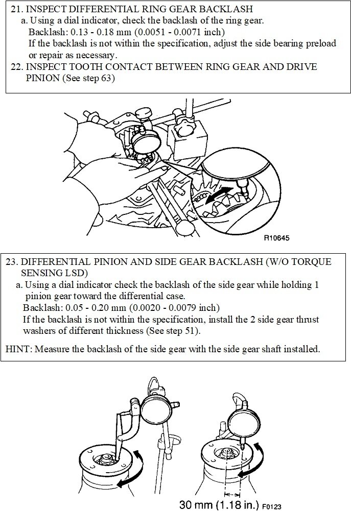

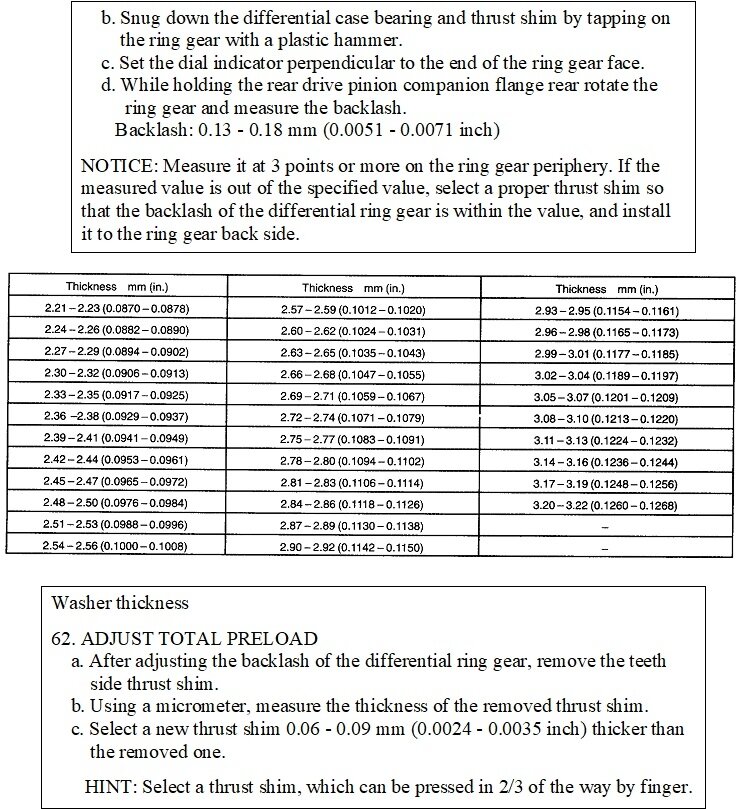

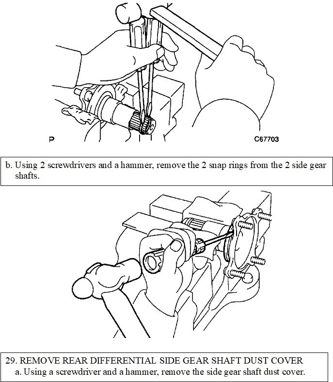

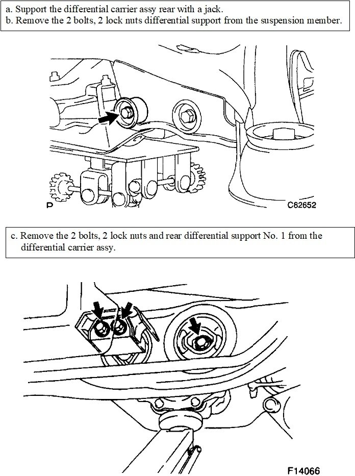

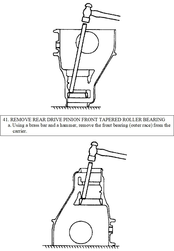

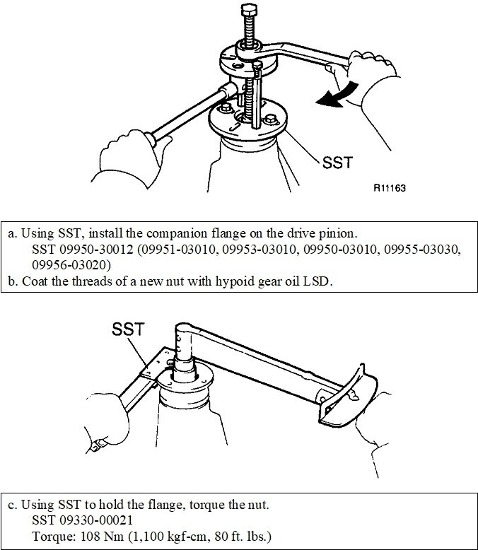

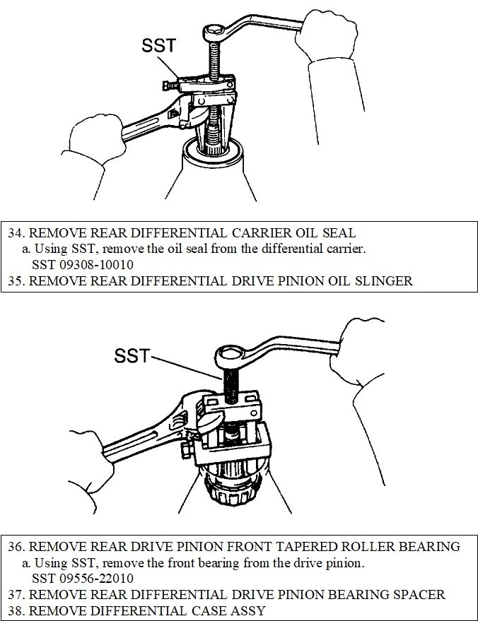

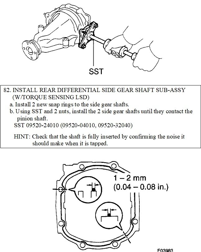

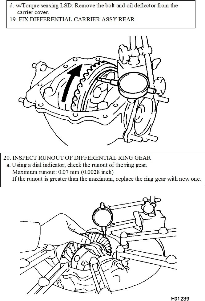

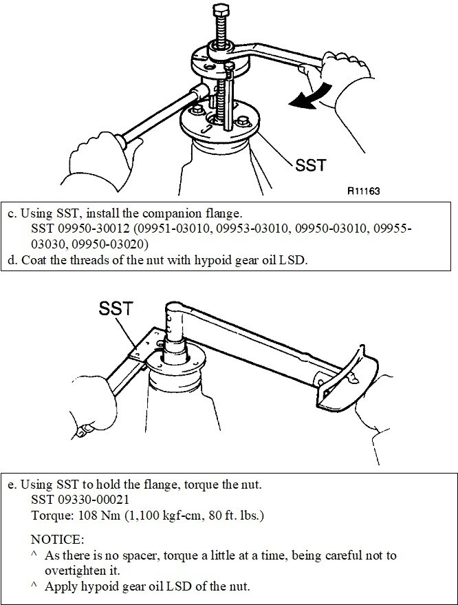

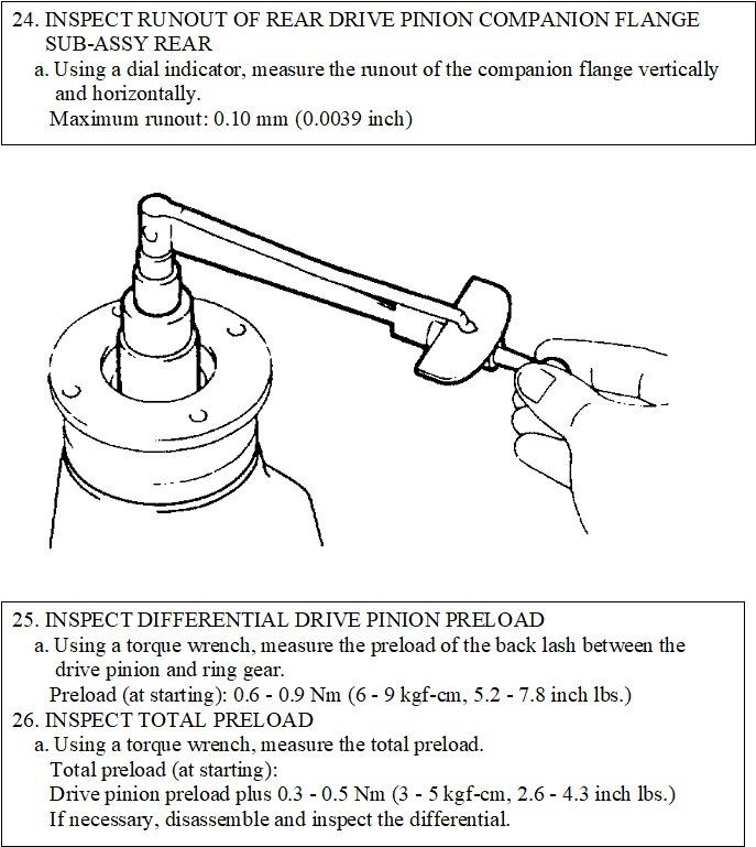

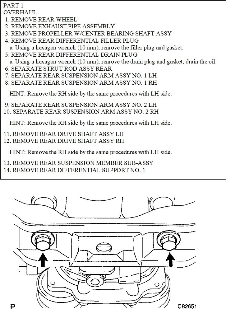

Congrats on getting started, but this is one repair you'll want to steer clear of. I'd be happy to post the instructions for replacing the bearing, but setting up the backlash and pinion depth is an extremely tedious job that requires precision and patience to prevent gear noise and premature gear wear. The people at most independent shops won't attempt this job, and dealer's service departments typically have only one or two people qualified to do it. I replaced the bearings on one rear axle while at the dealership. It took over a day to get it right, and I had to borrow special tools from a couple of the other mechanics.
A better suggestion is to find a low-mileage entire axle assembly from a salvage yard. Failures aren't common, so they don't get a lot of chances to sell a complete axle. That means you can often finagle a lower price. Also look for one of the "pick-your-own-parts" yards. Do a search for "Pull-A-Part", for example, and see if they have a yard new you. I've been to 16 of their yards. Prices are very low and employees and other customers have always been very friendly. All of their yards are very clean and well-organized too. You toss your toolbox in one of their wheelbarrows and you can spend all day there if you want to. Similar yards are popping up all over, but I'm not familiar with their names or locations.

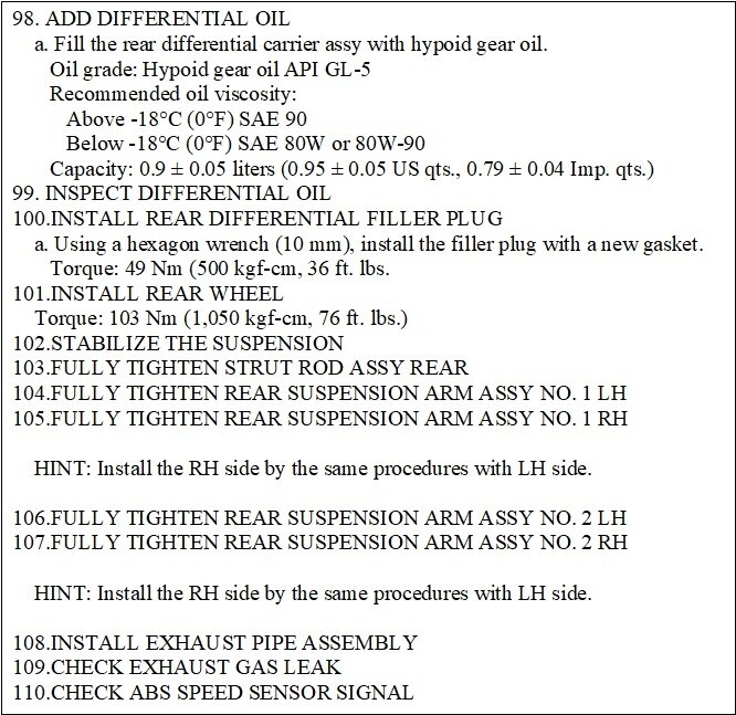

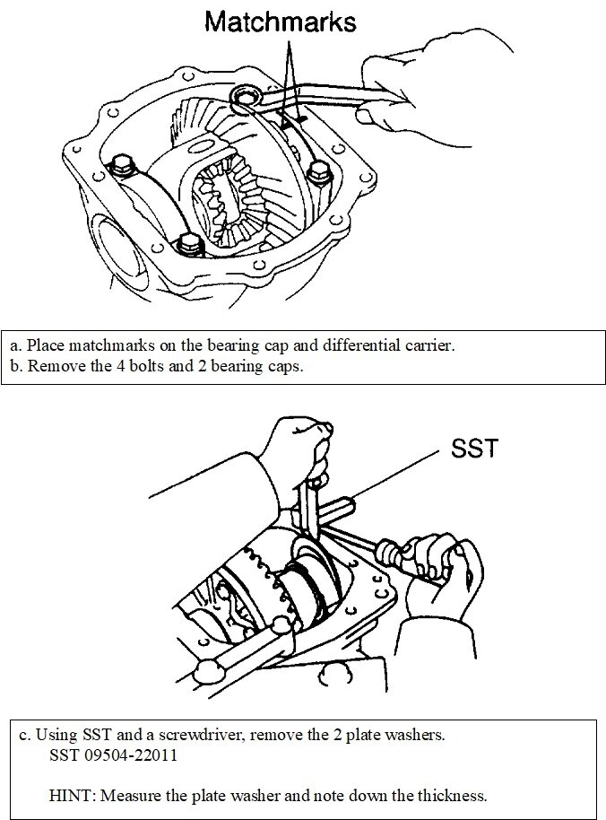

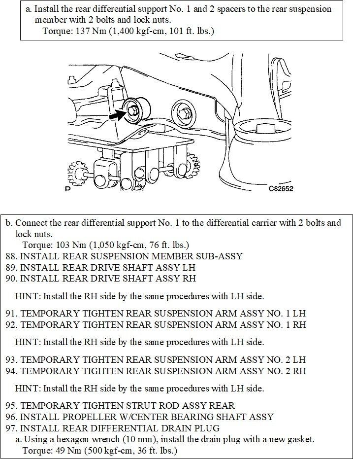

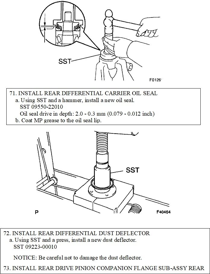

Here's Part 1 of the overhaul instructions. From the little of it I read, it appears they haven't even reached the pinion gear and bearings yet, but this will give you an idea of what is involved.
Jul 16, 2024 at 5:36 AM

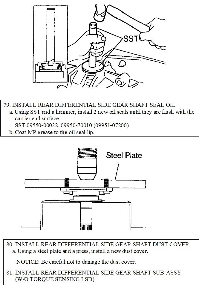

CARADIODOC
  • 34,413 POSTS

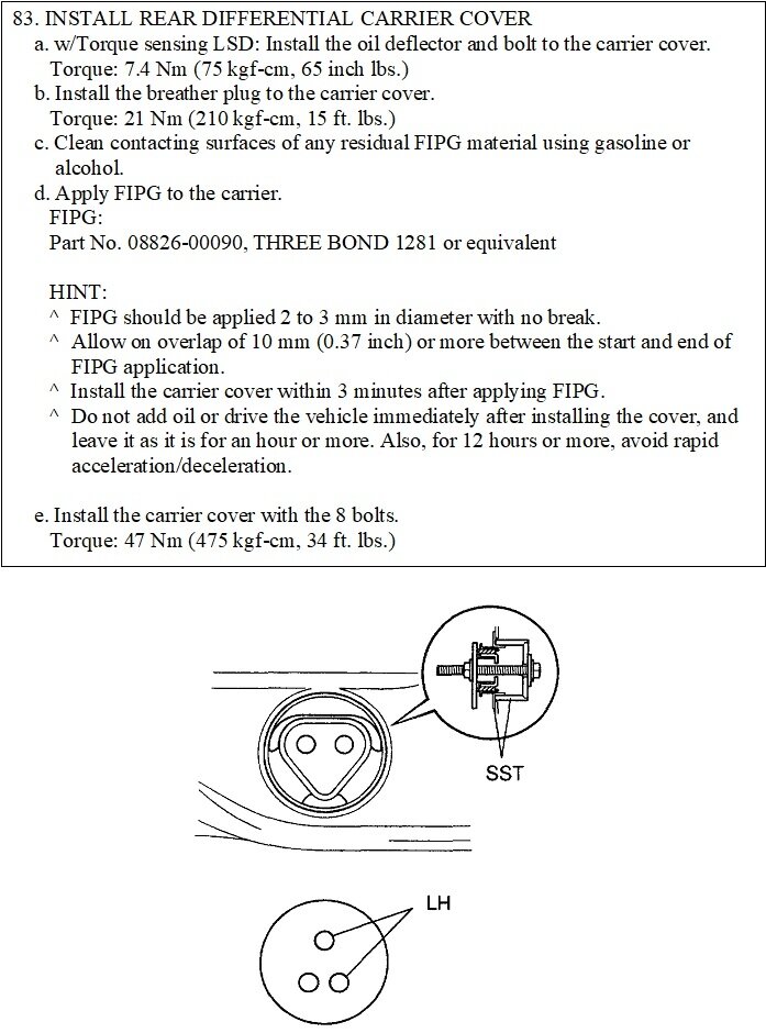

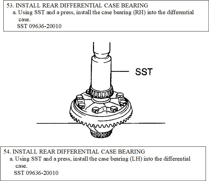

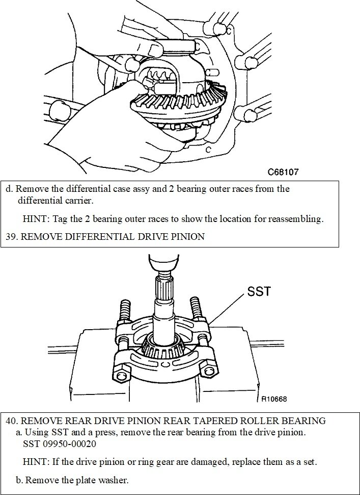

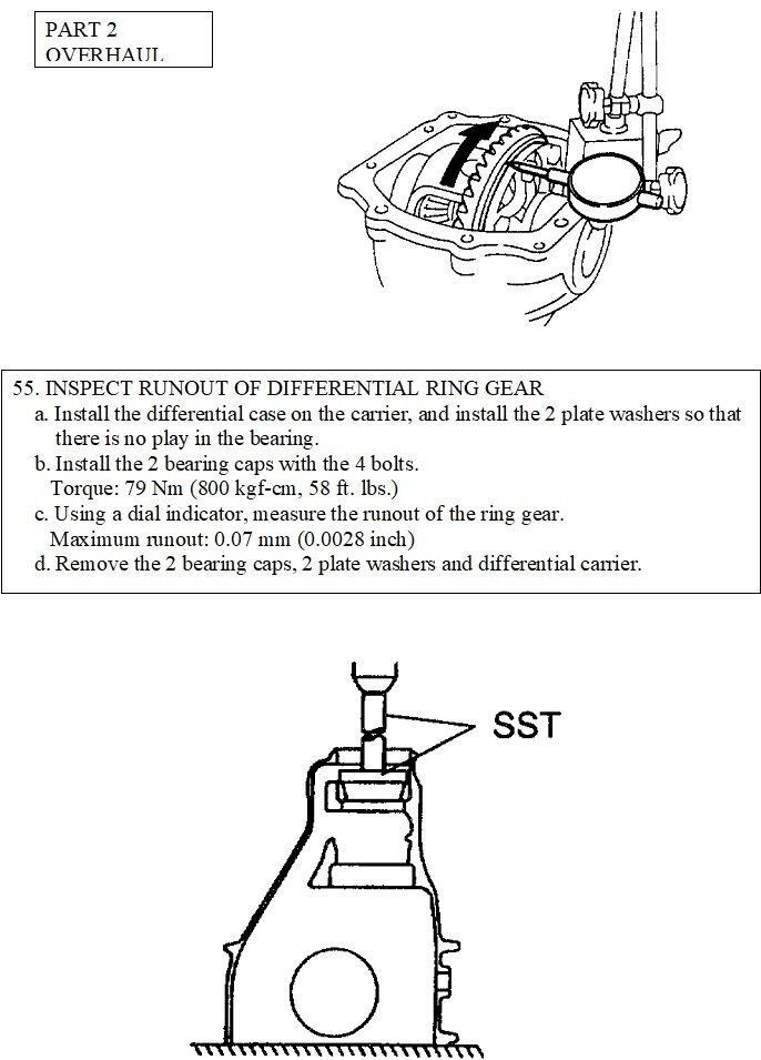

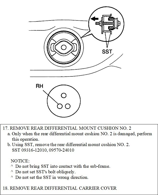

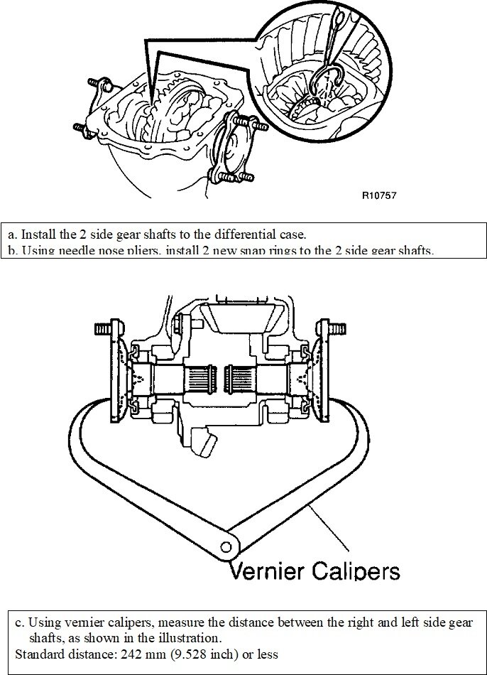

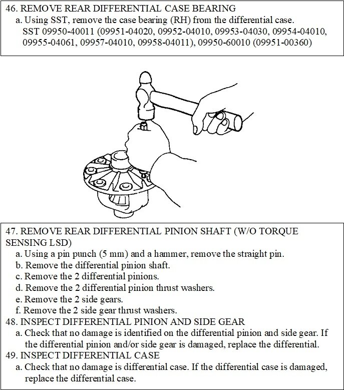

Here's Part 2 of the procedure.
