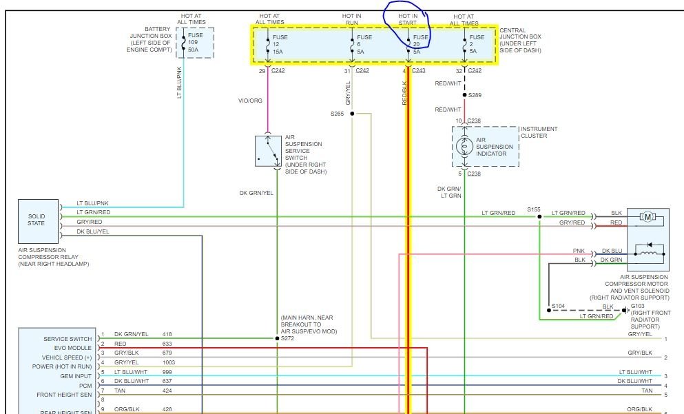

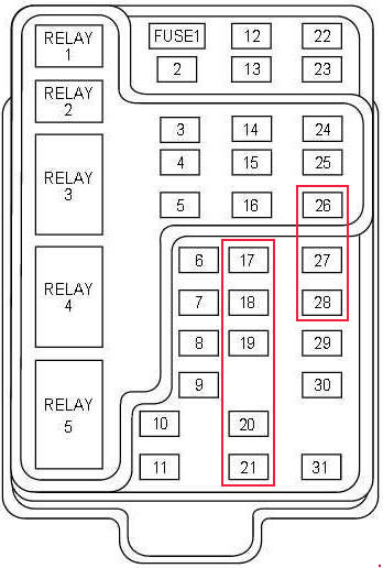

Rear air suspension height leveling switch getting no power. I have checked for power at the connector and found none. I have checked all fuses and have found a few that do not indicate power until you turn on the device (like the head lights). One of these fuses is #20. When the compressor does come on, I do hear the solenoids on the air bag activate but the truck does not raise. If the solenoids are activating, I would think the power must be being applied to the switch once the compressor kicks on which sounds backwards to me. I am sending a picture of the fuses that are not showing power until they are activated. All this is very confusing. Hope you can help. Wayne
Apr 8, 2020 at 4:29 PM
Good morning again,
As we discussed in your first post about this, these fuses power up when systems come on line.
A lot of manufacturers put fuses in the feed lines to a component after they are commanded on. There is nothing wrong with that and that is why you have no power until components are turned on.
I attached the diagram of fuse 20. It is only hot in the start position only.
Apr 8, 2020 at 9:15 PM

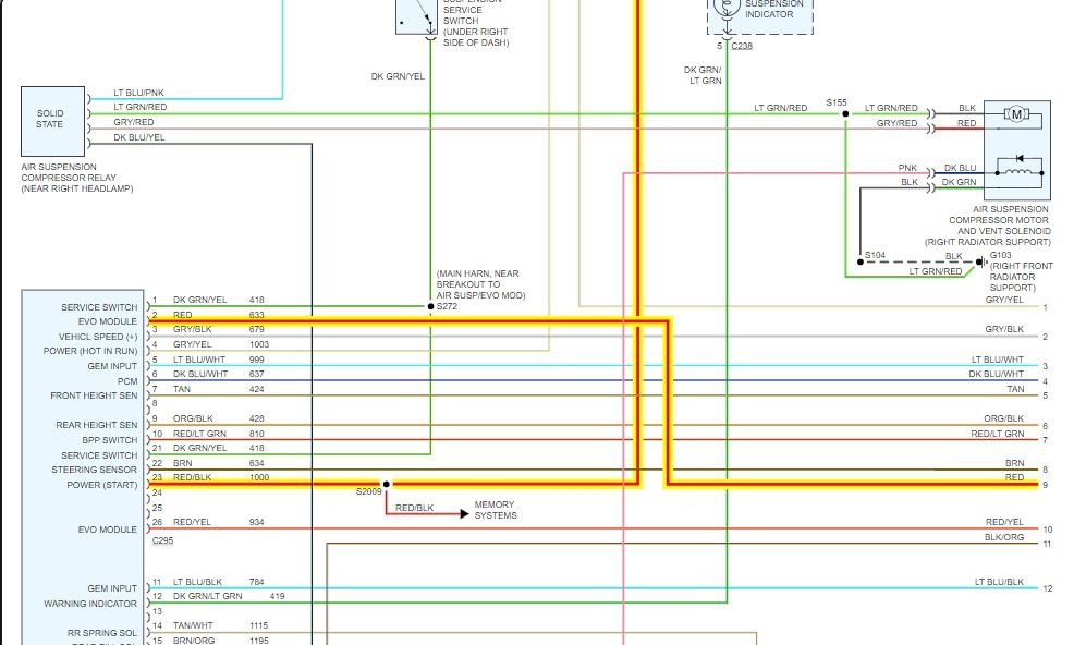

Good Morning.
I am trying to understand the fuse #20 function in respect to giving power to the suspension system. If it is only supplied with power in the start position and not the "on" position, does that mean that it is only supplying power when the engine is running? I haven't checked for that as it would fill the shop with fumes. But I will. Thanks.
Apr 8, 2020 at 11:23 PM
No, power is only supplied in start position. There will be no power shown in the on position of the key.
