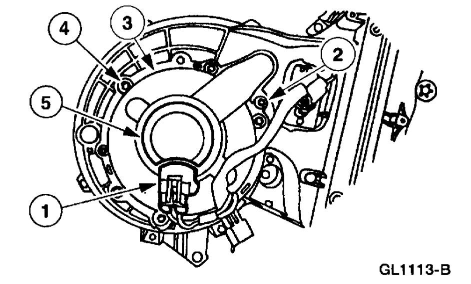

REMOVAL
1. Remove the LH quarter trim panel access cover.
imageZoom/Print
2. Remove the blower motor.
1 Disconnect the electrical connector.
2 Remove the three motor cover bolts.
3 Remove the blower motor cover.
4 Remove the blower motor bolts.
5 Remove the blower motor.

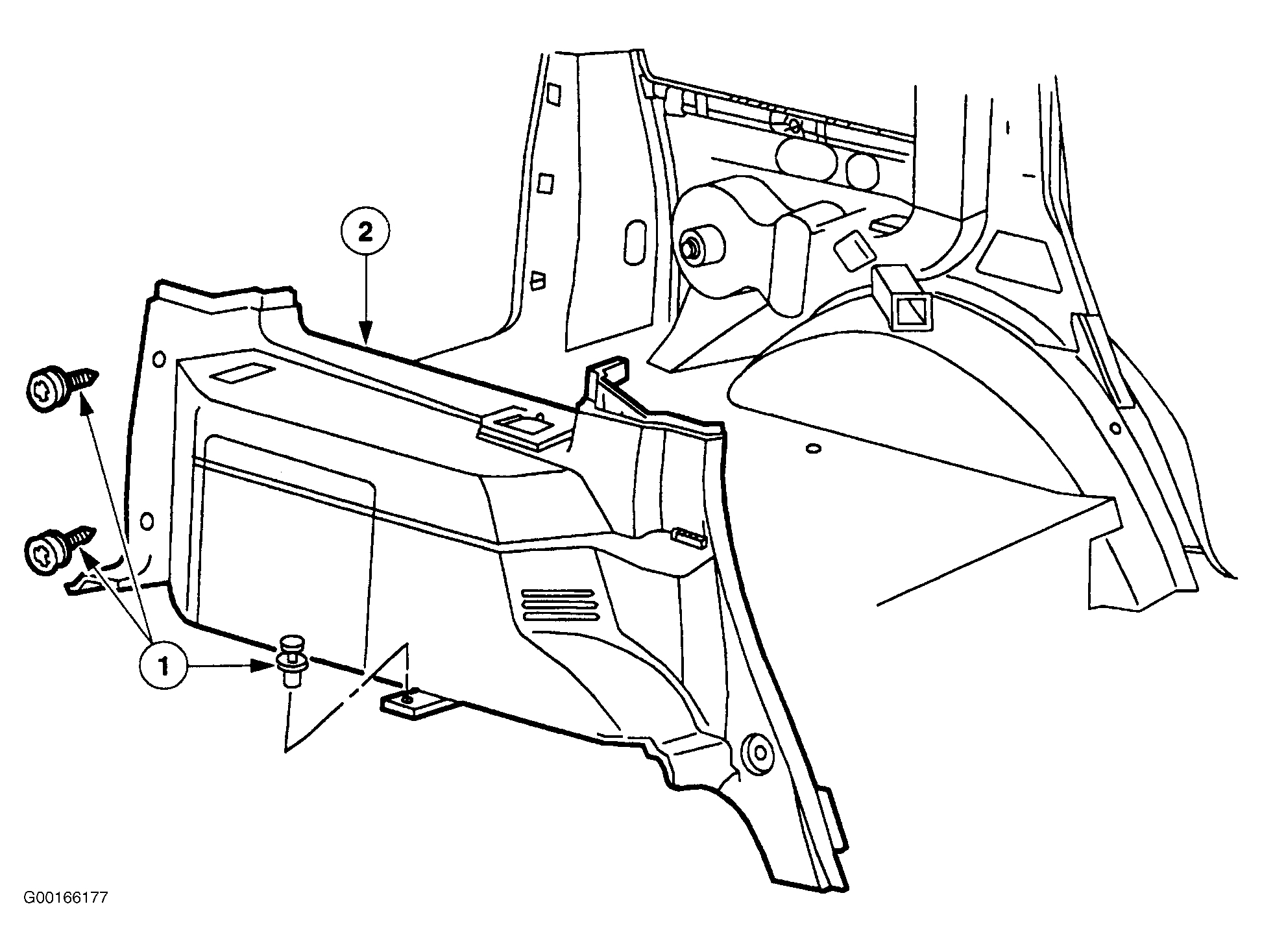

Thanks Steve and Asemaster6371 for the help. Last week I took my SUV to a well known and very respected car shop in Phoenix. After about an hour they told me the blower motor was no longer available and if it was it would be under the front console. When I came home and queried the internet it showed I could purchase the blower motor for the 1998 at multiple auto part stores. Now I think this is something I can do myself. Is there or can you provide instructions to remove the left side trim panel? Any link or you tube available that you know of showing how to remove the trim panel?

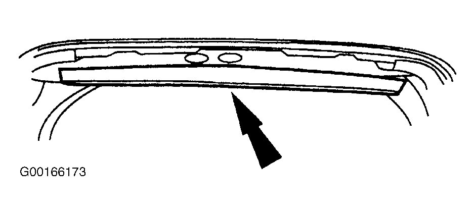

I show the front blower motor and the rear motor available. The one in the console is not listed as available. That is at a few different suppliers.
Remove the liftgate door opening weather seal.
Remove the liftgate scuff plate from bottom of rear liftgate opening.
If equipped, remove the third row seat.
Remove the rear header garnish trim panel. (pic 1)

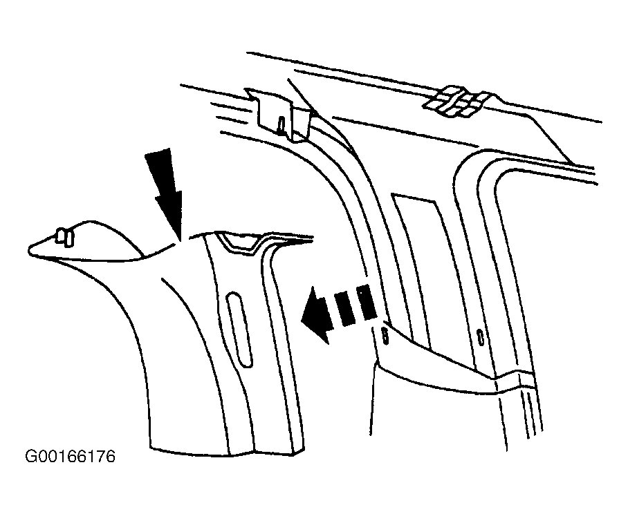

Remove rear door scuff plates. (pic 2)
Fold down the second row seat.

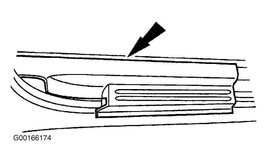

Remove the cross car scuff plate. (pic 3)
Lift trim covers off of second row safety belt anchors on B pillars.
Remove Anchor nuts. If equipped, repeat for third row safety belts.
Remove second row safety belt lower nuts.
Remove the rear door opening weather seal.

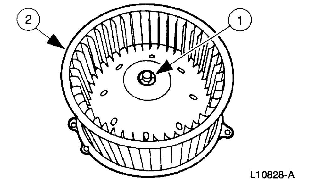

Remove the C pillar upper trim panel. (pic 4)
NOTE: Remove the lower hook attached to quarter trim panel, followed by the top attachment, and then the lower rear attachment.

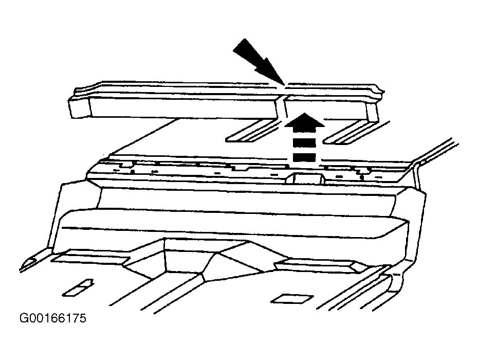

Remove the D pillar trim panel. Remove the liftgate door opening weather seal.
Remove 2 screws and one pushpin. Remove the quarter trim panel. (pic 5)
To install, reverse removal procedure.
