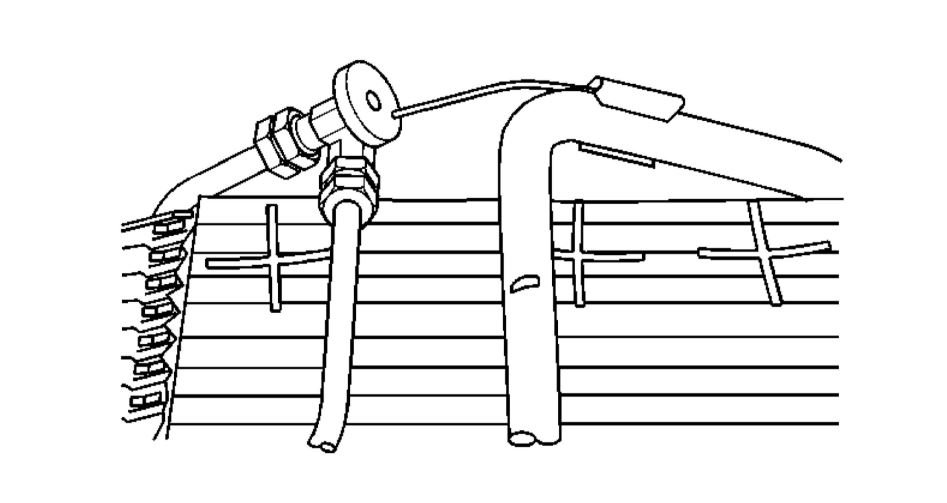

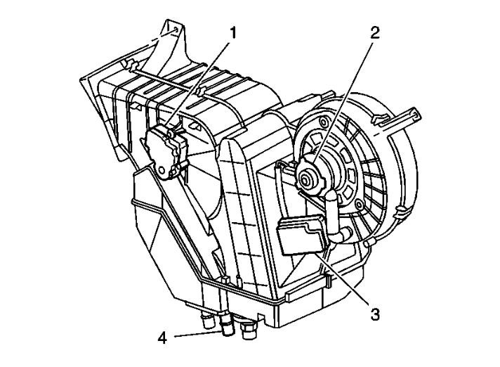

Front A/C blows cold, rear blows hot air.
Tuesday, July 30th, 2019 AT 10:21 AM
MECHANIC
52,797 POSTS
Good afternoon.
Do you have the pressures for me to see?
It could be either a bad expansion valve or a blend door motor.
Both are at the rear of the van under the plastic trim in the left rear of the van.
