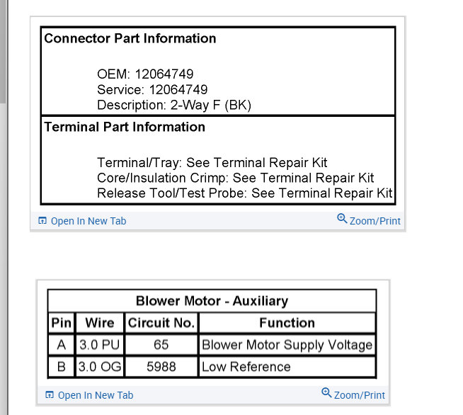

Rear air and heater are not blowing anything. Front works fine.
Aug 10, 2019 at 2:00 PM
More than likely this is a blower motor issue, so I am attaching the info that you will need to help figure this out.
Here is a guide that will help with this type of info:
https://www.2carpros.com/articles/low-or-no-air-flow-from-vents

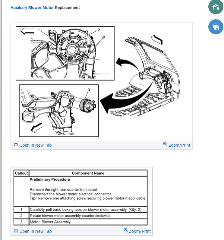

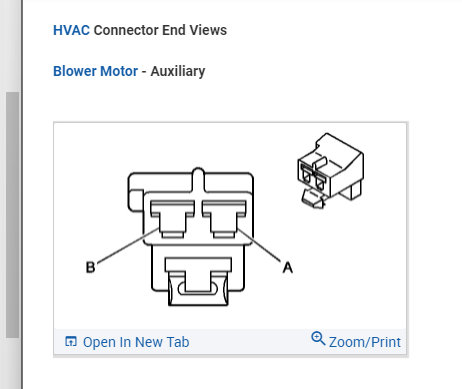

I suspect you will have to replace the blower if you have power back at the connector. So I am attaching the info to be able to test for voltage at the blower.
If you have voltage, then I attached the instruction on how to replace the motor.
Please run through this and let us know what you find with this.
