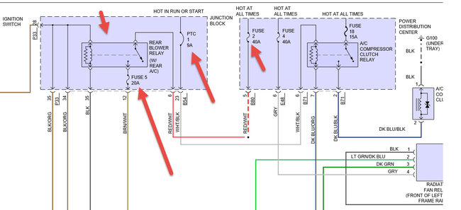

The rear air conditioner/heater does not work at all. Please help!

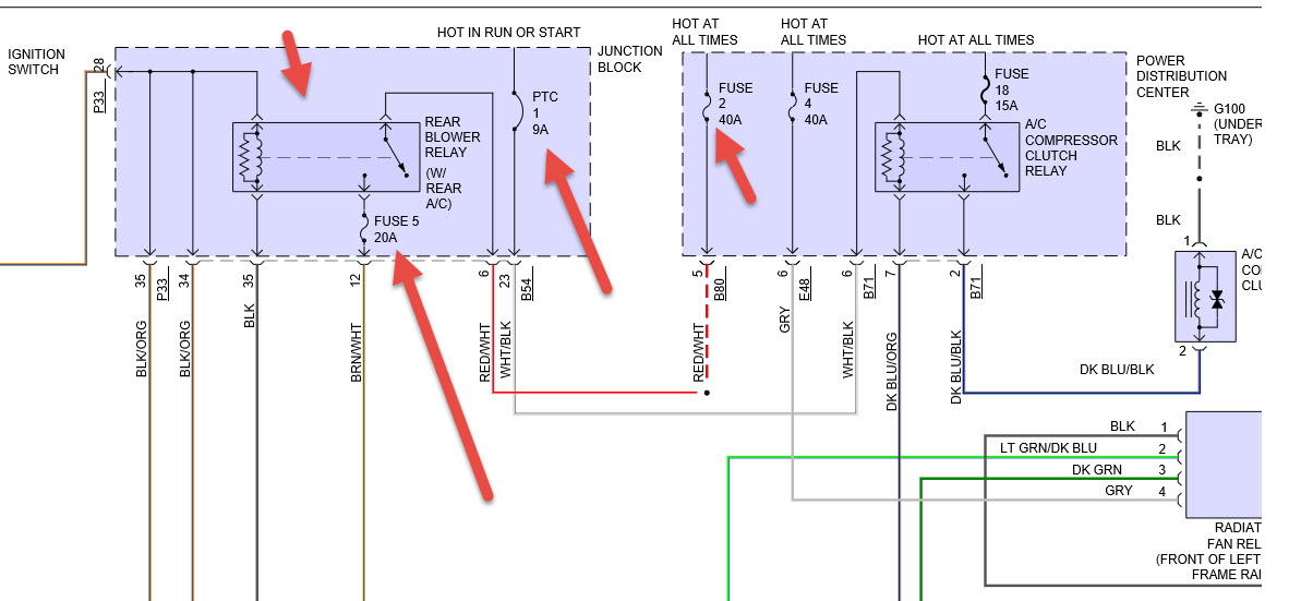

Check fuses, circuit breaker and relay in picture these are power supply for rear blower motor. If rear motor does not get power or blows the fuse disconnect blower and see if it does it if not the motor is bad.

BETH YANDELL-JOHNSTON
Picture? Is there a separate blower for the rear?

HMAC300
  • 48,601 POSTS
Oops sorry and yes there is a separate blower for the rear. The rear blower motor is on right side behind trim panel behind back seat. No picture available.
