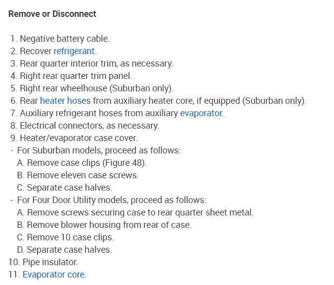

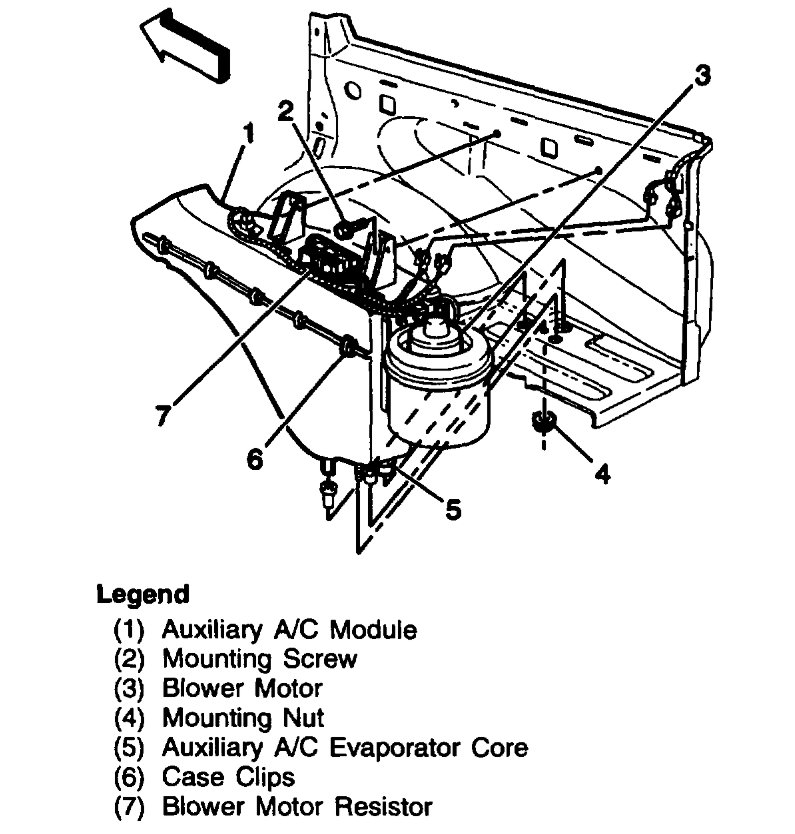

My rear AC/heater quit working in the rear. I have to hit the side panel where the blower is to get it to work again. I have to do this basically every time i start the vehicle.
Aug 6, 2019 at 9:38 AM
  • 55,770 POSTS
This is common when the blower motor goes out. To be sure here is a guide that will help you test it and the blower motor replacement instructions in the diagrams below:
https://www.2carpros.com/articles/blower-fan-motor-works-on-high-speed-only

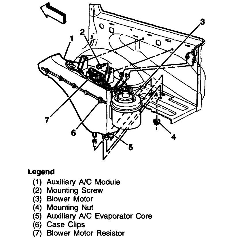

  • 55,770 POSTS
